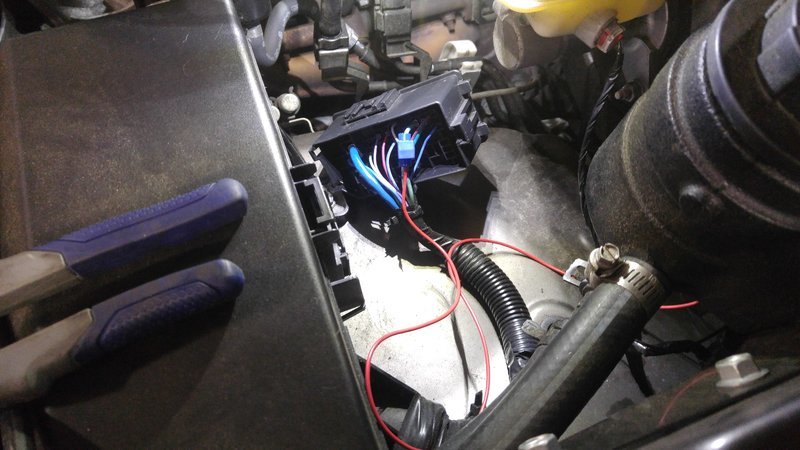

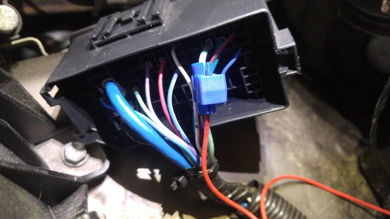

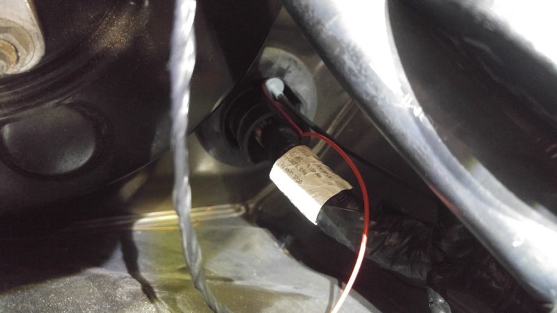

    That's exactly what i did. Un-clipped from the main fuse box. Pried the bottom off. tapped into wire. Ran new wire through harness and through rubber boot on firewall. And attached to switch. Nice clean professional looking job.
    I'm still amazed that you could look at this and figure it out like you did. I am simply amazed. Thanks again. Now my switch works 100% the way it should. All because of you Leftcoast....(you are an electrical genius!!!)

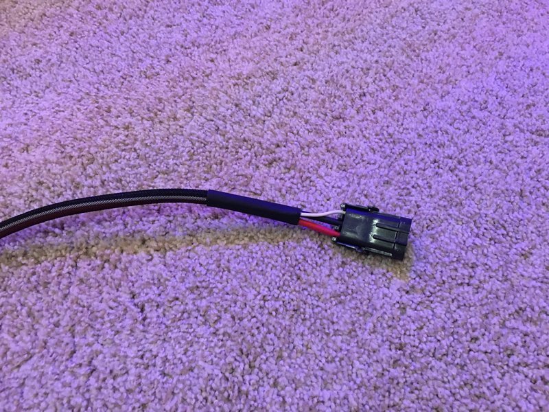

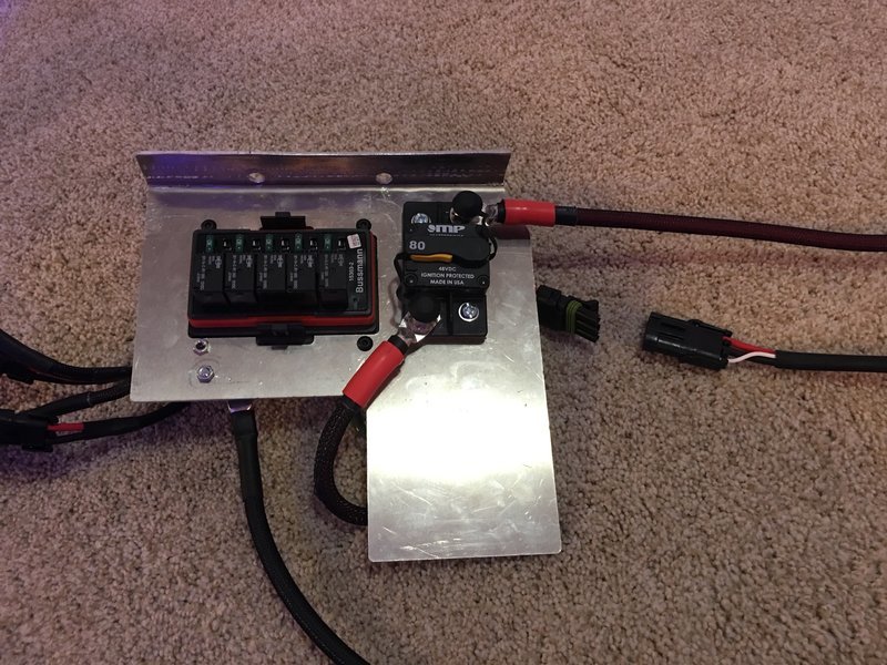

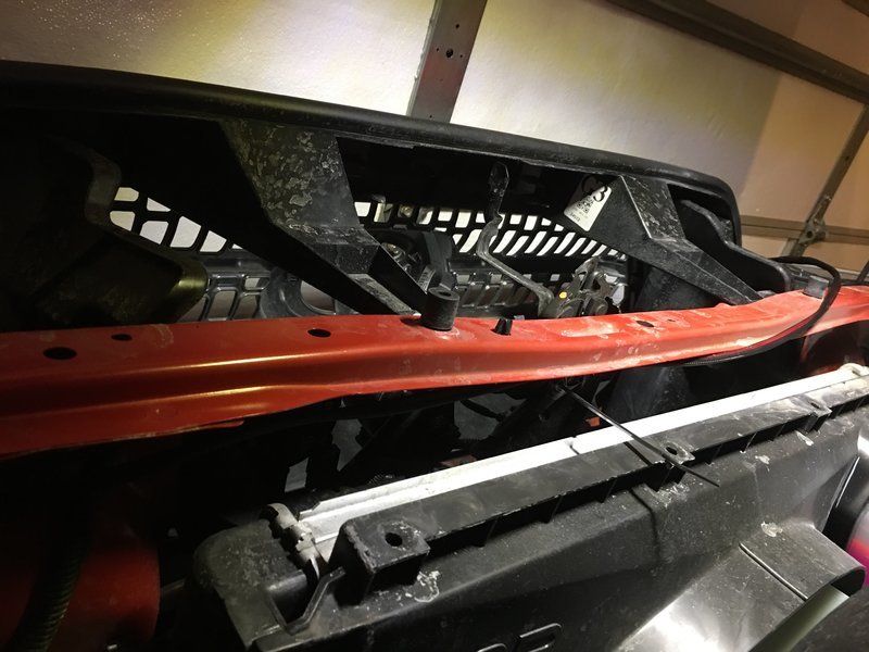

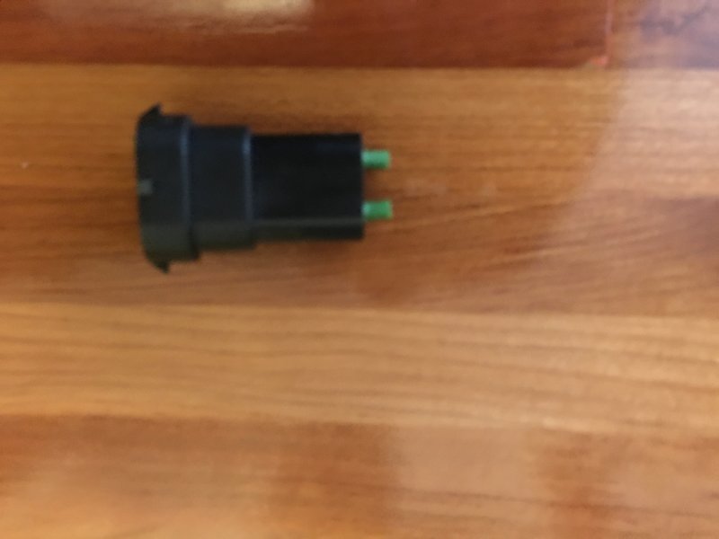

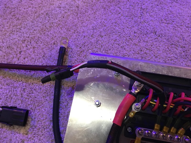

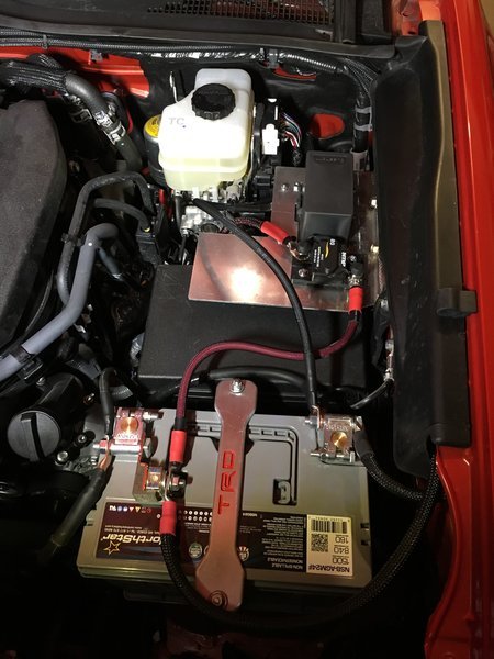

    First off let me thank @crashnburn80 for his great idea and help. I went a little different route, but still incorporated his intent. I already had the busman 10 circuit added to my truck. It is wired with 4 Awg though an 80amp breaker directly from the battery. So I decided to use one of the relays for the head lights. Each circuit has 10 gauge wire out so I used that for a short 18" run and then split off to two 12 gauge runs to each head light. This should have less than 1% voltage drop. If I like the results I will also be doing the fog lights.
    Harness that runs from the busman to the two headlights and also has the trigger wire from the left side OEM connector. The white 18 gauge wire provides 12 VDC to the busman relay from the OEM connector. I used a second male plug with green plugs installed on the right side to protect the OEM headlight connector from water and corrosion.
    Used to protect the right OEM connector.
    Here is the new harness next to the busman connector.

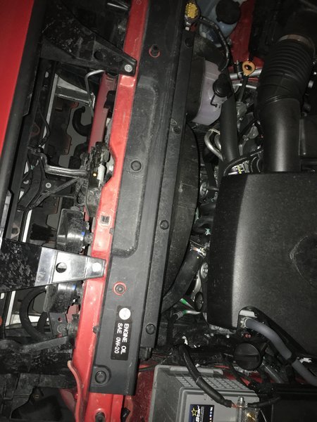

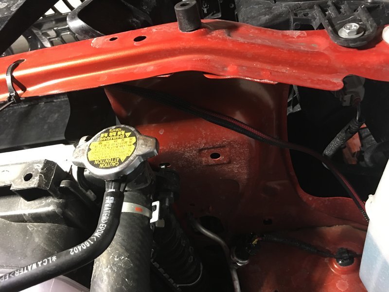

    I routed the wiring harness around the left side with the other factory wiring to the left headlight area. Zipped tied in a couple of place. pluged in the trigger wire to the OEM connector and the 12 gauge connector to the H11 bulb. I then removed the black cover on top of the radiator by removing the 7 push pins. If you notice in the picture one of the push pins is now missing as I dropped it and never could find it.
    I now have the new harness plugged into the OEM bulb and connector on the left side and the OEM harness plugged into the right side OEM bulb. This was to see if the wiring alone made an improvement. It looks like it to my eye but pictures in daylight does not show it. I will take more pictures tonight when it gets dark.
