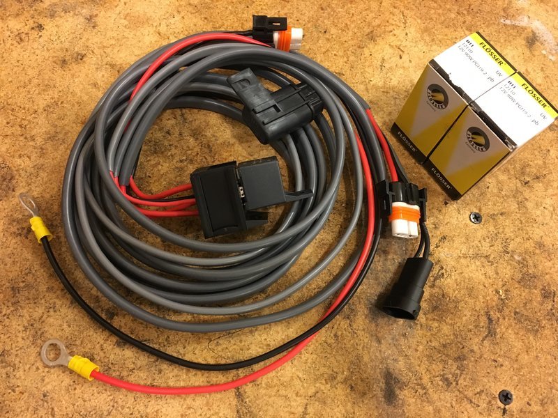

    For the H10 trucks you can use the 1450 lumen optilux 65w H10:
    http://www.rallylights.com/h10-9145-12v-optilux-extreme-xenon-xb-bulb-pair.html
    I'm not a fan of the coated 4K bulb, but that is the brightest H10 I've seen from a credible manufacture. I would suggest running a harness.
    Or
    Philips 950 lumen 55w 9145/H10:
    http://www.rallylights.com/philips-9140-9155-right-angle-py20d-base.html
    Which could likely be run without a harness. Note that the harness reduces voltage drop and causes your lights to be brighter, so while it protects the trucks electrical system, it is just as much a part of the upgrade to increase output. If IRC it is something like a 15% performance improvement from
    The harness.

    The fog H11 harness was a custom build requested by me, not an off the shelf part. You'll have to contact them about an H10 harness.

    Part number is listed in the thread:
    ...call Rally Lights at (610)944-3233 ask for Ray and tell him you would like the HL282H11 Wire harness.
    But that part number is for H11s. If you are trying this for your fogs, and have H10s you would have to contact them to build an H10 version.
