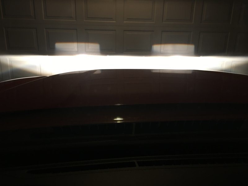

    The pictures from the iPhone show no deference as it has compensated exposure for the extra light. From behind the wheel it looks to me to be much brighter and somewhat whiter. I like it and will be doing the Fogs next. There is no change in cutoff and that is why I went this route.

    I have those.
    Just wiring hooked up on left side
    Wiring and new bulb on left side
    Both

    I envy the clean lines on those projectors. :drool:
    You can clearly see the output is increased on the left light, but so close to the wall it is difficult to see the extent. If using a wall I'd recommend output pics at 25ft from the wall, unless just comparing color.

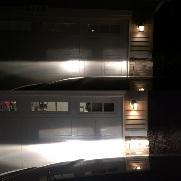

    Here's my before (top) and after (bottom) photos after upgrading my low beams on my 3rd gen 2016 Tacoma. Daytime Running Lights (DRL) function properly. Harness is made from RallyLights.com. VERY VERY VERY happy with the upgrade.
