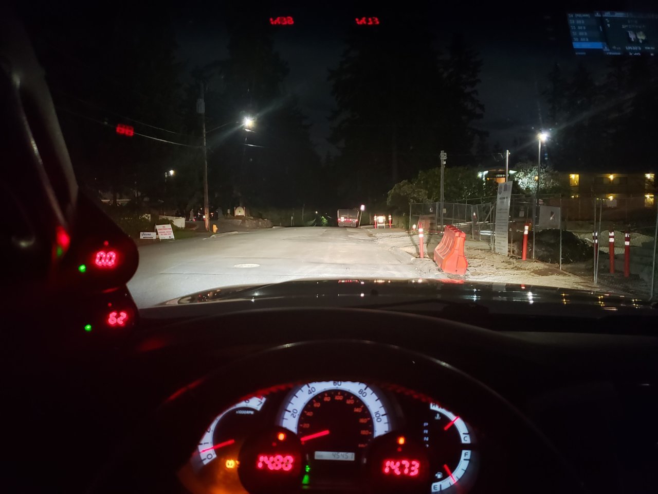

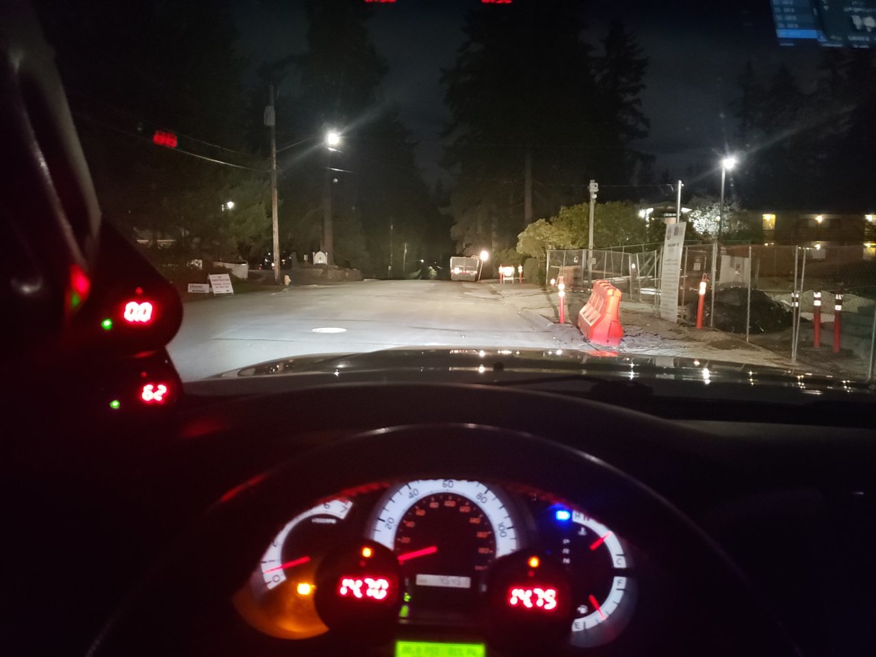

    Finally was dark enough to get a decent pic of my new osram bulbs. Beam intensity on low is so impressive. It makes streetlights look like 12w glowsticks. Thanks @crashnburn80 20190417_214611.jpg

    Wow, that is impressive for low beam. They are the P43t Allseason bulbs?

    Yep. 85/80w AllSeasons with harness.

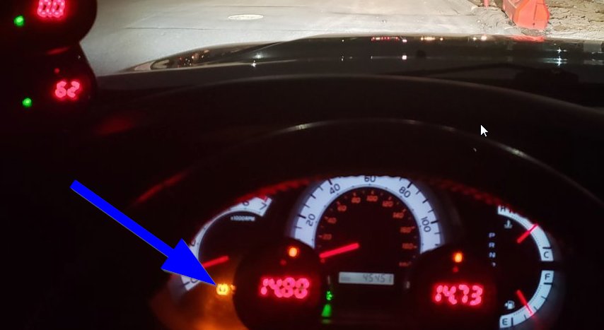

    Nail in the tire?

    We refer to his dash as the Christmas tree.

    These are ko2's aka runflats. Tpms issue.
