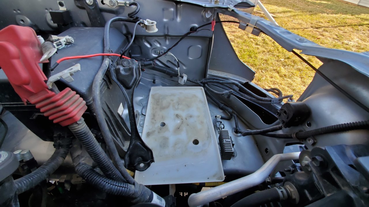

    Help me please. Where does the Male Trigger Plug go here?

    In the OEM H4 plug hanging out the front of your truck.

    Pretend you never saw that. I figured it out. Male Trigger to driver lamp plug, then ceramic plug to actual headlight. Right?

    Correct!
