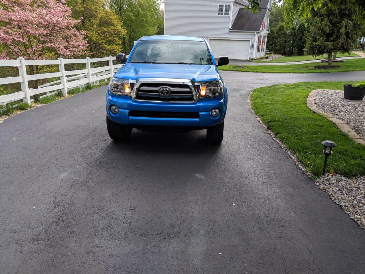

    IMG_20190426_152724.jpg Just finished this on my truck. Thank you so much for the good write up. I was about to make a mistake and go with some aftermarket stuff. It's amazing what just replacing the headlamp assembly can do! Thanks for linking the parts to make it easy.
    Right now, I just kept the OEM wattage because I want to see how those do before upgrading the wire harness, etc. Really happy with the new OEM smoked headlamps though.

    Looks really clean and sharp! You could throw in the GE Xenon +120s for a good bump in output at stock wattage.

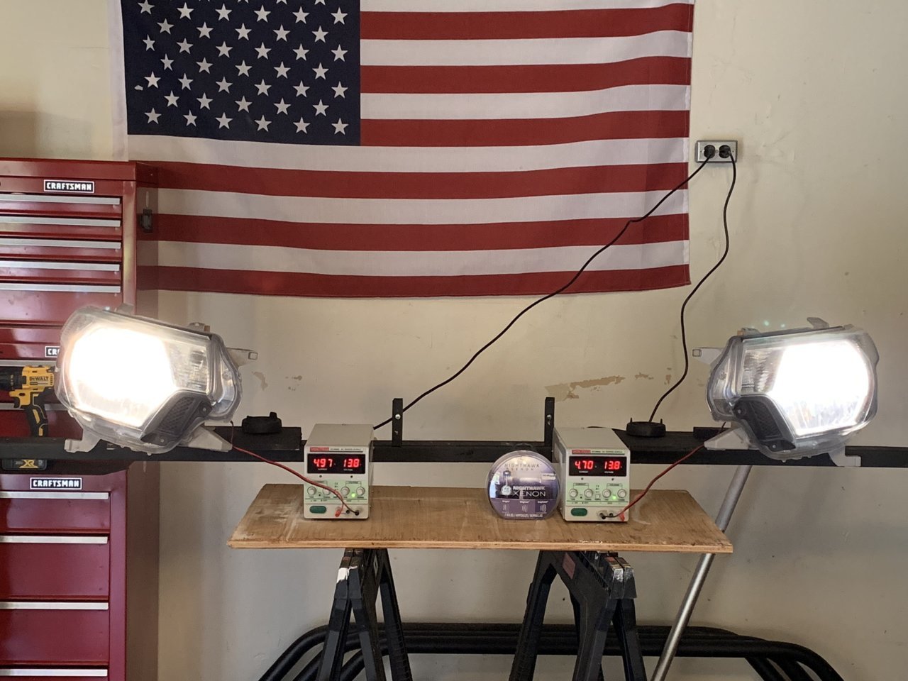

    The 2nd Gen lights are mounted!
    Still need my high power leads for the space station power supplies, so I’m limited to stockish wattage till they arrive.

    Training.

    He needs his own white Lab coat at the very least if he is going to run instrumentation.

    I like where your head is at. Looks like Amazon can get it here Monday for about $13.

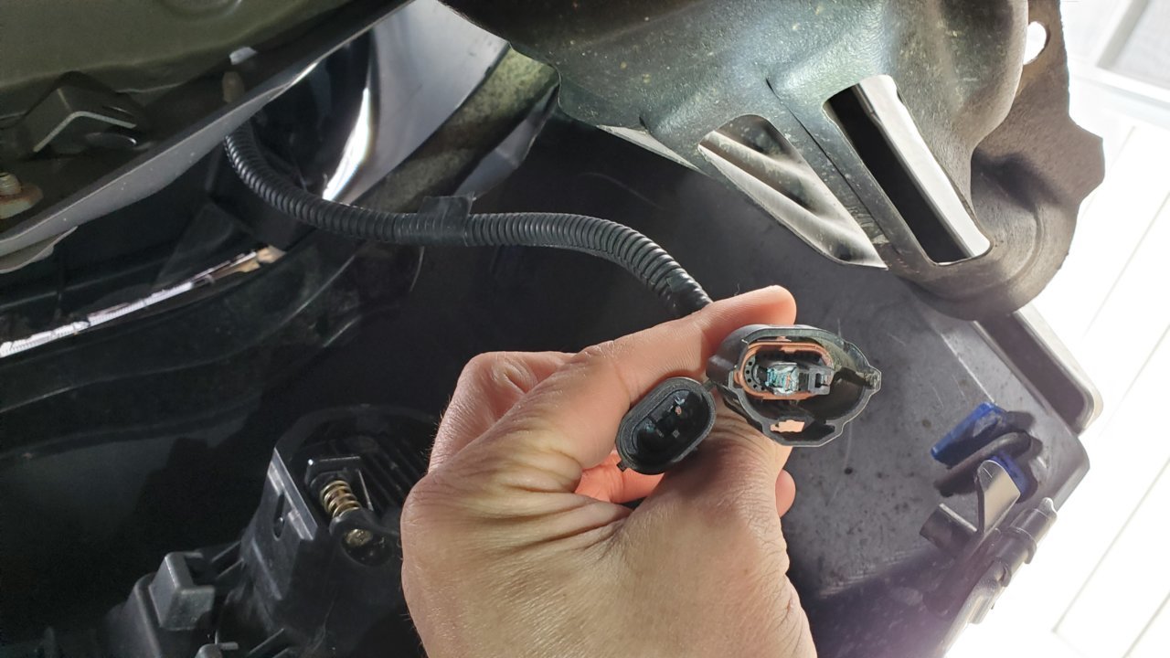

    I dug into my fog light to see if I could fix the flickering. There was a lot of corrosion on the connector and I think that is the culprit. Is that worth cleaning, normal wear and tear, or toast?

    I had to keep replacing my passenger side connector on my Tacoma. Cleaning up the corrosion was only a short term fix.

    Nope, it's toast. The factory connector is broken under all that corrosion. Frack.

    A 9005 socket is the same as the H10/9145 socket.
