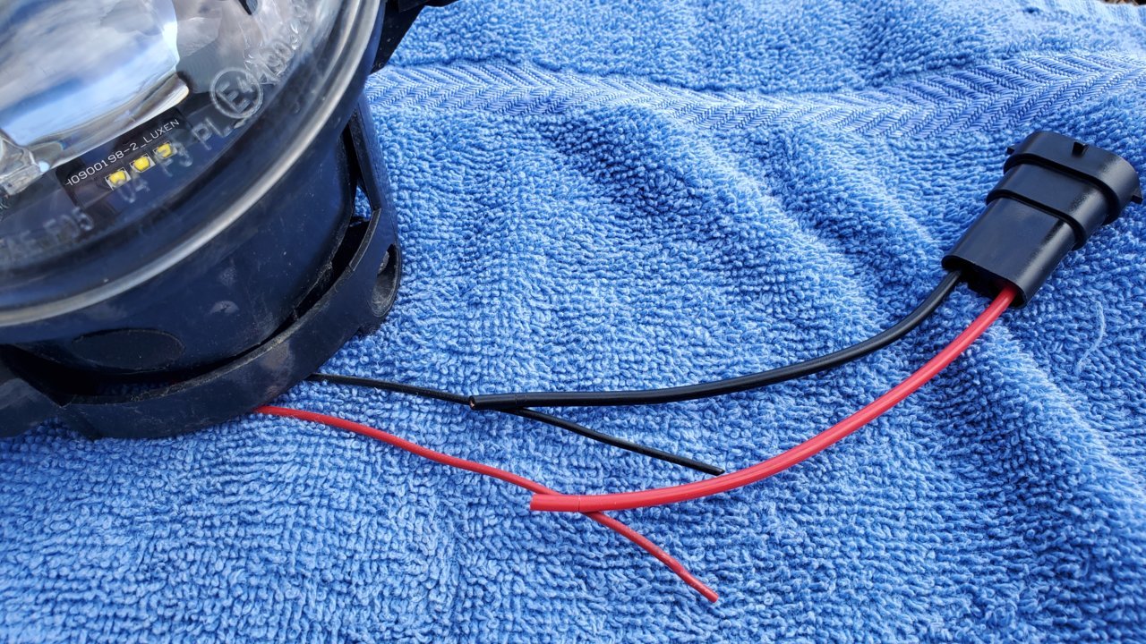

    Replacing my corroded fog light sockets. Does it matter that these 2 sets of wires are a different guage?

    It just means the ones closer to the fogs will burn off first in the event of a massive short :D. No in all reality it's such a short distance between them it doesn't matter. In electrical work we would even allow 3 meters as a tap conductor. The fuse protects the wire, not the device.

    OK Thanks! I'm going to screw something up here I can feel it. Electrical stuff is not my strong point.

    Using larger wires isn’t harmful, it is smaller wires that you want to avoid which may reduce voltage and performance. However LEDs are less affected. Your setup looks fine!
