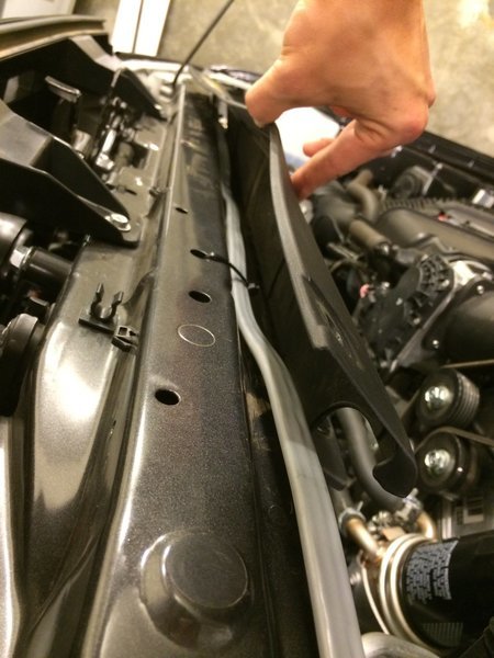

    I ran it across the top of the core support under the plastic cover to the radiator.

    I found an open spot near the driver side headlight to mount the relays.. and zip tie zip tie zip tie :D

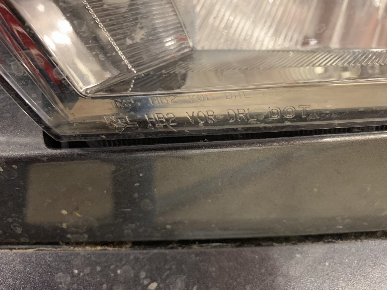

    That's kind of what I did. I marked the hot spot of the old lights, and adjusted the new ones to match. I would like to do the real adjustment procedure from Stern's website, but I have no access to a level area 25 feet from a vertical wall. Also, I see no markings on the Tacoma headlights to indicate if they are E-code, VOL, VOR, etc. So, I wouldn't be sure of the proper adjustment anyway.
    I looked them over again, and I found the markings, they are VOL. Very difficult to find without knowing where to look. These things should be marked better. Still doesn't help me find a place to do the adjustment, though.

    Pros are labeled VOR. I also don’t have 25’ of perfectly level surface, hence my matching stock method.
    Cut offs remain the same with the setup. Watch where your cut offs hit your fellow motorists.

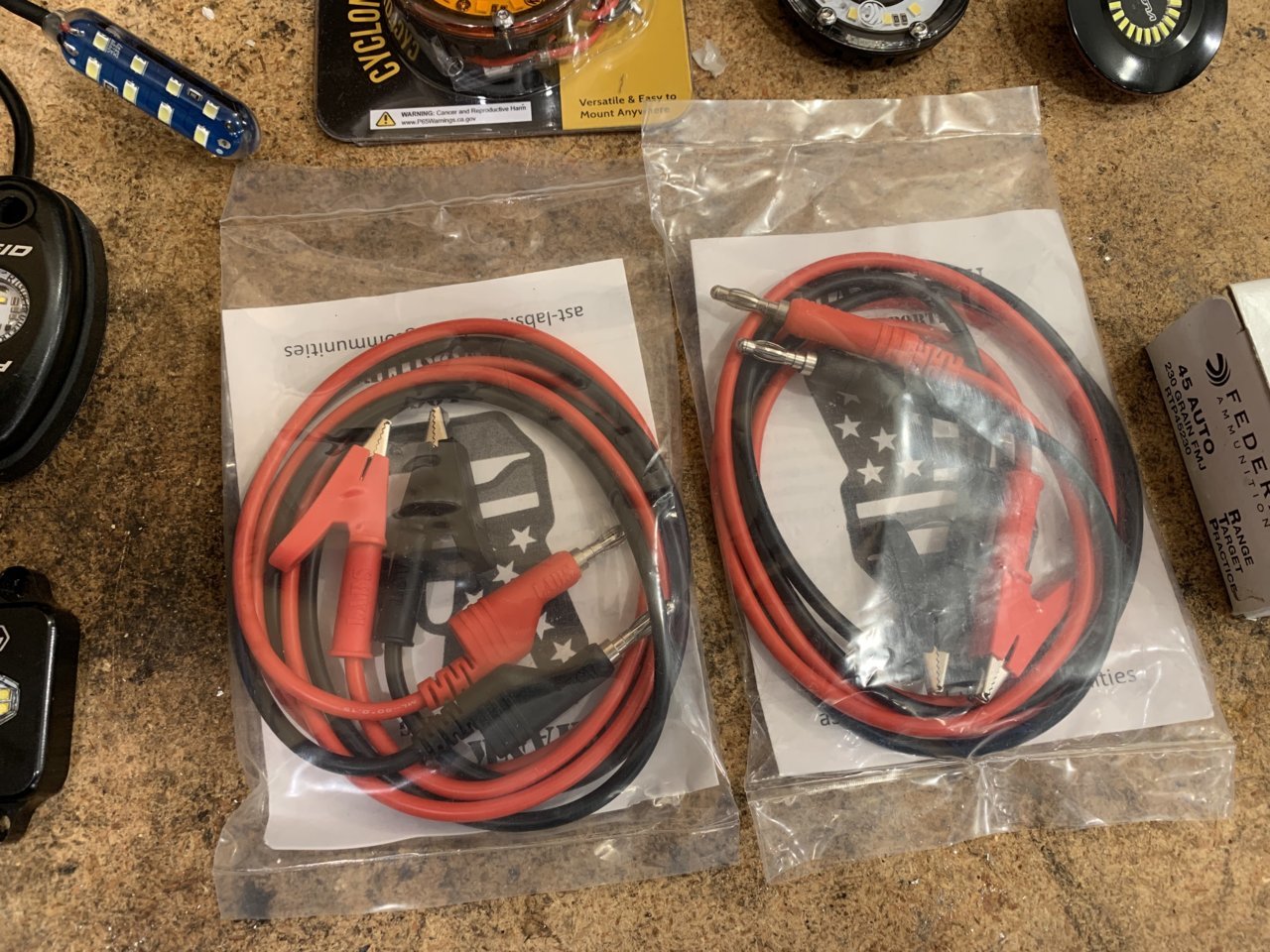

    Also, HD power leads for the space station power supplies arrived today. Final bulbs for the H4 bulb showdown are due in on Sat!

    My truck is the base model, and doesn't have the sport/pro package, and my lights are labeled VOL.

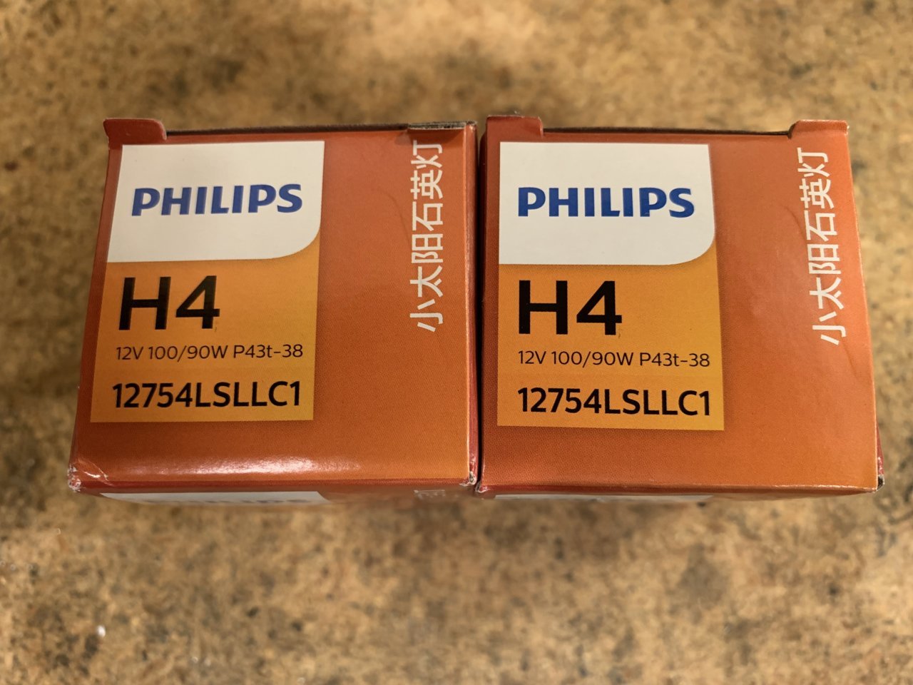

    Final Philips 100/90w bulbs arrived.
    We’ll see if the 100/90w Osrams can hold on to the title of brightest bulb.
