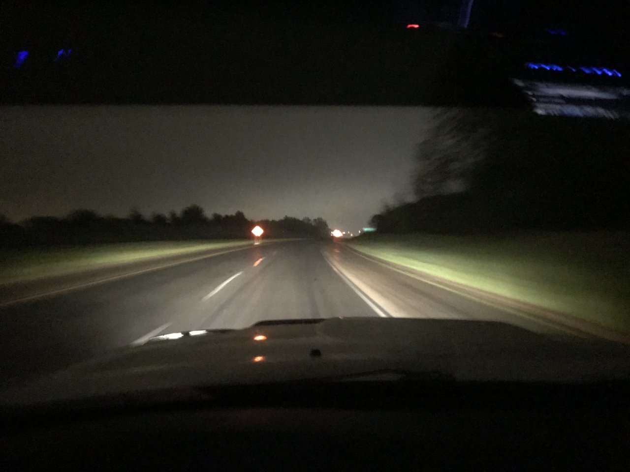

    Even after having my headlights professionally adjusted.for $25 I still get flashed at night from maybe 1/10 cars coming toward me. Anyone else have an issue with people flashing their brights at them since doing this upgrade?
    I have the 100w bulbs. I wish I could find the 85w bulbs.

    Nope. I've had Toyota "professional adjust" my headlights as well, they did a shit job, I went back and demanded my money back. I had never been flashed till they messed with them. I was able to do far better on my own than their technicians for $120+/hr. Unless Osram restarts production the 85/80w are pretty much gone.

    Just realized you are Tundra, checked your build thread, how clear are those headlight lenses? Fogged lenses cause scatter/glare, and the pics at the beginning look like yours are sub-par shape. 3" lift plus oversized tires on a Tundra platform isn't helping either. But if you could restore your lenses back to clear I be it would go a long way to helping the glare issue.
