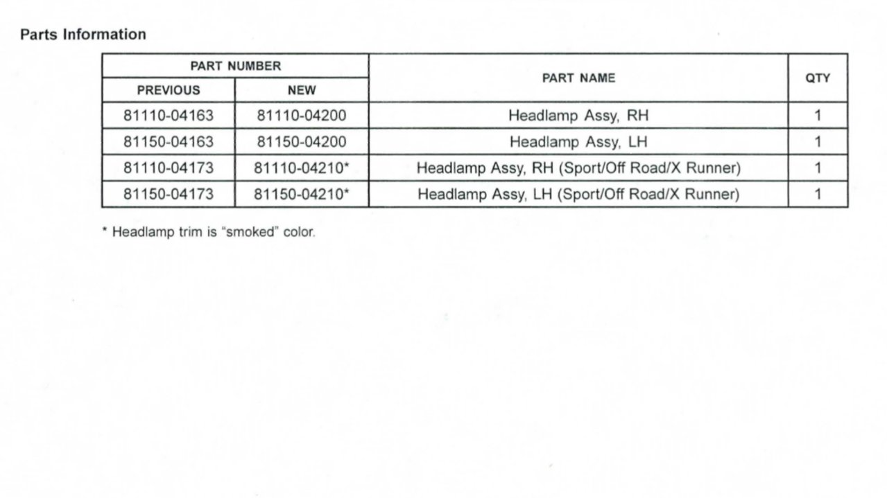

    It has come to my attention that the 2005-2011 TSB headlight numbers in this thread for the smoked chrome lights may be incorrect. Per the attached TSB doc the correct numbers are below.
    81110-04210
    81150-04210
    My sincerest apologies to anyone that I led astray. I will update the OP.

    When I do a search for 2009-2011 Smoked/Sport headlamps, these are the part numbers I get:
    81110-04173 - right assembly
    81130-04173 - right assembly
    81150-04173 - left assembly
    It's weird that the website doesn't show that part numbers 81110-04210 and 81150-04210 replace their respective previous numbers, but that might be what you actually get when ordering.
    I've ordered from them quite a few times without issue (I live 14 mi away). When in doubt, provide your VIN, and they'll supply the correct part if it's wrong.

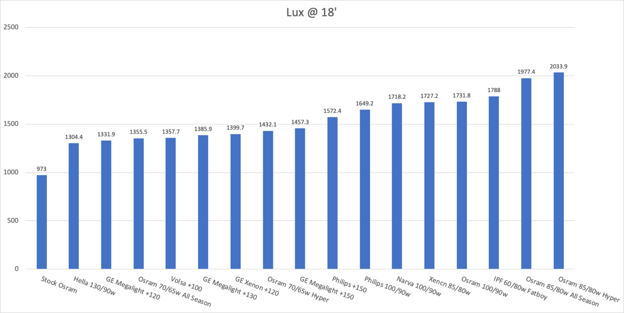

    So now the big question, how do you think the GE Nighthawk Xenon +120 compare to the discontinued Osram 64205 bulbs?

    Lux data was updated in the original post. The bulbs are great, but only a little better than the Xenons on low beam, though the Osrams will have better high beam than the GEs. I have a set of the Osram 64205s to sell, PM if interested.
