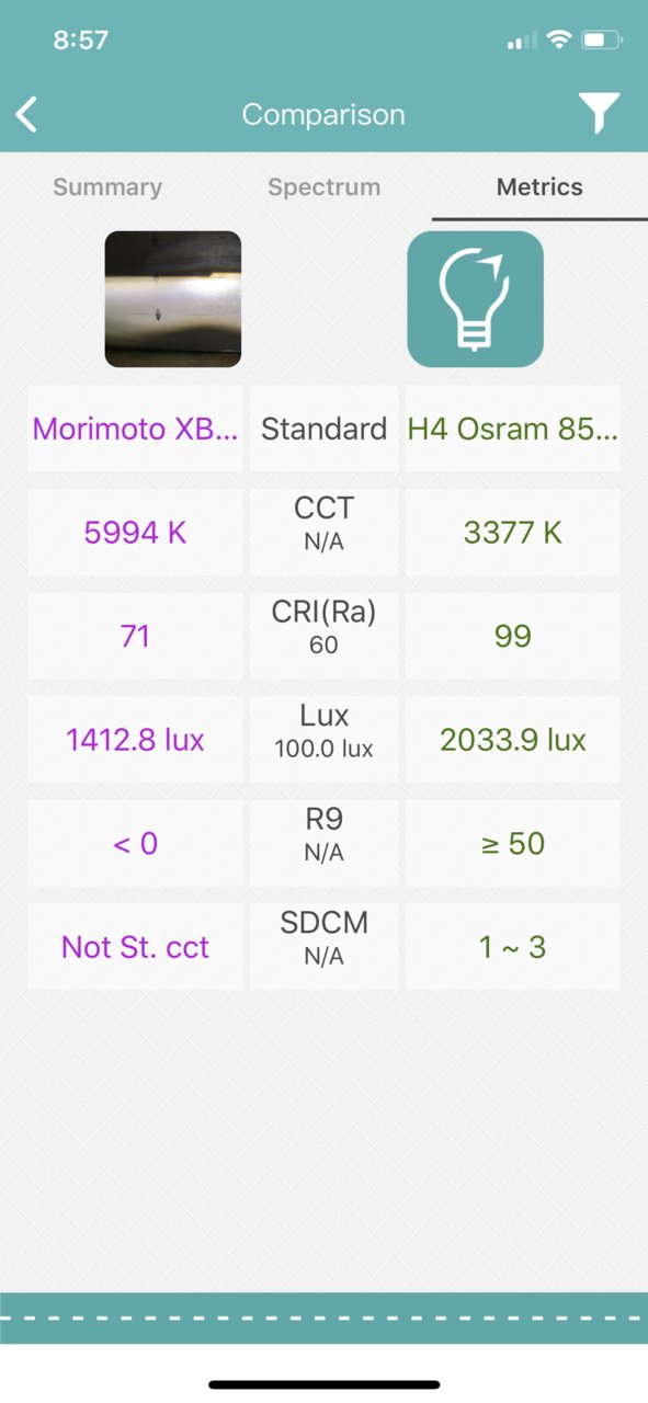

  12. Jul 5, 2019 at 9:00 PM
    #2212
    crashnburn80
    crashnburn80 [OP] Vehicle Design Engineer
    Jun 6, 2015
    #156893
    14,772
    Kirkland, WA
    2003 DCSB TRD OR
    Just for fun, the ultimate headlight upgrade lux vs the new $1250 Morimoto 3rd Gen headlights.
    mcharfauros, SaphiraTaco and BenMara like this.

    Which bulb was that? All season??

    Kirkland, WA
    2003 DCSB TRD OR
    In the reading above that is the 85/80w Hyper, at stock wattage. No harness or voltage booster.

    Seattle WA
    2013 DCLB TRD Sport
    About halfway done...
    Crazy cool. Wait do you have new numbers for All season bulbs + harness + voltage booster? That’s what I have now and it’s almost to bright.:eek:

  16. Jul 7, 2019 at 12:25 AM
    #2216
    crashnburn80
    Jun 6, 2015
    #156893
    14,772
    Kirkland, WA
    2003 DCSB TRD OR
    All Season lux output listed in the original post. Harness + voltage booster =~25%+ in additional output.
