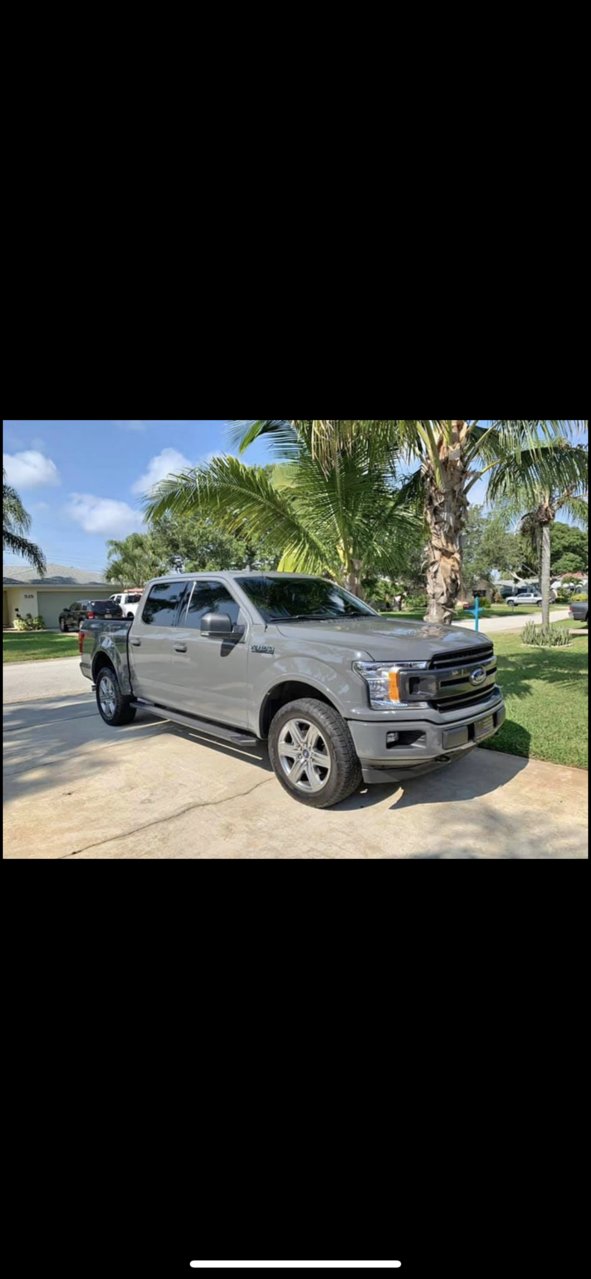

    This thing.
    And after driving with the 100/90s for a few years, I’m dissatisfied with what passes for headlights in the new truck. I sent you a PM to see your recommendations on what I can do to improve it.
