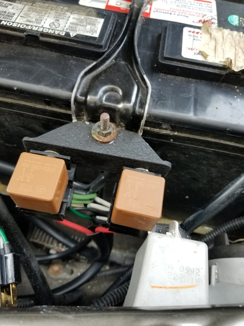

    Not powered yet but @GHOST SHIP made me this nice relay holder.

    I mounted the relays next to the battery.

    Nice! I just tucked and zip-tied mine.
    Optional, to clean things up a bit, but defintiely not required.
