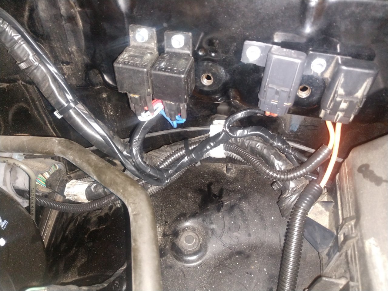

    Fly Skids Up!
    Fly Skids Up! Well-Known Member
    Nov 21, 2018
    #273384
    82
    Marc
    Fleming Island, Florida
    2014 regular cab, 4x4, 5 speed manual
    Fog lights, Weather tech floor liners, rear window tint, Gator pro tri fold cover and bed liner, Fuel Anza 16x8 wheels, Cooper Discoverer 265/70-16 AT3 4s, N-Fab nerf bar steps, The ultimate headlight upgrade, Pioneer speakers and amp, sound deadening, Bilstein shocks, Back-up camera, Class III trailer hitch,
    I just wanted to say thank you to crashnburn. Not happy with the stock headlights in my Tacoma I was looking at light bars and LED's, HID's and reading this thread I decided high wattage H4 was the way to go. I fabricated my own harness with Bosch relay's, high wattage H4 connectors, weather pack fuse holder, H4 Hella 55/100100watt bulbs from Summit Racing. Works great and inexpensive. Thanks again.
    BTW, the fuse holder on the right is for a audio amplifier in case anyone was wondering.

    crashnburn80
    crashnburn80 [OP] Vehicle Design Engineer
    Jun 6, 2015
    #156893
    14,768
    Kirkland, WA
    2003 DCSB TRD OR
    Nice, no need to buy a harness if you can build your own! What gauge wiring did you use? Those Hellas will give you much more high beam punch over stock, but they will lack the low beam performance of the Osram SuperBrights, depending on what you were looking to improve.

    Fly Skids Up!
    Nov 21, 2018
    #273384
    82
    Marc
    Crash, I used 12 gauge to the relay's #30 terminals and 14 gauge at each 87 terminals for each bulb. The relay's have two 87's terminals.
    I went with the 55/100 wattage H4 so I wouldn't blind other drivers in low beam mode.
