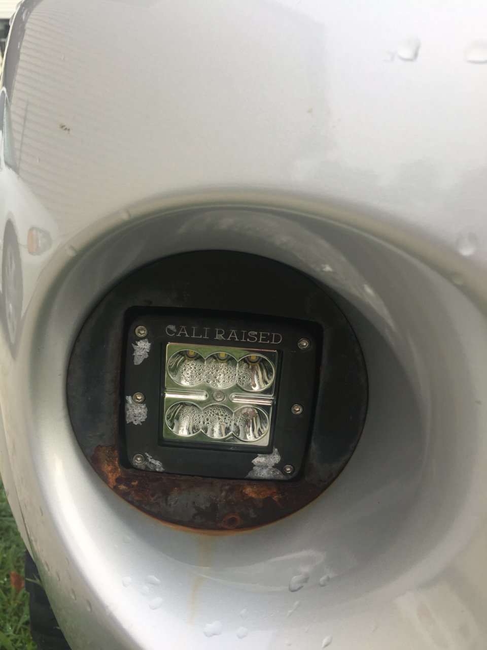

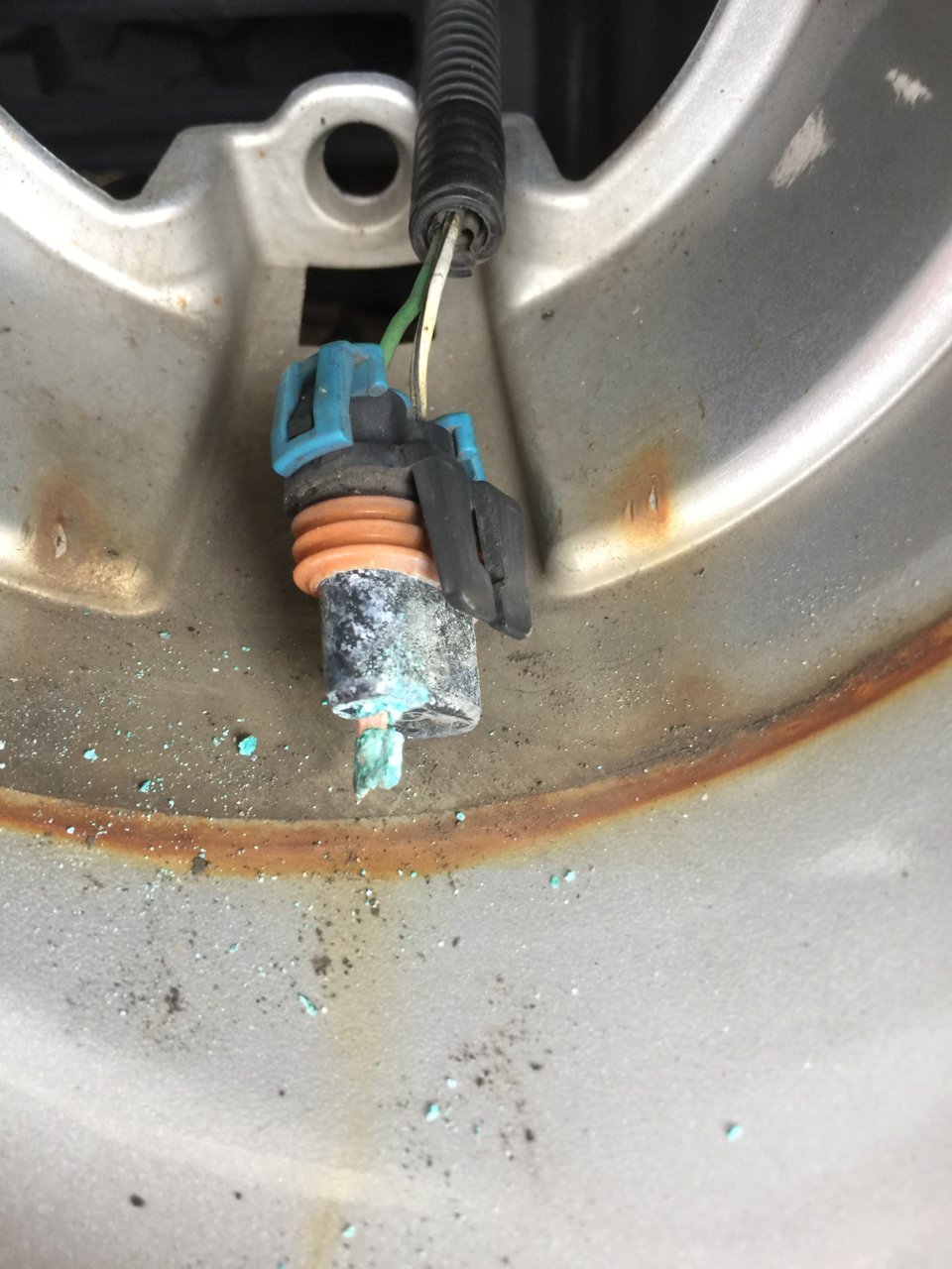

    only a week to get my bulbs also did the 9011 hir foglights with lamin-x yellow but i have a bad connection from my cali raised led pod connection going to autozone to pickup a new connector.

    Lol, looks like the connector has seen better days. What are you using the CaliRaised connectors for if you are running halogen fogs?

    I went back to stock fogs I had caliraised pods but the brackets started to rust and had condensation. I was using the adapter but not now the light works but sometimes goes out so I think the factory connector might be bad

    I had to replace mine on that side 3 times. My best guess is as the water tends to build up on the side of the road when it's raining, driving through it splashes water with enough force to get into the connector. My 4Runner came with a plastic shroud over the back of the passenger foglight.

    God dang that is terrible on all levels. I have CaliRaised side shooter ditch lights and hope they last. I had little condensation for a couple months but that went away and they've been fine for the year I've had them.

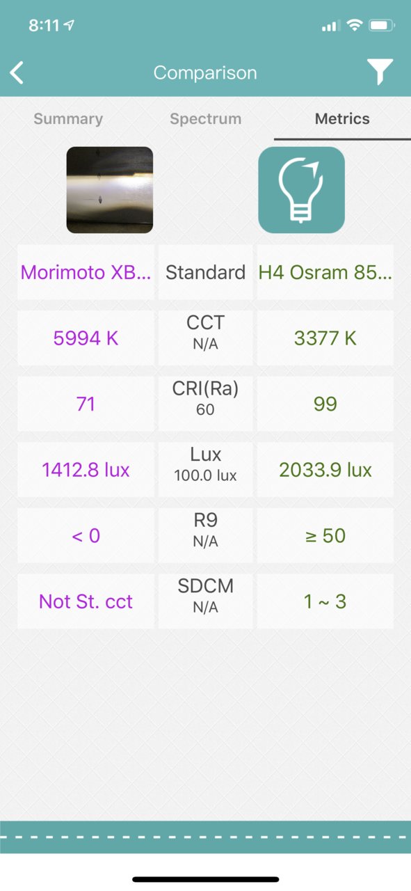

    Because I always like to compare lights, today for kicks I was comparing my measurements on the 3rd Gen $1250 Morimoto XB LED headlight assembly vs the Ultimate Headlight Upgrade:
    Needless to say the lux numbers are pretty compelling. But this actually sells the Hypers a bit short, as the voltage used was 13.8v (as measured at the headlight connector) when the harness increases the voltage to the bulbs over what is available at the OEM connector, which increases output by ~15%. On top of that, if you are running the voltage booster upgrade, further halogen output gains are recognized on top of the ~15% boost.
    For those running the Superbrights instead:
    Same caveats about selling the halogens short of their actual performance apply from above.
