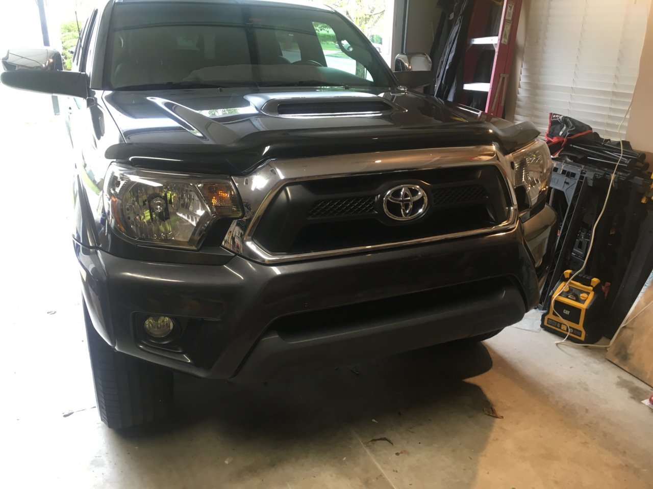

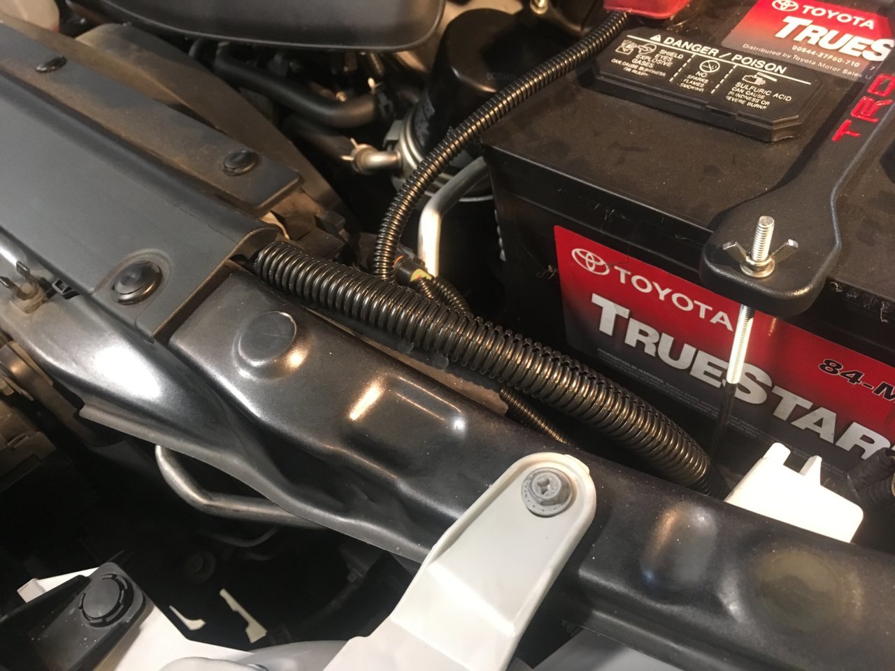

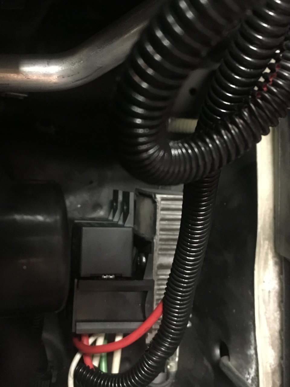

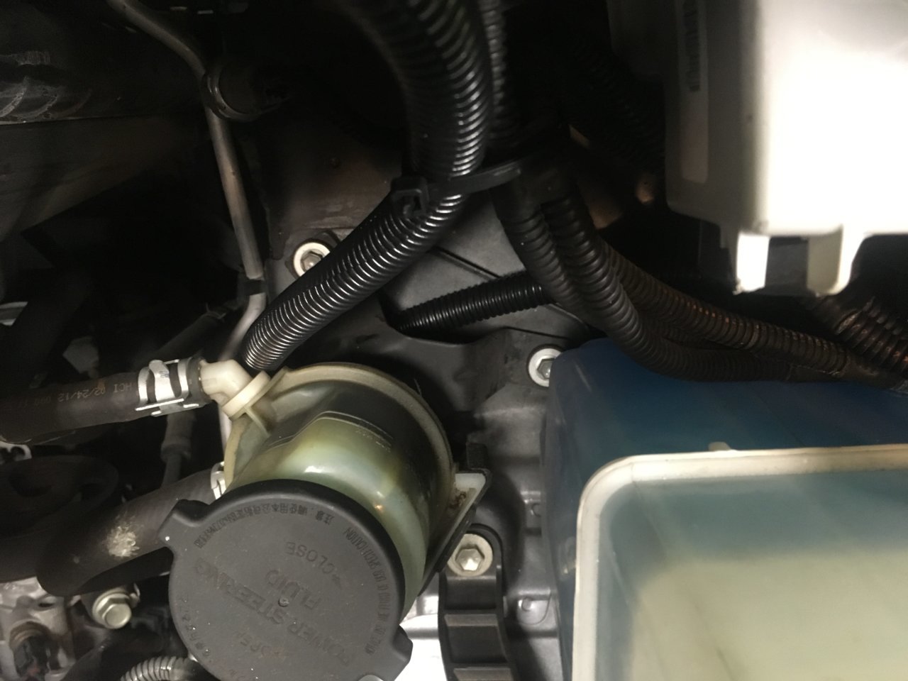

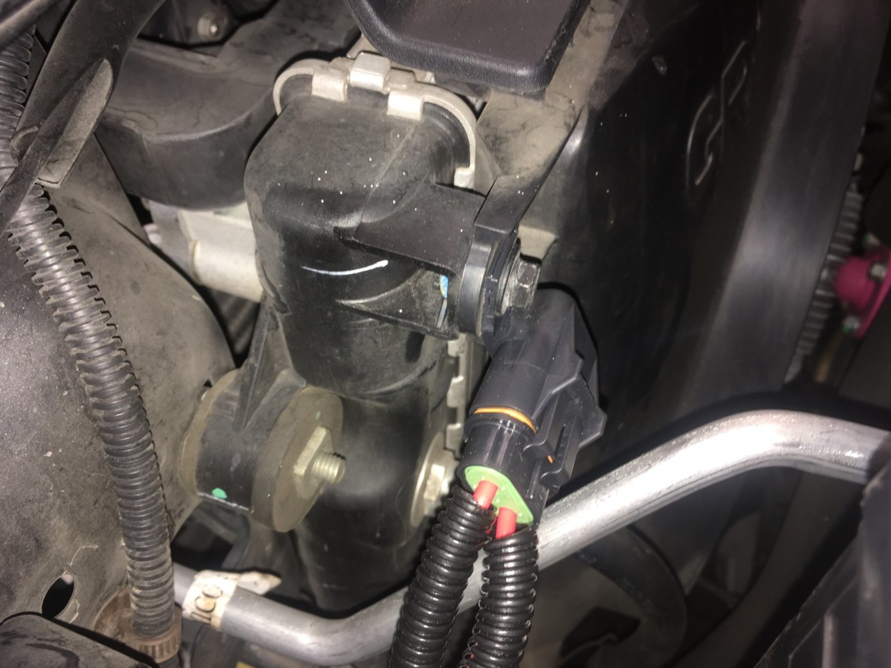

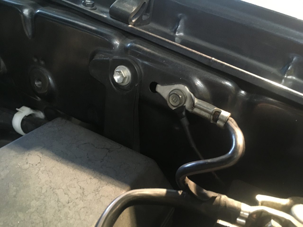

    So I did the headlight upgrade using OEM Pro Headlights, Osram superbrights, and the Hella HL 28200 wiring harness.
    I mounted the relays on an existing bracket with a heat sink looking thing in front of battery. I had to expand the slots on the relay holder slightly but then it matched up with the existing screws.
    I mounted the fuse holder to an existing bolt near radiator close to battery
    I connected the negative lead to the chassis ground.
    Ran wire over to passenger side under radiator shroud, and put loom on all exposed wires.
    Routed excess passenger side wire under power steering fluid reservoir and zip tied to existing wire.
    Satisfied with the overall installation. Looking forward to checking out the increased visibility when it gets dark tonight.
