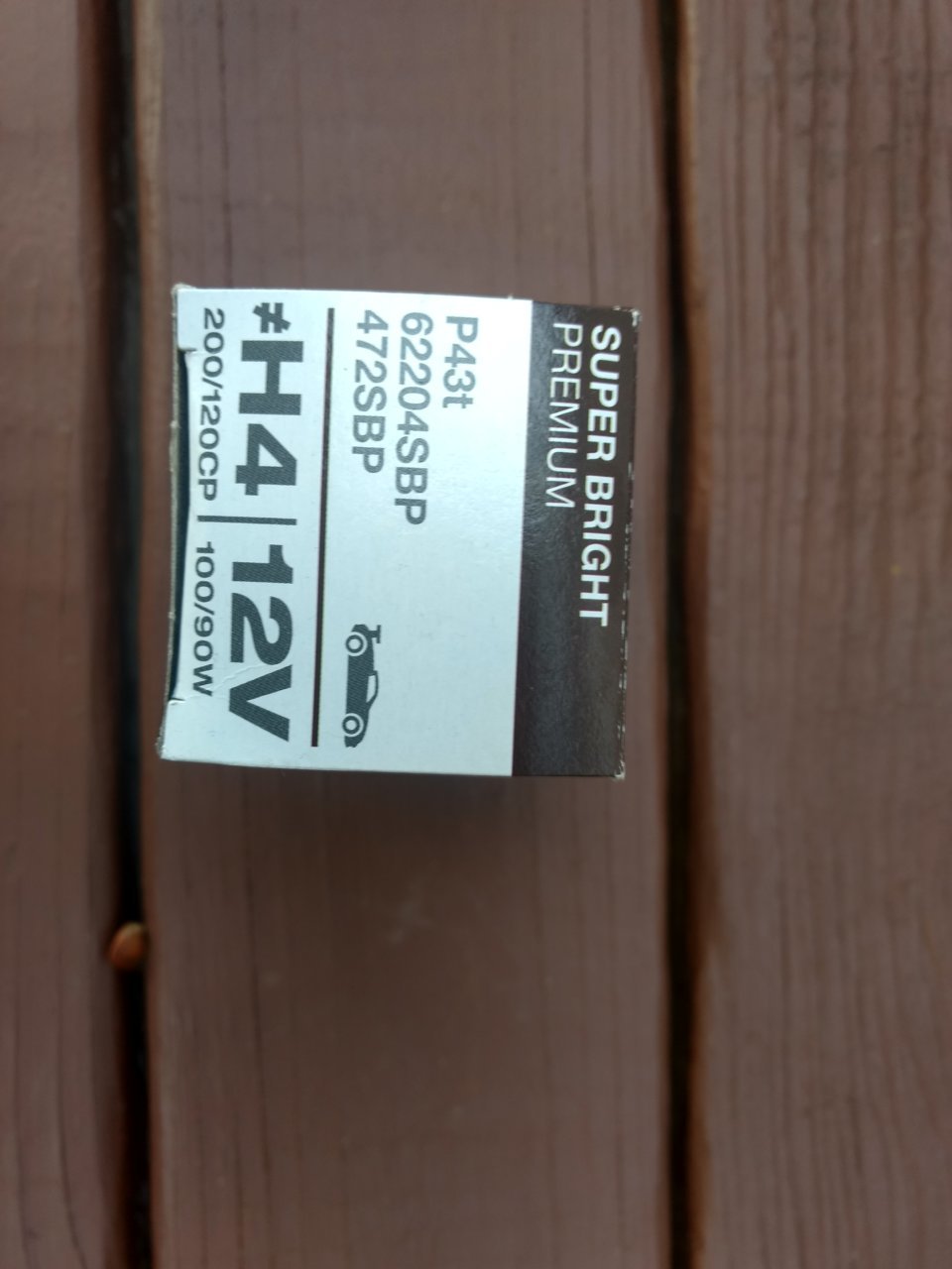

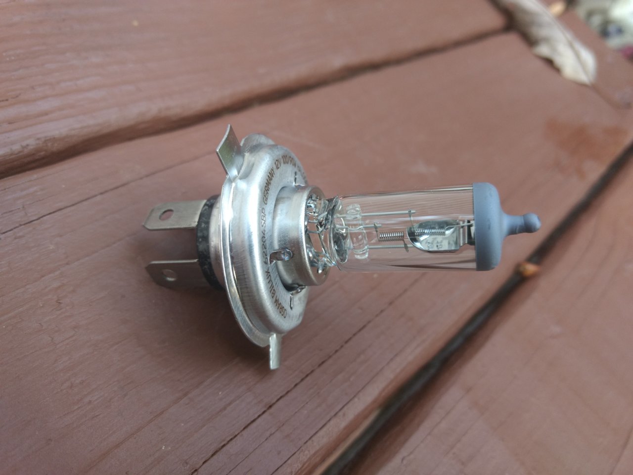

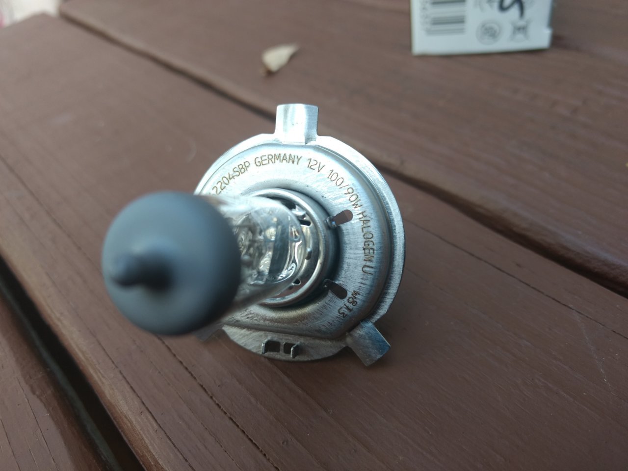

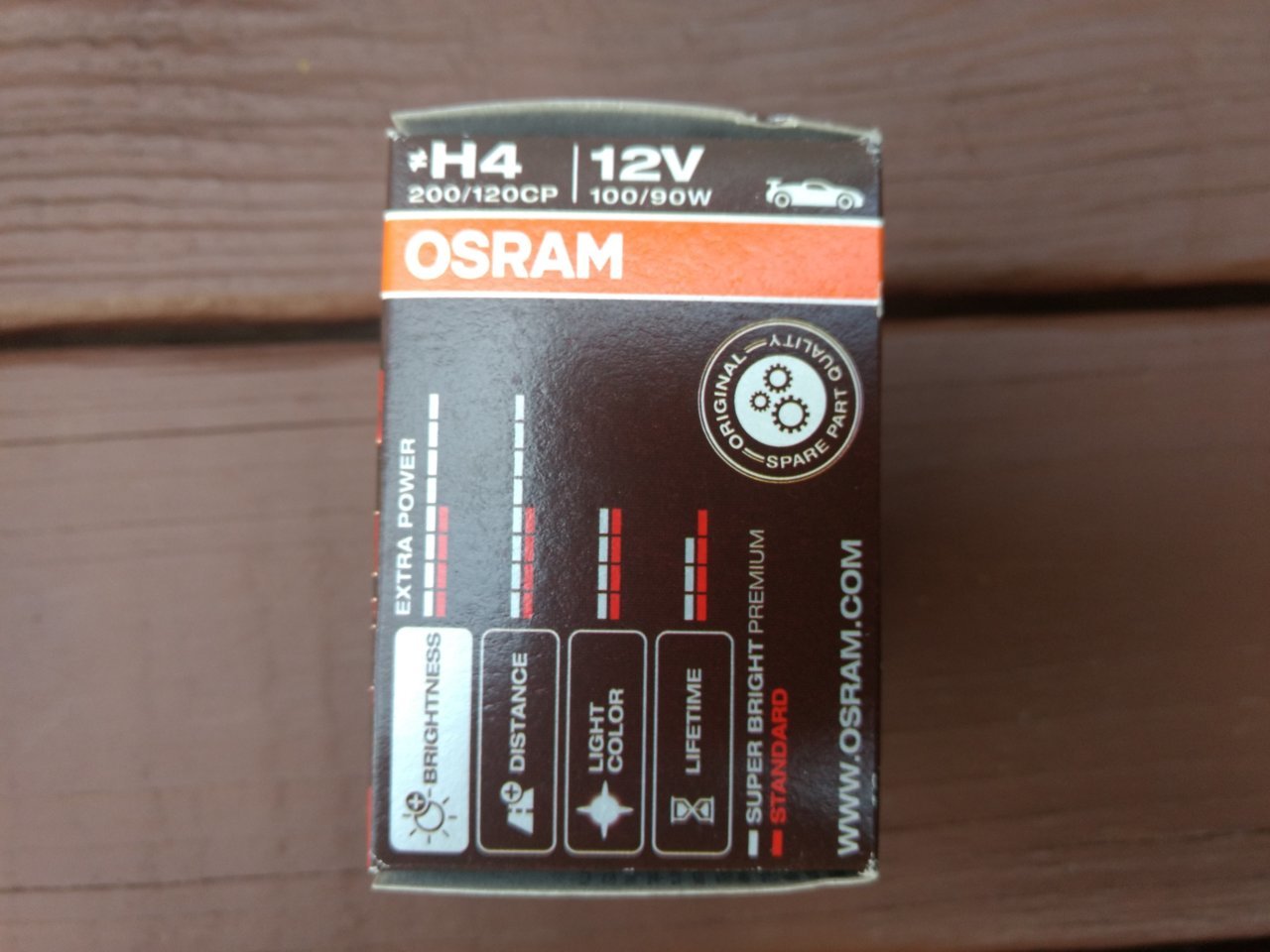

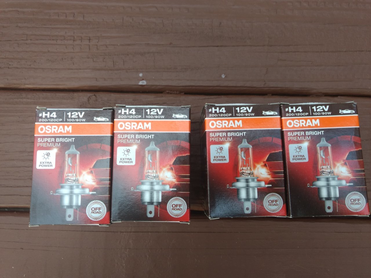

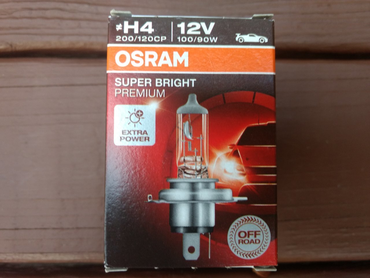

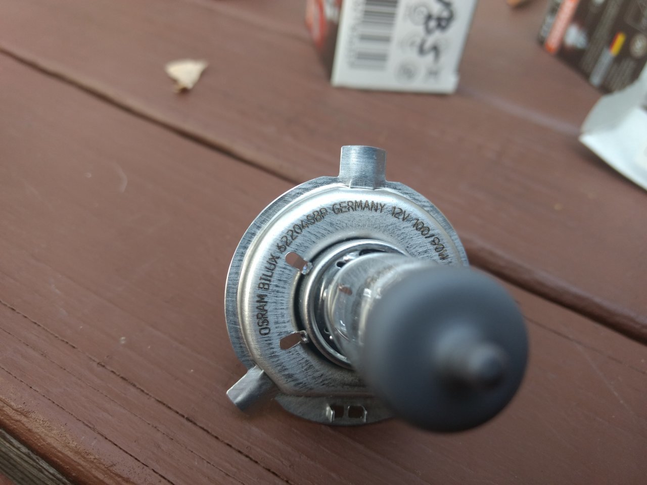

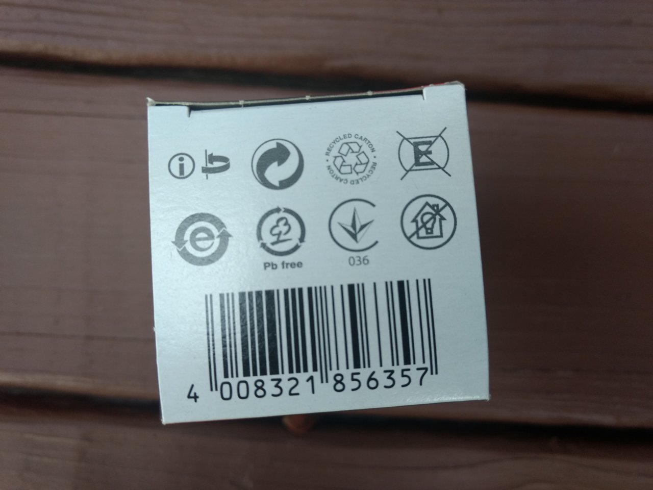

    Thanks Crash, for talking me out of the stock Philips racing and into the super Brights, with the headlight service harness. I originally ordered the super Brights from Amazon, through DC auto vendor. They screwed up my order and sent me a complete different bulb and different manufacturer. I got pissed that the bulbs wouldn't be here, when I got the harness. So I end up ordering them from the eBay listing from Lithuania. I figured I would have to wait for them anyway and Gamble to see if they were legit. I installed the harness. Super easy and very high quality. So to my surprise,I got the bulbs today in the mail. I ordered them 7 days ago. Really fast shipping and they look legit. They also packaged it very well, with there local Lithuania news paper. I thought that was funny. //www.ebay.com/itm/2x-H4-62204SBP-SUPER-BRIGHT-premium-OSRAM-OFF-ROAD-RALLYE-100-90W-12V-Germany-/223207199628?txnId=2302167428012

    Nice! Let us know your thoughts after getting them installed and going for a night drive. No need to gamble on the bulb buying though, the bulbs are cheaper at PowerBulbs with their always running 20% off coupon code, and they are an Osram approved partner.

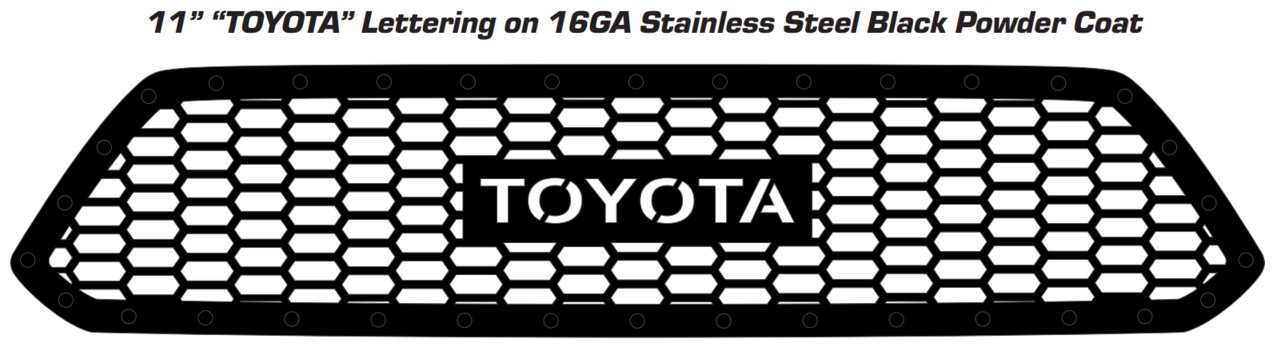

    What do you guys think?

    That looks sharp!

    Possibly depending on the products used. The more layers you are putting on your headlights though, the more you are going to diffuse the beam focus. The vinyl protection layer will fully protect the headlights. At some point the vinyl with degrade and need to be replaced, but the headlights under it will be still protected. You can replace the vinyl and have them look like new again.

    I’m probably thinking what your thinking. Lol, but I’m gonna wait and see what you come up with first. I’m thinking along the lines of some sort of juiced up hella 500’s and mesh. C739310F-36F1-4D3C-8EF9-5C96E943DAB0.jpg
