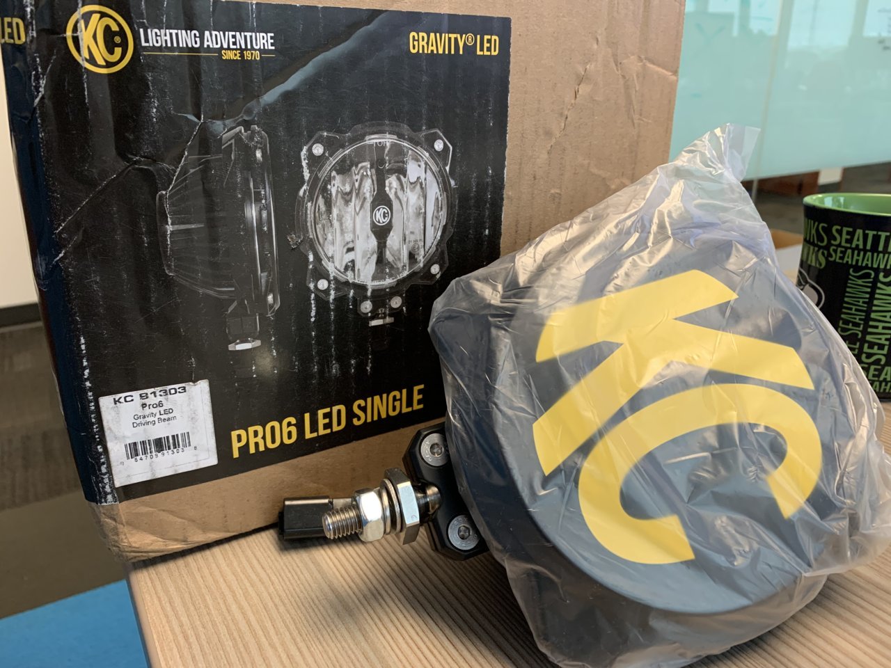

    Close! I did custom design the grill for lights behind it. But instead of the Hellas, these in Driving pattern:
    https://www.kchilites.com/gravity-led-pro6-single-pair-pack.html
    Though I had considered the Hellas with either a +150 bulb swap or a 100w swap.

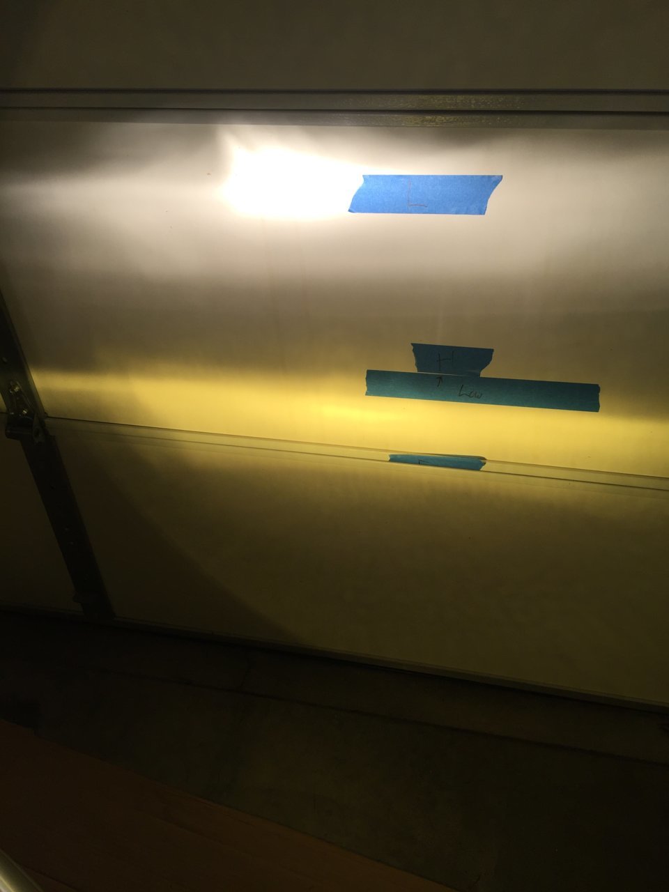

    Here is an output comparison between those Philips and the Osram upgrade covered in this thread.
    Ultimate headlight upgrade on the left, Philips LED on right.
    J Gibson and Norton like this.

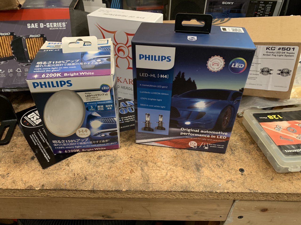

    Old Philips vs new Philips (and lots of mess)
