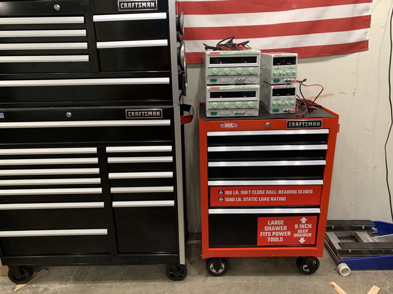

    Not exactly ultimate headlight related, but, I finally got a dedicated storage solution for the space station power supplies!
    Seems ridiculously minor I know. My previous tool chest could not fit the space station units as they were too tall, meaning they were stored in their protective boxes. This also provides a dedicated platform for the power supplies, with their storage right underneath, meaning setup and tear down is now much faster than before. Best of all since I am not setting up space consuming temporary benches for testing, I don’t have to break anything down to pull my truck in for the night. All this leads to more efficient light testing. :)
  15. Nov 9, 2019 at 5:04 PM
    #2475

  16. Nov 9, 2019 at 5:37 PM
    #2476
    crashnburn80
    crashnburn80 [OP] Vehicle Design Engineer
    Jun 6, 2015
    #156893
    14,772
    Kirkland, WA
    2003 DCSB TRD OR
    I used to have to put them away every night. Now I don’t have to. :bananadance:
