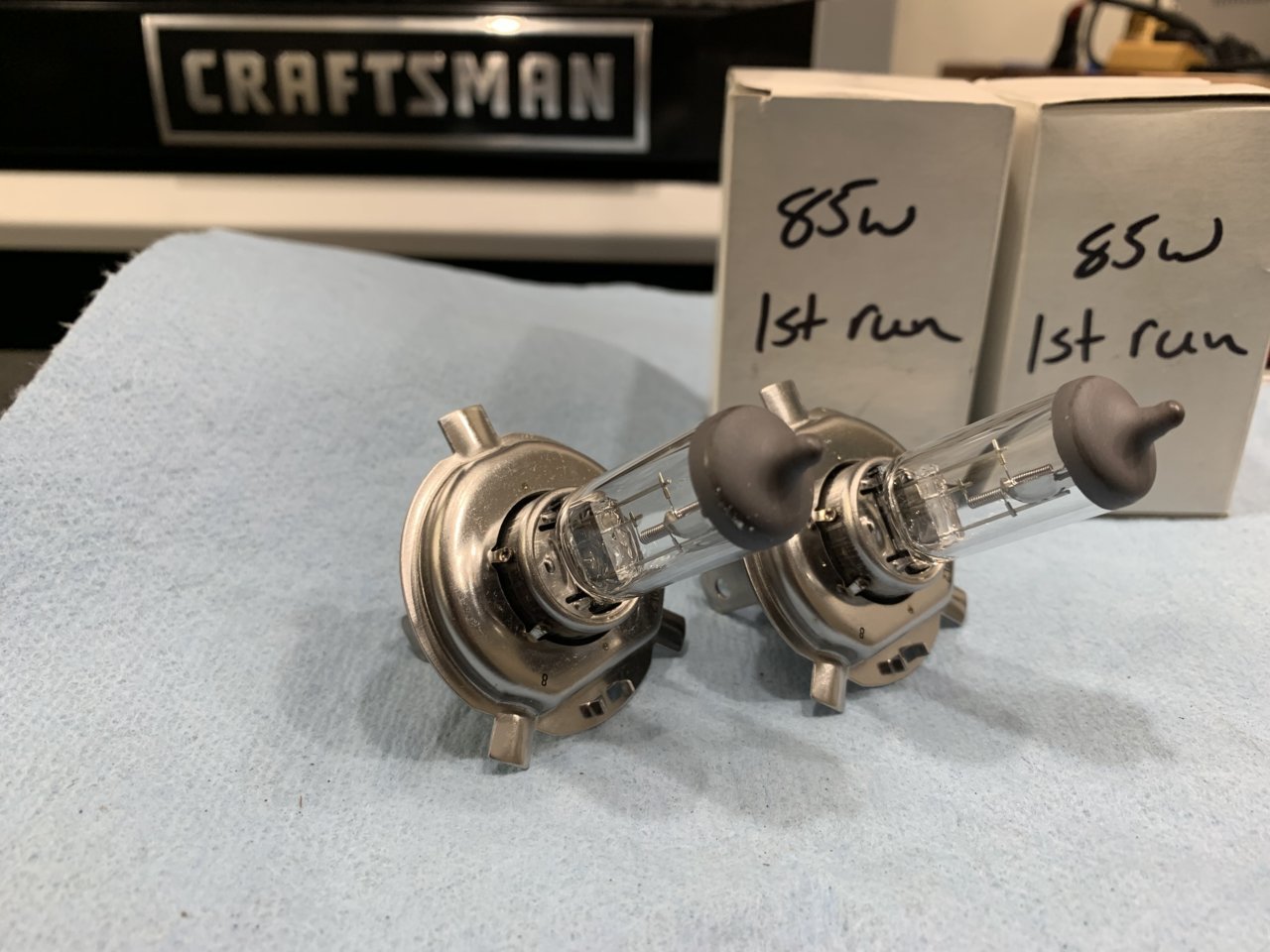

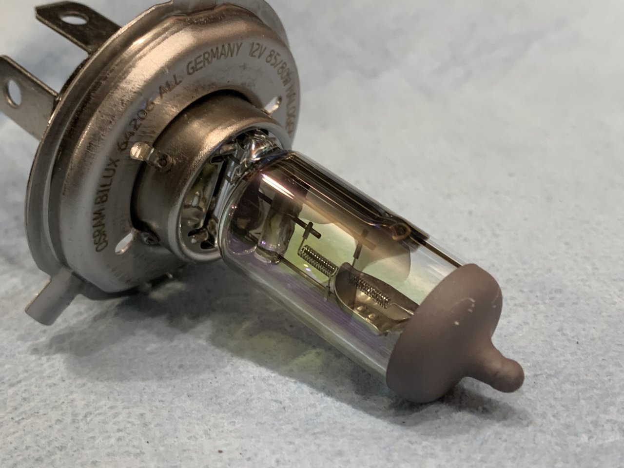

    Since my 85/80w bulbs burn out like clockwork at almost exactly the 1 year mark, I’m proactively replacing my headlights a couple weeks early. This time of year sucks to have a headlight go out, and I’d rather replace early in a dry heated garage knowing the lifespan of my last several sets vs having to do it somewhere in the dark cold likely rainy or snowy environment outside.
    I almost feel bad for using these, but my last complete pair of clear 85/80w Hypers are ultra rare bulbs from the very first limited production run of the 85/80w Hypers. The bulbs are not even labeled on the base and reside in unmarked boxes.
    These bulbs have waited a very long time for this day.

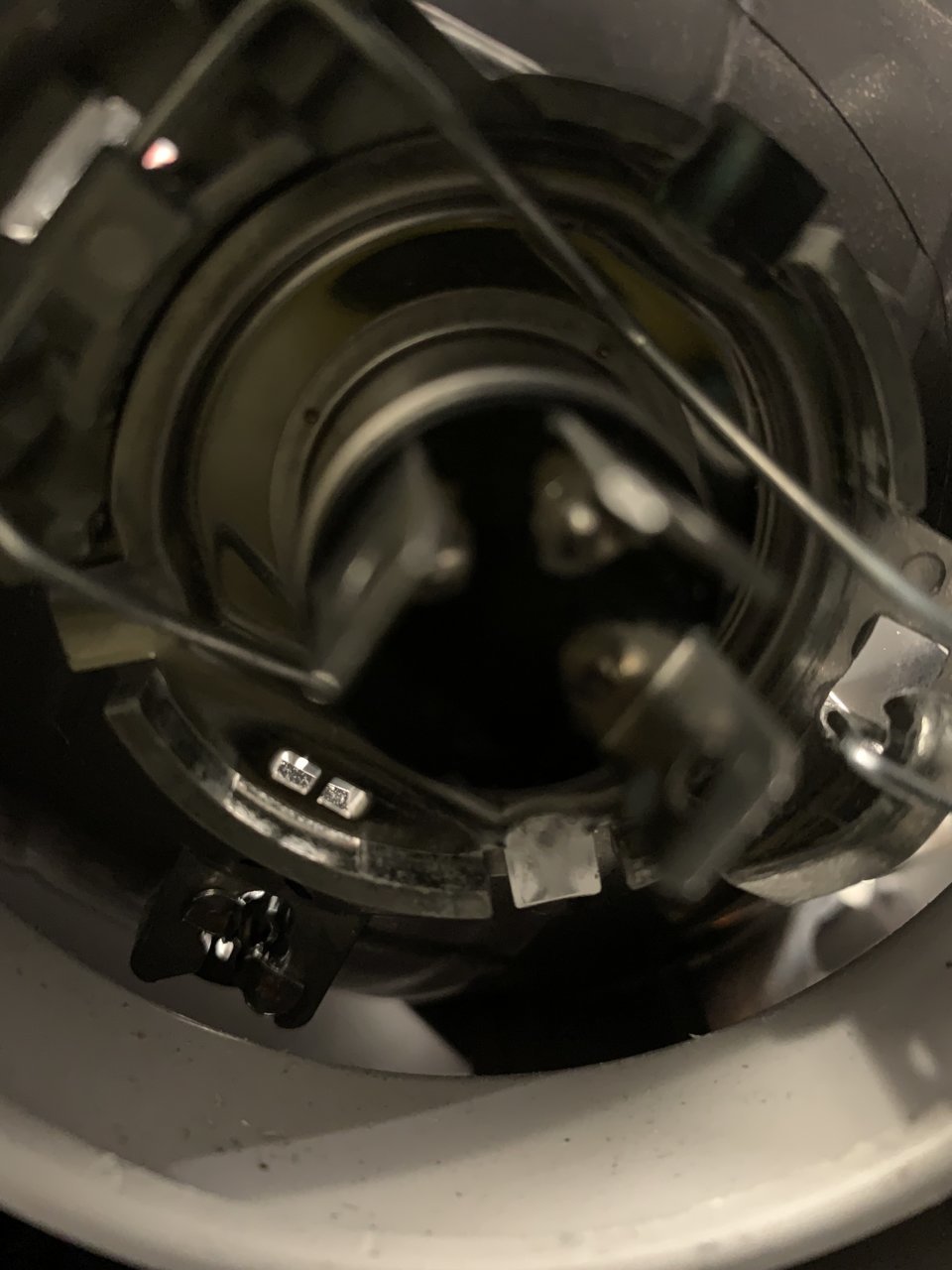

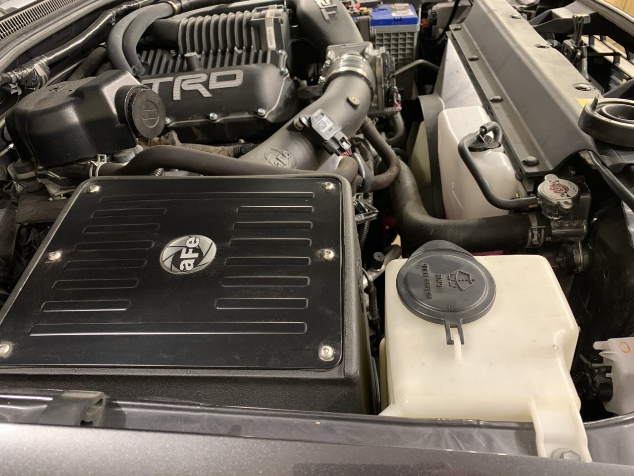

    I’m extra glad I did this early.
    This is apparently my first bulb swap after installing my AFE intake to better support the supercharger. There is now almost no room to be gained by unbolting the washer reservoir on the passenger side for greater access, meaning very tight working quarters.
    While looking through the front lens is great to check alignment, since I can no longer see the bulb, I shoved my phone down behind it to snap a pic and make sure all the tabs were seated properly.
    Checking the old bulb, they had started to blacken and blister the glass, which is not uncommon near end of life in these exotics. Glad to have fresh bulbs in so I don’t have to worry about it for another year.
