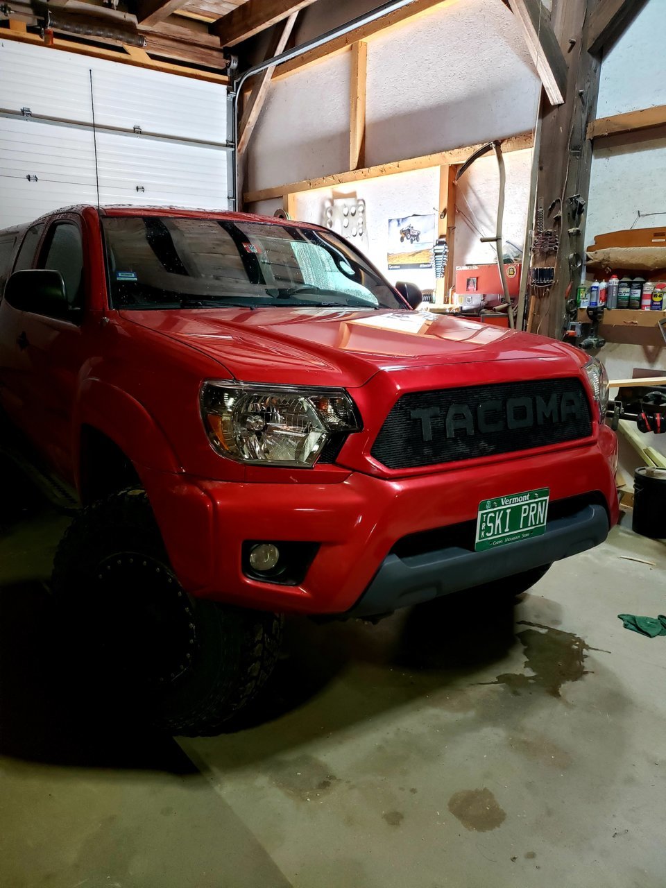

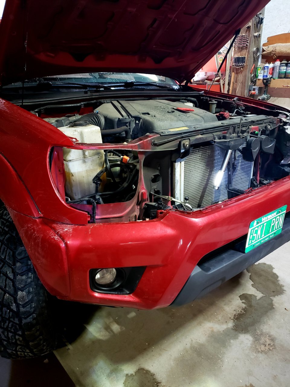

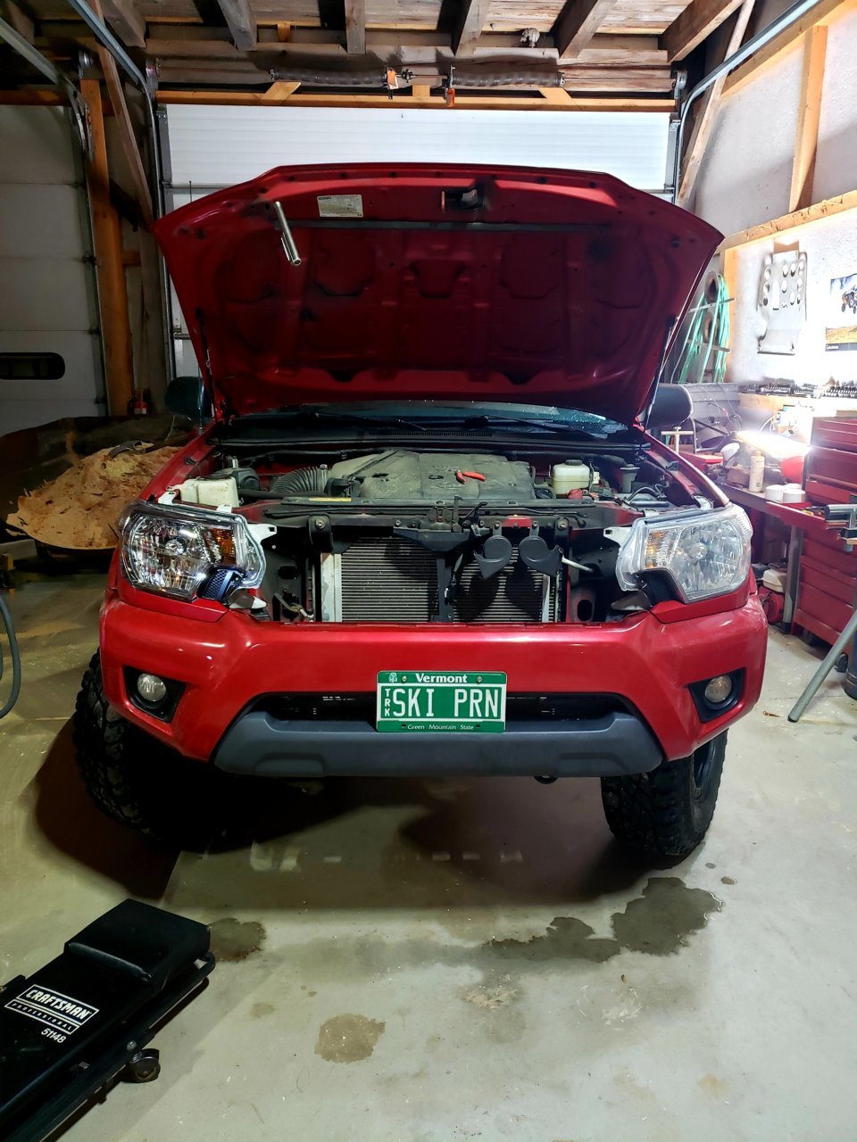

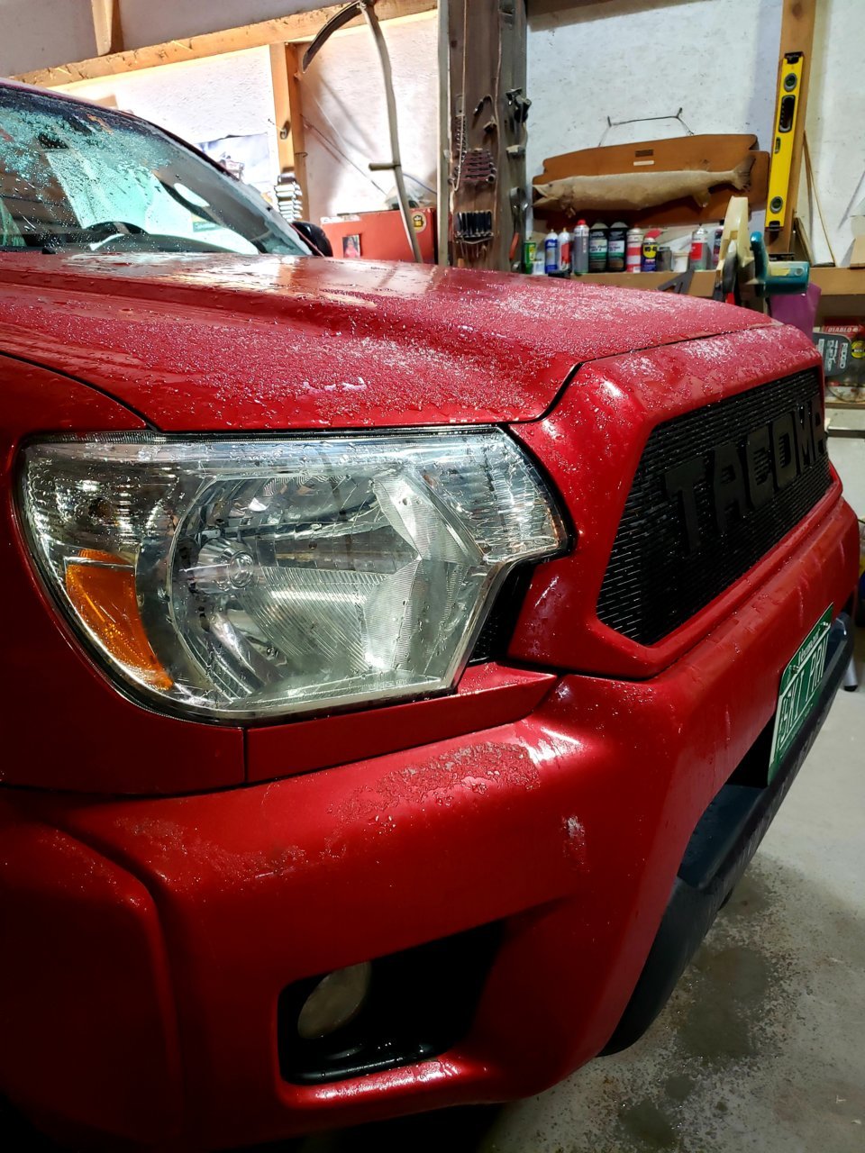

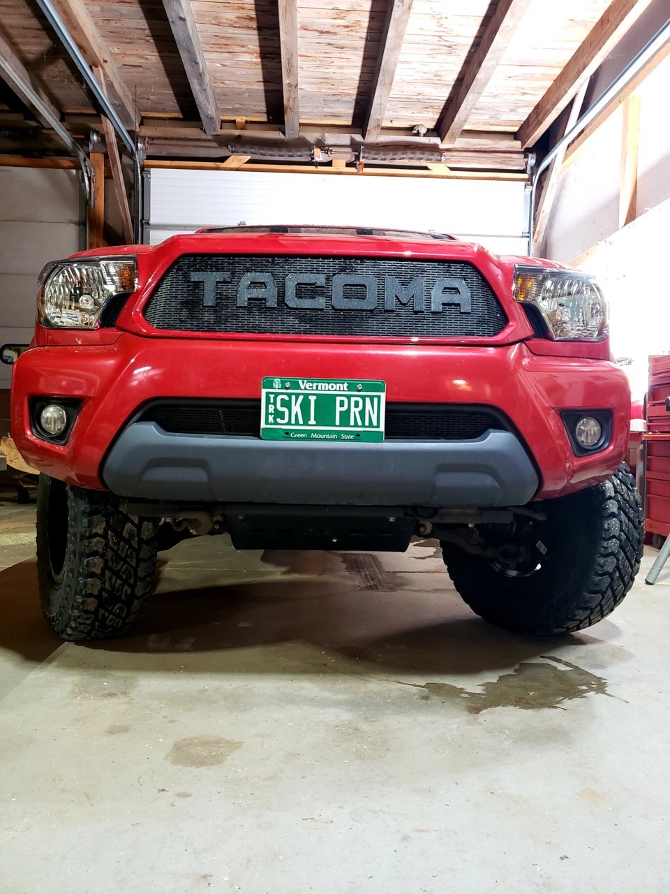

    Here's my before and after photos as promised. Personally I think she looks pretty good but then, I may be a bit biased. Paired with the upgraded harness and bulbs this setup is clutch!
    Before on top. Side by side in the middle. And after on bottom.

    Looks really sharp! The Pro lights are a nice subtle way to tone down the front chrome.

    For sure. Thanks for all the info. Made for an awesome upgrade!
