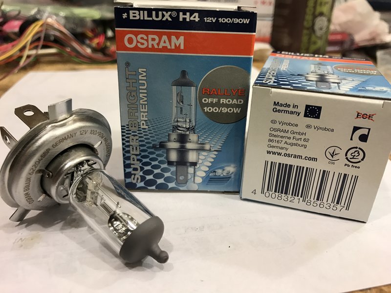

    So.... almost 140 pages worth of this thread. Are the osram bilux h4 12v 100/90w still the hotness? I can’t find them anywhere to order. I found a bunch on eBay, but they say “Chinese made”? WTF?
    pinktaco808 likes this.
  5. Jan 17, 2020 at 4:16 PM
    #2765
    gotblika
    gotblika Well-Known Member
    Apr 28, 2011
    #55716
    894
    Maui
    2015 DCLB Sport 4X4
    5100'S 887 SPC B110 EL096R
    Tsinajinii and crashnburn80[OP] like this.

    Have these proven to be good and worth it? And these are direct replacement for gen 2 tacos?

    You need the wiring harness as well, but otherwise yes they are a direct replacement. The IPF Fatboy bulbs have a little higher intensity on low beam, but they are ridiculously expensive and have only a stock high beam vs the high power high beam of the SuperBrights. Bulb life of the Fatboys is also not documented. As others have mentioned, Powerbulbs is where I recommend ordering from and linked in the original thread.
