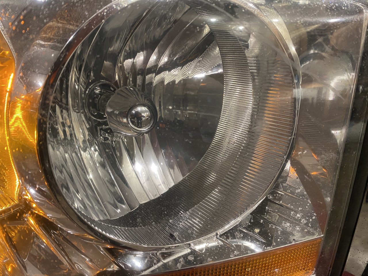

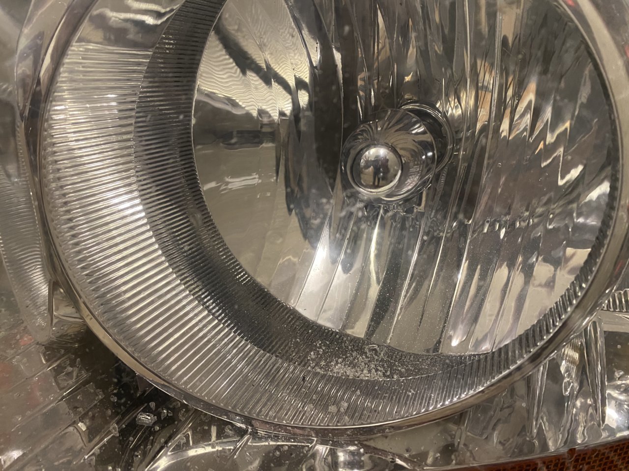

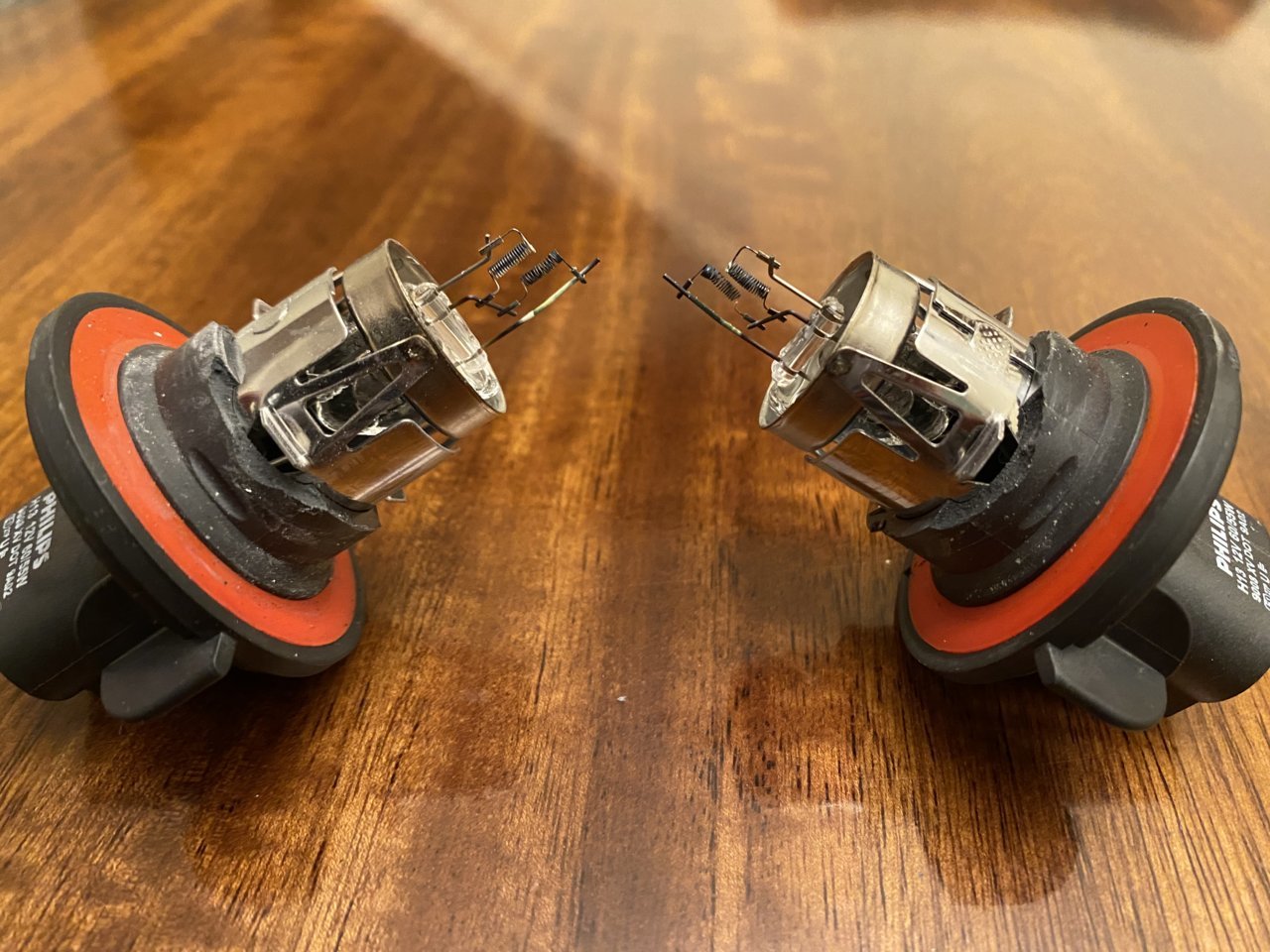

    Strange bulb abnormalities! Both my Philips Xtreme +100 H13 bulbs exploded within minutes of install.
    Back story: my Dad recently purchased a 2006 Ram Cummins 2500, it takes H13 bulbs. Looking for the best H13 I decided to test and compare Philips Xtreme +100 vs Volsa +120.
    While I planned a comparison, the bulbs ended up being a PITA to install, and required removal of the headlight assemblies to lock the bulbs in place. It was getting late so we decided to just go with the Philips for the time being. After installing both and testing they work, one of the Philips bulbs exploded. Very unusual.
    So I installed the Volsa +120 in its place and the was going to take a side-by-side measured comparison of the Philips vs Volsa, but then the other Philips bulb physically exploded in the housing, sending glass shrapnel throughout the housing.
    Baffling. Both bulbs were clean and exploded minutes after install. The socket fit at the housing was tight but not something I would expect to cause this catastrophic failure. I’ve run the Philips +100 H13s in past vehicles without issue. The Volsas worked fine.
    Before the Philips exploded I had the Volsas about 12% brighter in peak intensity, but I was still taking the Philips measurement when it failed, so it is an incomplete comparison. Frustrating as getting the broken glass out of the headlight assembly isn’t very practical.

    Northwest Indiana/Chicagoland
    The old hirs in 3rd gen avalon high beams have done that to me before. No clue what causes it.

    Going to be fun getting all the glass shards out of those housings!

    Several
    Wow, I've never heard of that happening before...especially not two of the same bulbs. My guess is there was a manufacturing flaw in those bulbs.
    Guess the only way to clear them is to remove the headlight housings and shake out the glass.
    Good luck!
