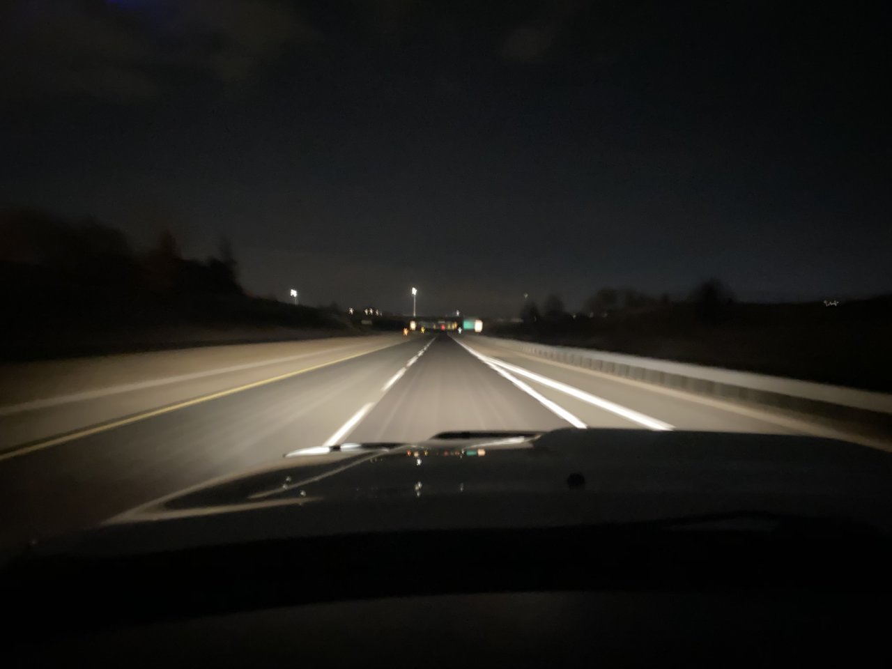

    Almost lasted a year I think, and they were used when I bough them. Should I clean the new bulbs with alcohol?

    Just bought a pack of alcohol wipes, looking forward to what a brand new set of bulbs perform like!
