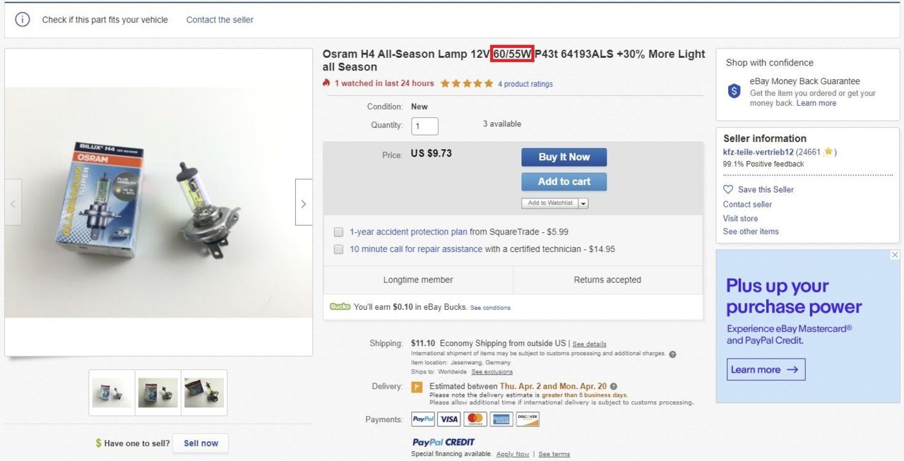

    Wow, someone not price gouging! The all seasons do produce more glare and while the warmer color temp is nice I didn't find it noticeably beneficial in poor weather use. I think I may try removing the all season coating on my next set, as I am currently running my last pair of clear Hypers.
    Edit: they are not 85/80w, disregard.

    They are. They just have the all season diffraction coating vs clear.
    Edit: they are not. Disregard.

    Not according to the ad, which lists them as "60/55W" bulbs. Zooming-in on the picture shows the same.

    Somehow missed that, edited previous posts accordingly.

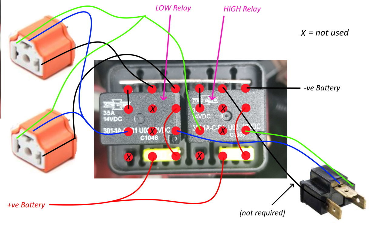

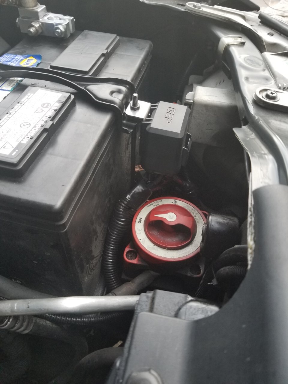

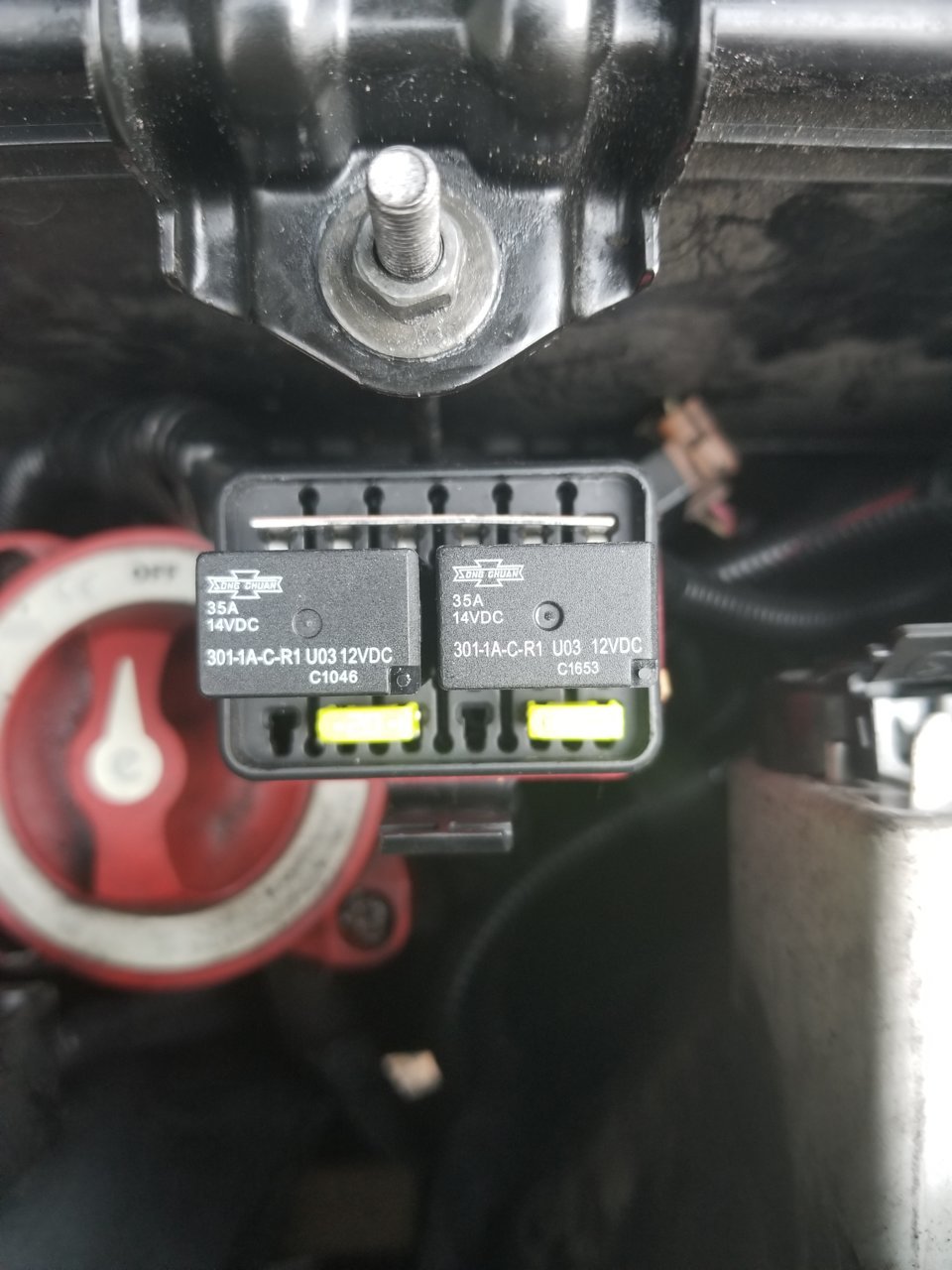

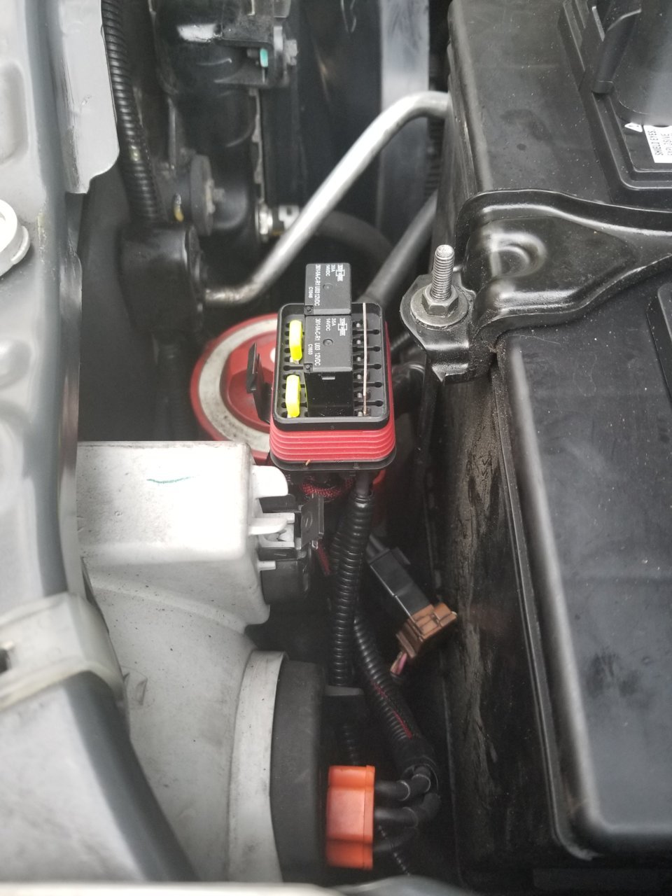

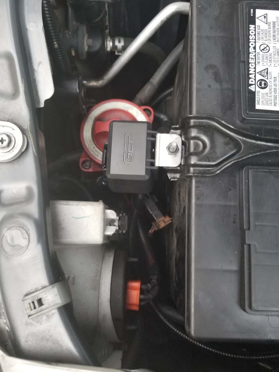

    I was/am in the middle of building an auxiliary fuse box, using this thread (https://www.tacomaworld.com/threads/diy-build-and-install-a-bussmann-rtmr-fuse-relay-block.399454/ the “Bussmann Thread”). That is another great thread that, like this post, the creator put a great deal of time into.
    Not being impressed with the light output of my headlights, this headlight upgrade mod was something I wanted to do. Having a lot of wire, connectors, etc. in my possession (using to build auxiliary fuse box) and wanting to minimize the number of unique components in my setup (the relays and fuses I used to build the harness below are the same sort that I will be using in the auxiliary fuse box), I decided to build my own harness.
    Below are pictures of the harness installed. The techniques used to build the harness are basically the same as @tacozord explains in great detail in the Bussmann Thread above. I used the techniques in the Bussmann Thread and the parts below to build my own harness. It took quite a bit of time, so if it wasn’t for wanting to use the same relays as the bussman uses, purchasing a prebuilt harness would have been a good choice too.
    Wire Diagram:
    Parts Used (see Bussman Thread above for parts not listed below)
    Common Bar 38074, 6 Gang
    https://www.waytekwire.com/item/38074/Common-Bar-38074-6-Gang/
    GEP Power Products FRH-A24 Compact 24-Way Sealed Fuse and Relay Holder
    https://www.waytekwire.com/item/38553/GEP-Power-Products-FRH-A24-Compact-24-Way/
    GEP Power Products FRH-A24-C, 24-Way Sealed Fuse and Relay Holder Cover
    https://www.waytekwire.com/item/38554/GEP-Power-Products-FRH-A24-C-24-Way/
    Aptiv 12077413 Metri-Pack Female Tanged Terminal 12-10 GA, 280 Series
    https://www.waytekwire.com/item/32035/METRI-PACK-280-SERIES-FEMALE/
    2sets 3Pin H4 Car connector plug H4 Auto holder plug 7.8mm lamp plug bulb socket
    https://www.aliexpress.com/snapshot/0.html?spm=a2g0s.9042647.0.0.79b34c4dopNHw5&orderId=8009936970462243&productId=32871898783
    https://www.aliexpress.com/snapshot/0.html?spm=a2g0s.9042647.0.0.79b34c4dopNHw5&orderId=8009936970472243&productId=32871898783
    I used 12 gauge wire for the signal wire. A smaller gauge could have been used, but using 12 gauge allowed me to use one part number for the tanged terminals, so I didn't have to buy another size. The H4 connectors from Aliexpress are fine, just take a long time (ie months) to arrive.

    I like the weather proof relay box!

    Nice, except for the Chinese relays. Recommend buying some spares (made elsewhere) for when they fail.

    Carrying spares is a good idea. Primary reason for building this was that the bussman auxiliary fuse box I am building will use the exact same relays. The bussmann will hold 5 of the same relay (doubt I'll use all 5) and this headlight harness I built will hold another 2. So I'll have 7 under the hood (excluding any I throw in the glove box). From a headlight perspective, if the LOW relay goes out, I could always just throw in the HIGH relay to get me back home.
    Here’s the datasheet for the relays above. The mechanical life expediency is 10,000,000 cycles and the electrical life expediency is 100,000 cycles. As the electrical life expediency is lower, let's use that for our math: 100,000 operation life / 6 operations per day (a number I chose assumes lights are turned on/off 6x per day on average) / 365 days in year = 45 years. So if the datasheet is accurate, I'd expect the relays to last 45 years. I wouldn't bet any serious money on a 45 year life, but based on what the manufacture 'claims' (emphasis on 'claims') in the data sheet these relays should work fine. Again, agree on the need for redundancy/spares.
