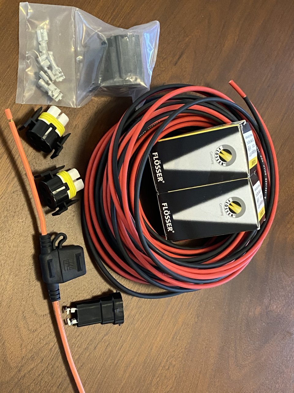

    You could always make your own. I am still waiting on a relay and some pins but will be doing a write up in the Ultimate Foglight. Besides a heat gun and a crimper no special tools are needed.

    You could also see if Rallylights will build a shorter version of the fog harness if you really wanted to go that route.
