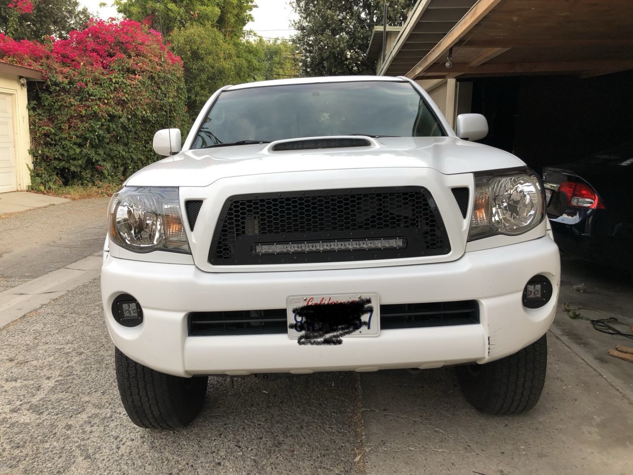

    Installed the OEM sport smoked headlights and philips racing vision bulbs. Super happy with them over the garbage spyder knockoffs that we’re on the truck from PO. Going to eventually replace the stock wiring and better bulbs.

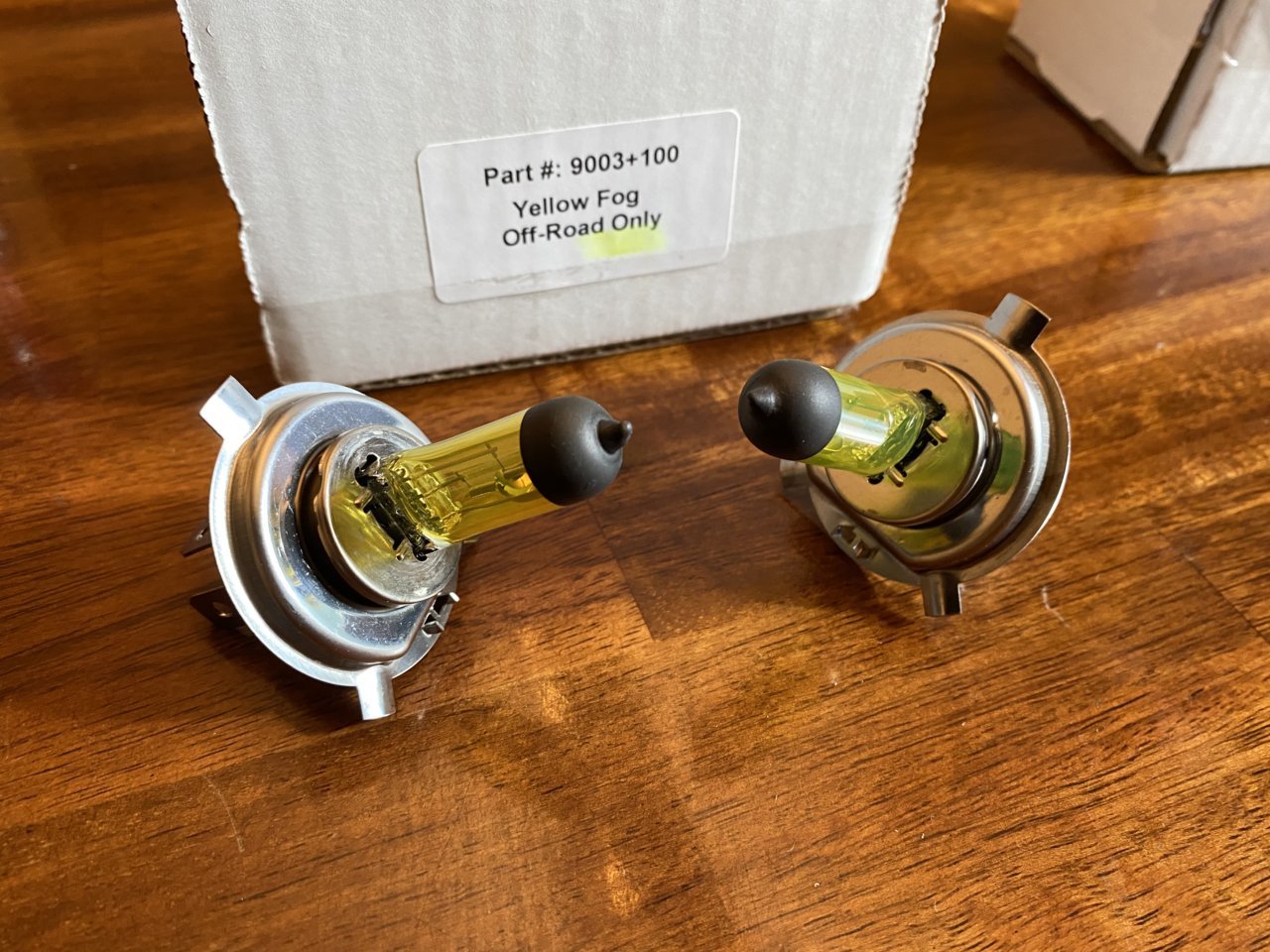

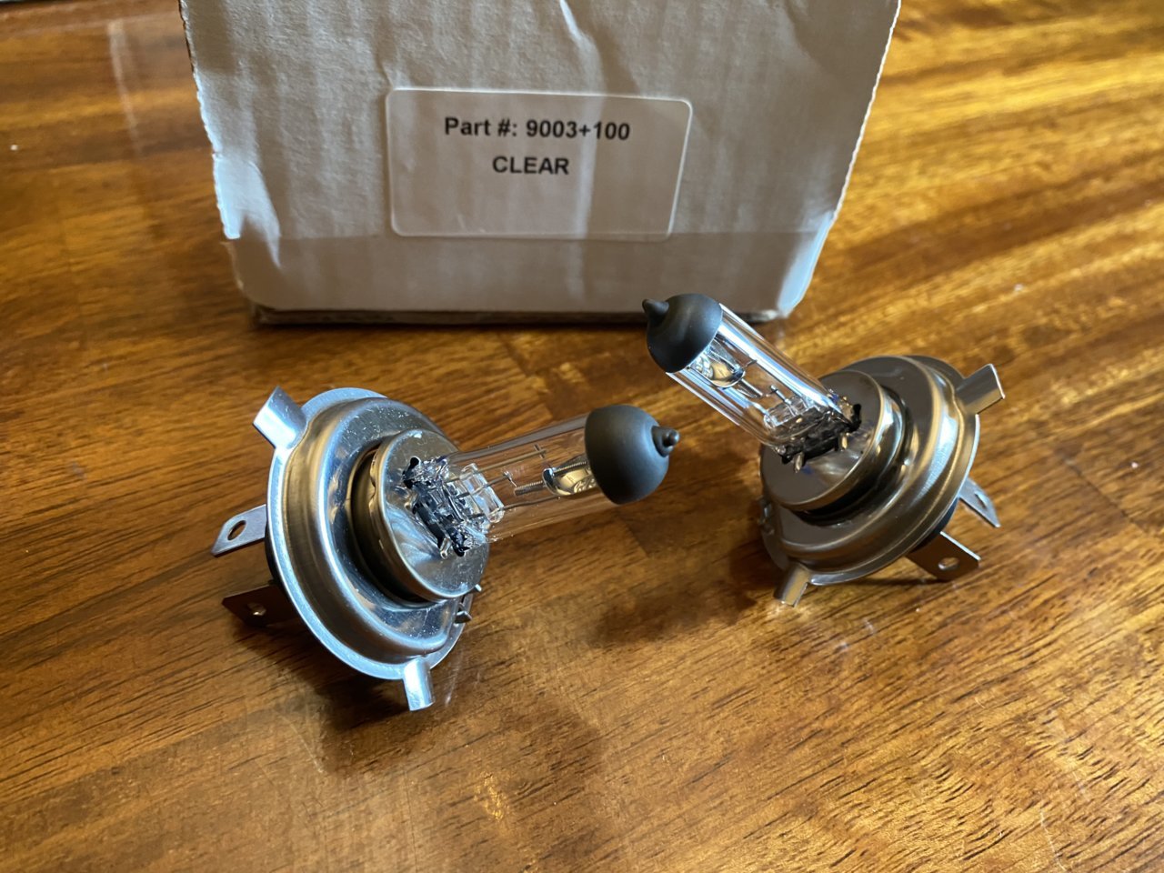

    I just picked up two pair of these and a third pair of the selective yellow bulbs! They literally arrived today. I was going to pm you if you wanted a set to test
