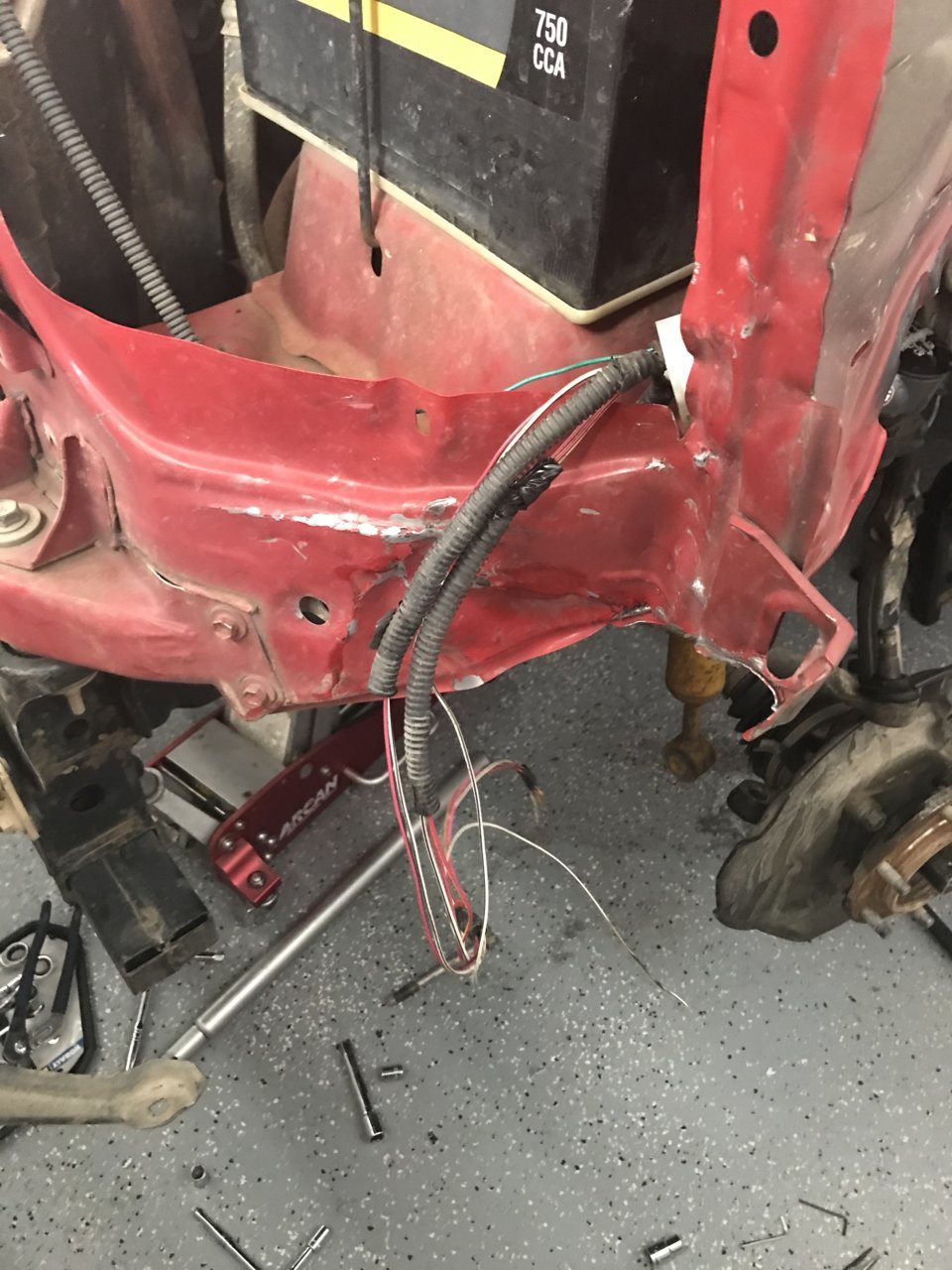

    Wrecked my truck and it ripped out the whole headlight and all the connectors on the drivers side. Should I just buy new connectors And wire those up or move forward with the harness upgrade? What new headlights (preferably aftermarket to save money) do you guys recommend? Kind of want to try a projector headlight but this thread makes it seem like a bad idea

    The best headlight assemblies are OEM. Large reflectors like the 2nd Gen has are the highest performing type of assemblies, much higher performing than a projector. See how the large reflector 2nd Gen assemblies compare to the 3rd Gen OEM projector assemblies here.
    Note that aftermarket projector headlights will be junk, and far worse performing than the Toyota OEM projectors which are significantly outperformed by the 2nd Gen headlights.
    Do you have the upgraded harness? If you intend to use one just wiring on any basic 9003/H4 plug to the OEM harness will be fine, as it won't see any load, it will just be a 12v trigger for the harness relay. Cheapest option for good headlights is going to be watching the 2nd Gen marketplace section for some good condition OEM takeoffs when someone makes the mistake of switching to cooler looking aftermarket lights.

    Not yet. Trying to figure out what I'm going to do in regards to fixing existing harness with Rockauto connectors, or bypassing it completely with upgraded harness.

    The harness only applies to the headlight bulb, not the rest of the bulbs in the assembly. And for the harness to work you still need a 9003/H4 plug on the OEM wires unless you want to cut off the harness connector and hardwire it, but I wouldn’t recommend that. So regardless you’ll need to replace the connectors.

    Thanks. I appreciate your help. Any recommendation on best connectors to buy? Never had a problem with the OEM ones but don't mind upgrading while I'm in the process of fixing

    No specific recommendation, something by Dorman available at many autoparts stores should be fine. I saw Ford Motocraft also sells connectors. No need to upgrade the connector though if running the harness, since the connector doesn't really see any load.
    The first post is constantly updated with all the relevant info, so no need to scan all the pages. Headlight Services is the way to go, the build quality is top notch.
