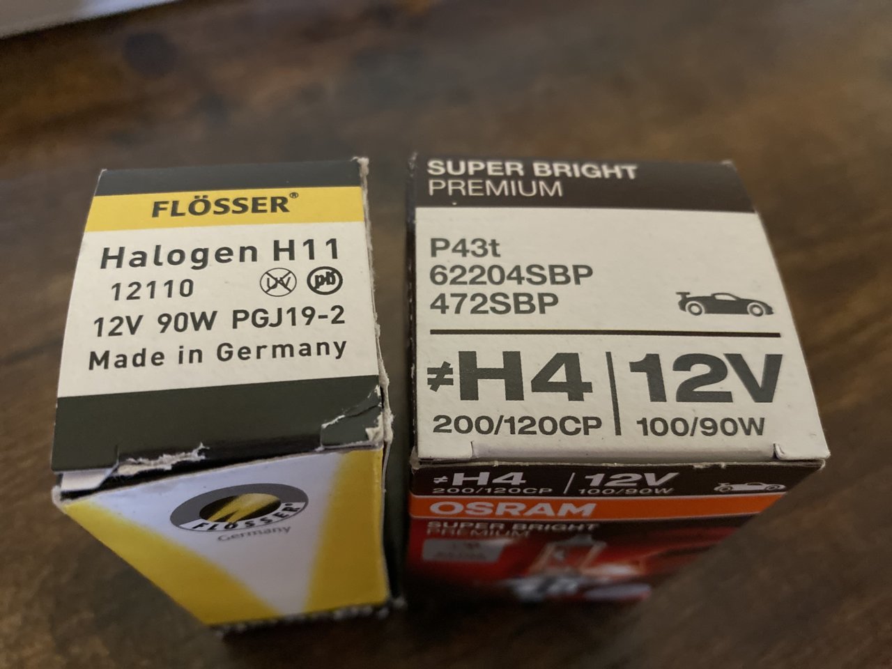

    For the Headlights I am using Osram Super Bright Premium 12v 100/90 P/N 62204SBP and for the Fogs I am using Flosser 12v 90w H11 P/N 12110
    Both are German Made.

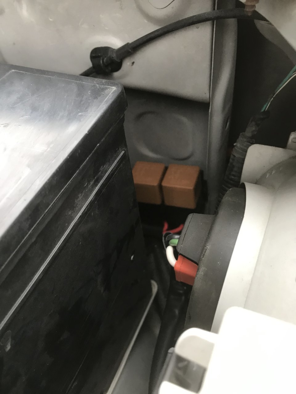

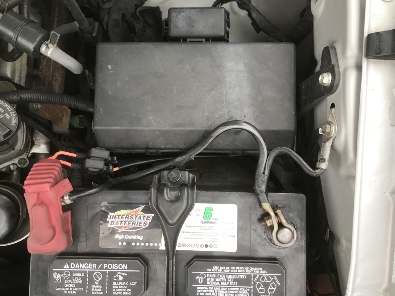

    I just installed the Headlight Services harness yesterday. As mentioned many times an Excellent product. I installed the relays on the driver fender just in front of the battery. Plenty of room and accessible. I connected the ground directly to the body mount at top of fender hood and ran the positive behind the battery and up into the red protective cap. Very neat and tidy. I installed a pair of Hella 100/80 H4 bulbs that I had from my old BMW motorcycle for now.
