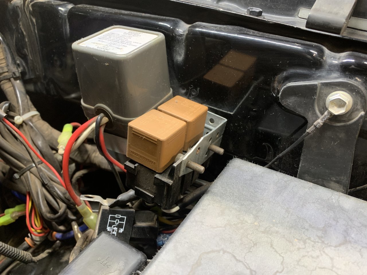

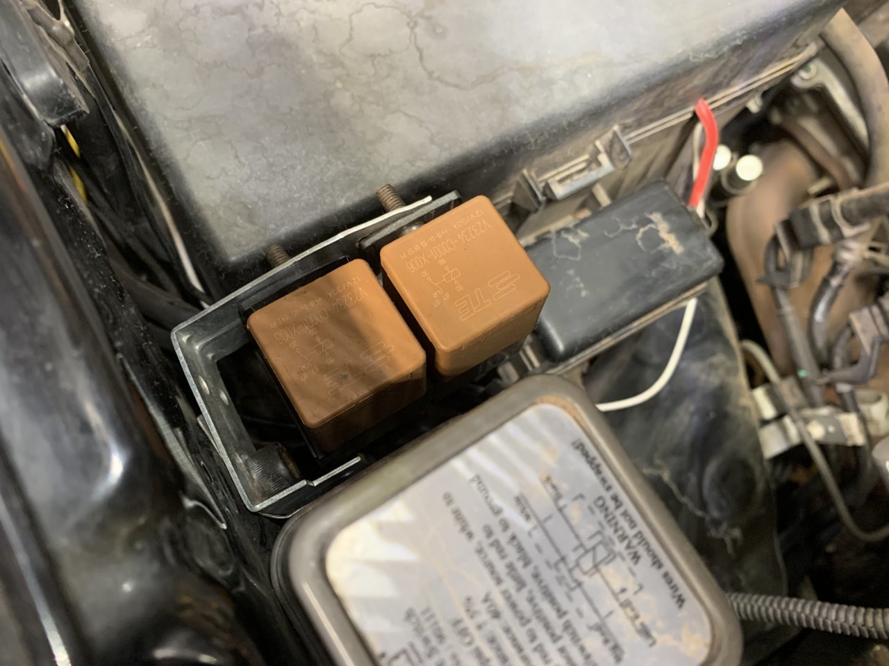

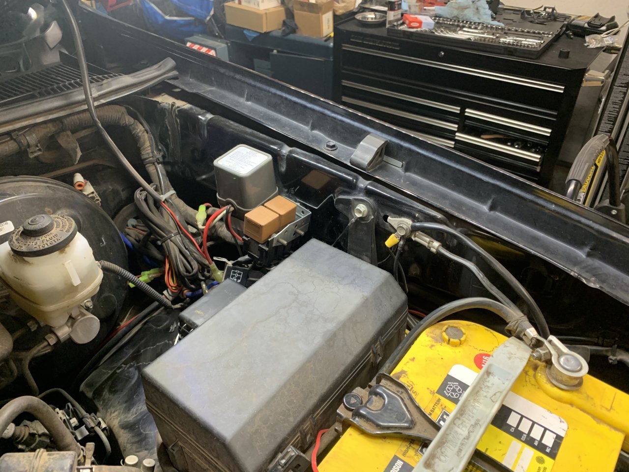

    Here are some pictures of what I did to mount the relays using the two threaded holes on the side.
    I found some scrap metal laying around (I think from a ceiling fan and install that I did in the house) and threaded and tapped a couple of holes so I could mount the relays onto this along with the new 90° bend.
    Prior to the relay harness I was using those two threaded holes to mount my OnBoard Air relay switch. This homemade bracket allowed me to mount my relays without moving my OBA relay.

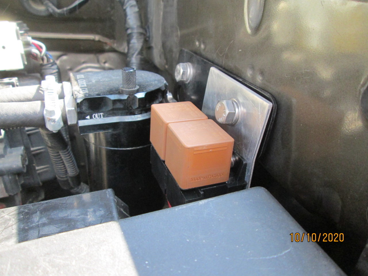

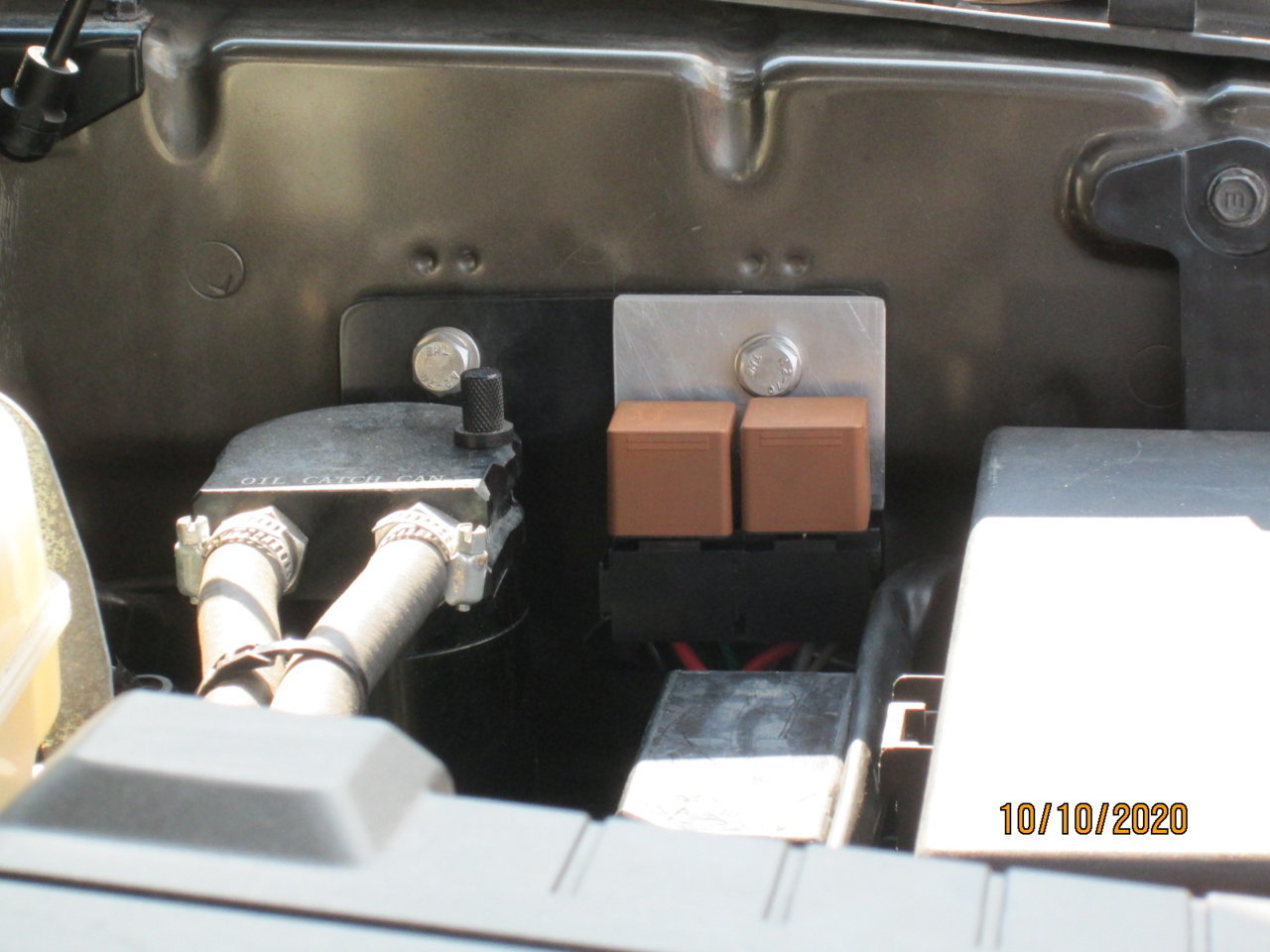

    Thanks for all the pictures and ideas! I mounted the relays alongside my catch can. When I fabbed the mounting bracket for the catch can I made duplicates in the eventIMG_4125.jpg IMG_4126.jpg IMG_4127.jpg I made a mistake or needed to make a change. I used one of the duplicates and cut it down in both width and length so it would piggyback on the catch can mount. Very solid. I will at some point paint the mount but that's down the road.

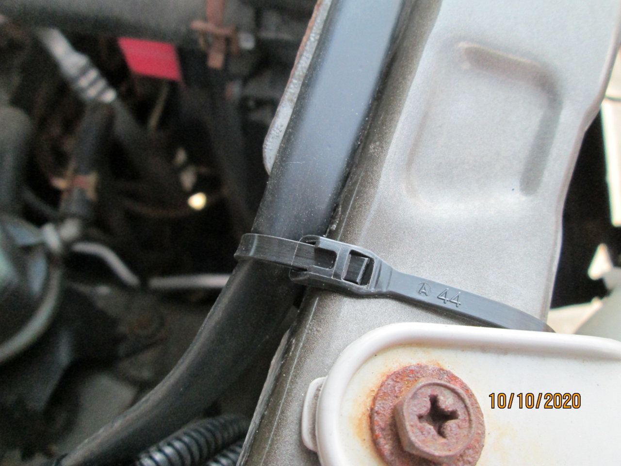

    Being that I'm OCD about wiring, I hate using the standard wire ties. Instead I use Cobra low profile wire ties. They are smooth as silk and have no sharp edges when the excess is cut (although I do use flush cut pliers).

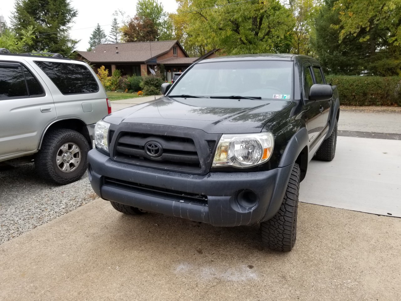

    Fixed up my parent's '10 tacoma driverside headlamp today, using the same method/materials.
    The driverside had been polished repeatedly over thecpast few years, but my dad had just topcoated with whatever wax product came with the kit he used, so it inevitably always faded/crazed in short order.
    Edit- and of course if had to start to rain...
