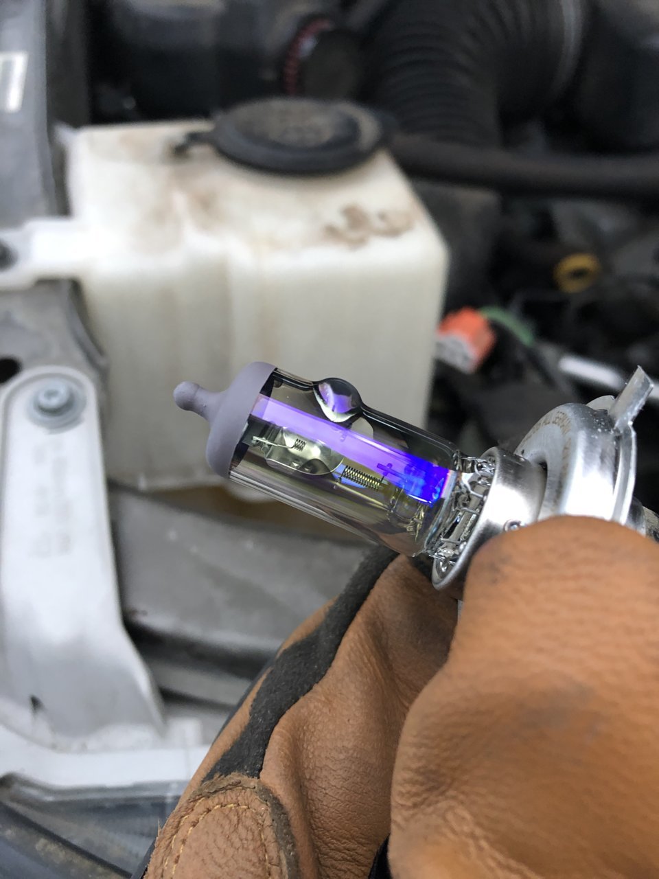

    About halfway done...
    Figured this is a good thread to give an update. I installed the wiring harness and all season bulbs around 3/23/19
    Then added the voltage booster. Start up voltage is around 14.2
    The passenger bulb burned out 8/31/20. ( Quick burn out on start up, see photo)
    So about 1 year 5 months
    Funny thing is the performance of just the driver headlight was more than sufficient for night time driving.
    I decided to replace the passenger bulb with a stock bulb. Then when the driver all season goes out replace both with new all seasons.

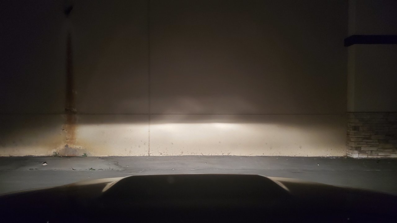

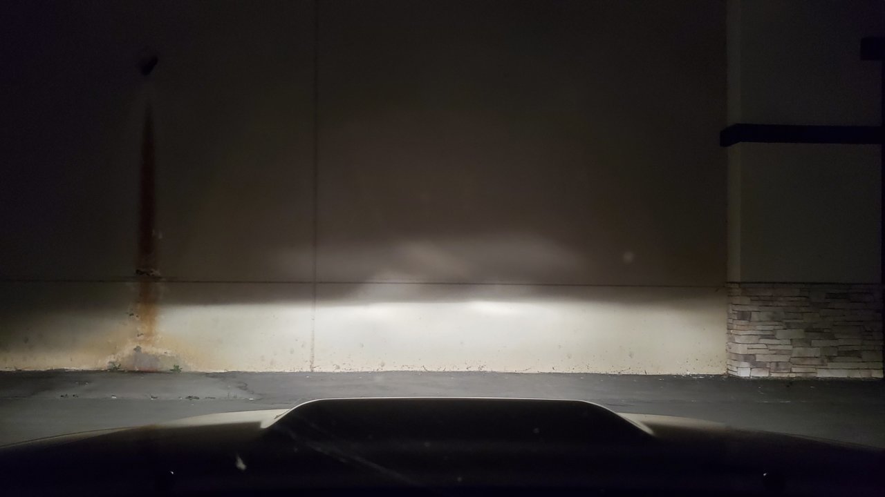

    Took the truck out after dark tonight. Heres the before and after on a loading dock wall.
    Before
    After:
    Went on some real dark backroads and they were super mpressive. It might be a while before I can check back in with a thorough opinion. First impression is really good tho.
