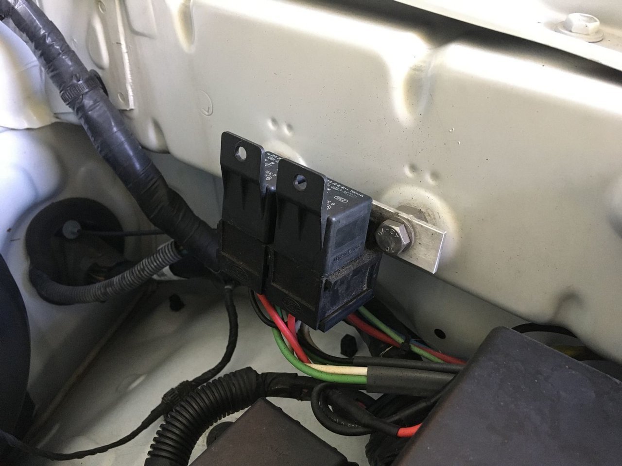

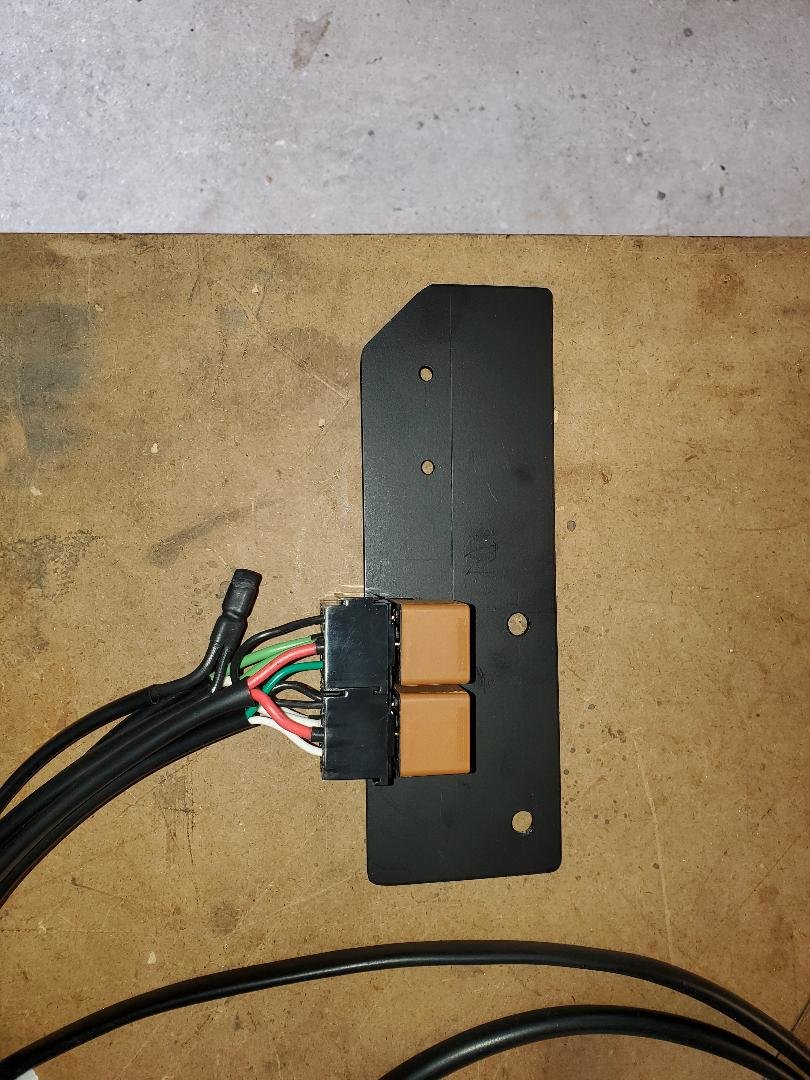

    Got the Headlights Services harness and Osram bulbs installed today. Still have another hour or so until it's dark enough to really see the results. Whipped up a quick bracket to install the relays on that is sandwiched between my aux fuse panel bracket and the inner fender.

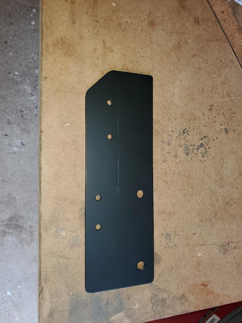

    Front: Extended Travel 2.5” King coilovers with/adjusters (Set at 3” lift) Rear: 2.0” King shocks with adjusters Icon RXT (Option 2) Pack Toyota TRD Cat-back exhaust AnytimeBackup Camera Anytime Front/Rear Camera RCI Sliders KB Voodoo Bed Rack Center Console Ram Mount

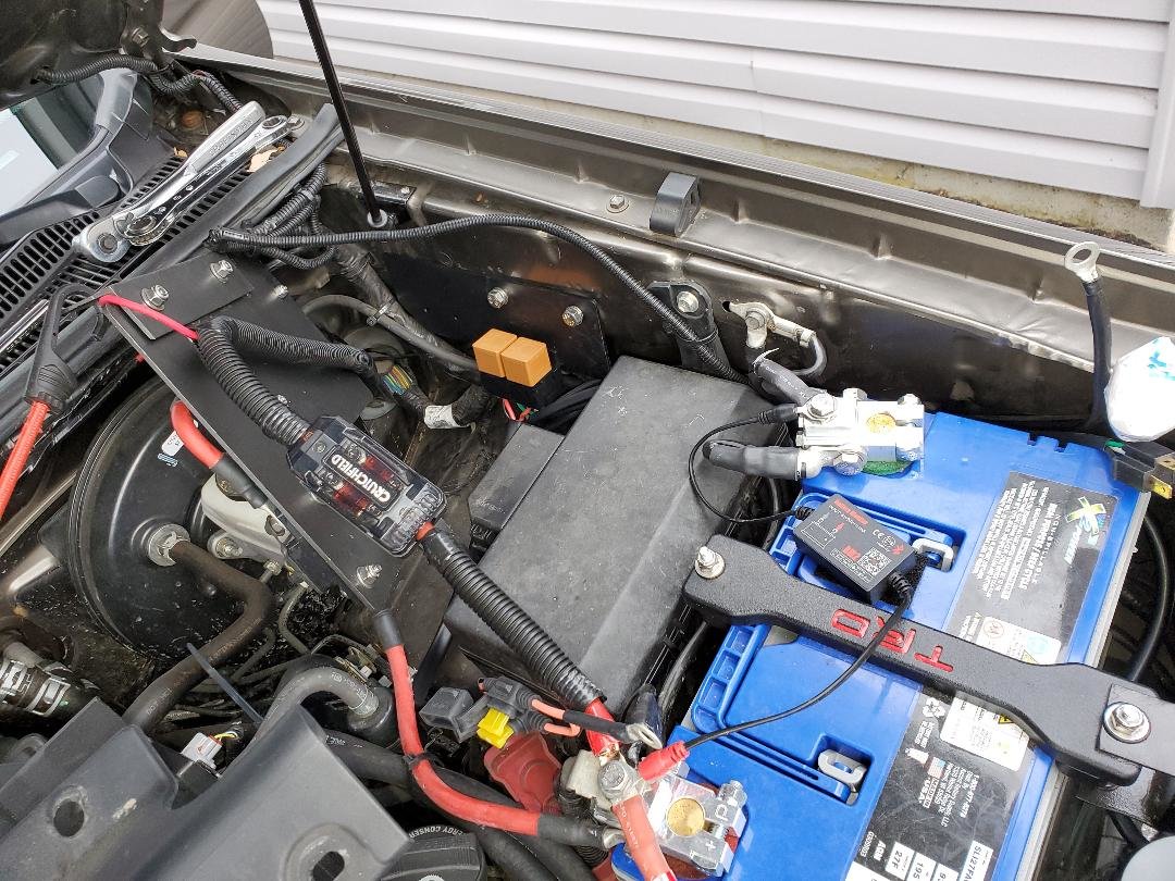

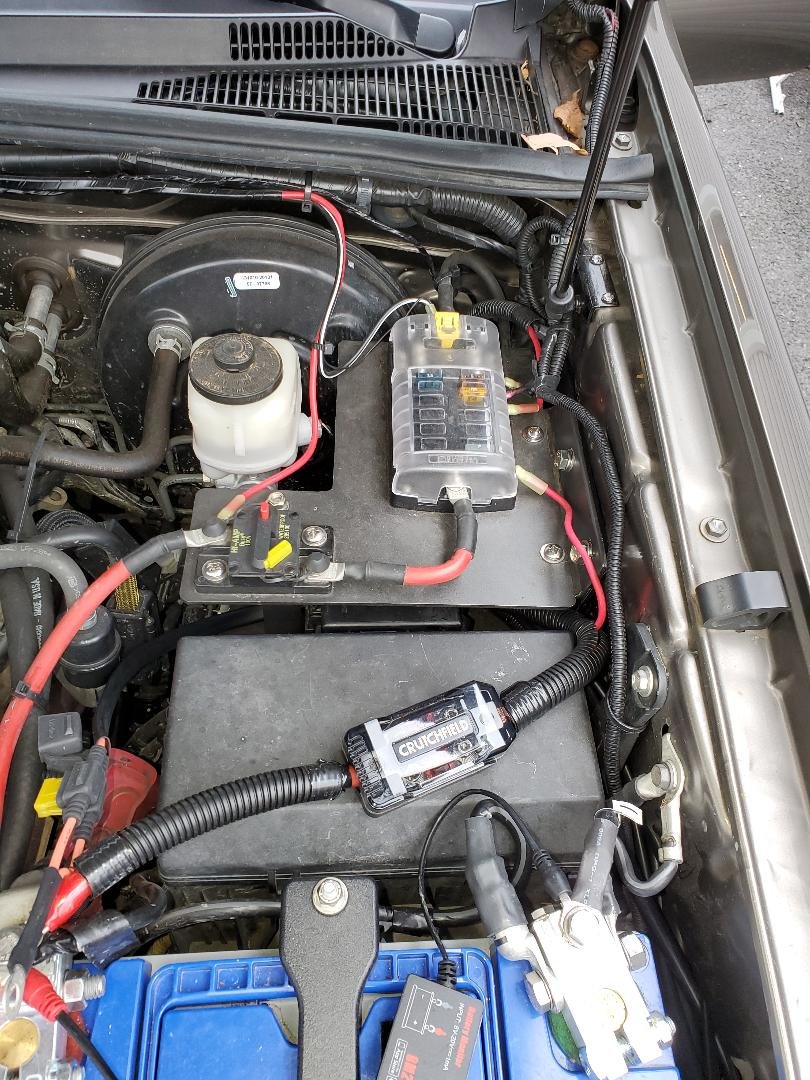

    Remember the thread pitch/diameter for the appropriate bolts for these holes? Thanks in advance.
  19. Dec 1, 2020 at 3:08 PM
    #3219
    Too Stroked
    Too Stroked Well-Known Member
    Jan 24, 2017
    #208501
    3,924
    Tom
    South shore of Lake Ontario
    2021 4Runner SR5 Premium
    Unfortunately, no. I just rummaged through my metric stash until I found two that fit. BTW, the larger nuts you see are just used as spacers to get the bracket away from the inner fender.

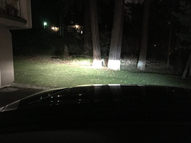

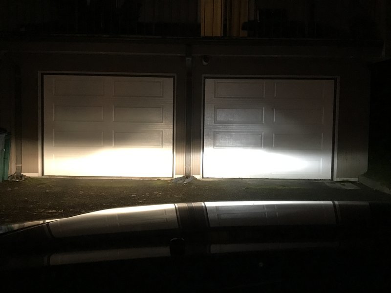

    When running LEDs in a reflector, one of the points often overlooked is the smoothness of the pattern distribution. I refer to this as 'pattern saturation', where the beam pattern should be fully saturated with light in an even distribution out from the hot spot. But using LEDs in halogen assemblies causes significant alterations to the light distribution since they do not uniformily illuminate the reflector, and some parts or the reflector are left dark. I think this is actually the largest challenge for replacement LEDs in halogen reflectors as the light distribution is not nearly as smooth or well distributed as the halogen counterparts, since they are not an omnidirectional light source, leading to undesirable splotchy beam distribution patterns.
    Take a look at these pattern examples run in a late model 2nd Gen Tacoma light (each running one headlight):
    Philips X-tremeUltinon Gen1 H4 LED
    Philips X-tremeUltinon Gen2 H4 LED
    Stock standard OEM Osram H4 (yes this is one headlight)
    Peak lux readings were higher in both LEDs vs the stock standard OEM bulb at 18', I didn't run a 42' test as I often do to get a more accurate reading for LED focus. But the LED light distribution is poor and the pattern is highly irregular. The Gen 1s have a tall but narrow pattern, and the Gen2s have a much wider but shorter pattern. Whereas the stock pattern has outstanding uniform smooth light distribution and is a far better beam pattern with more coverage. Peak lux in this case is highly misleading. And then look at the cut offs, stock has a very nice flat cut off all the way across the beam, whereas the LEDs do not provide the same broad flat cut off line. The camera settings for light control were not the same in each photo as I was trying to capture the strange patterns from the LEDs, so it isn't the most accurate representation of output. I should have spent more time on it.
    When the Gen1s first came out, they were one of the first ones with glare guards, significantly reducing glare from what other brands were selling at the time.
    Here is an old test pic of the Gen1s. I wish I had done a better job on capturing beam quality and not washing out the photo so much.
    Ultimate vs Philips Gen1 LEDs
    Here is an old output shot, Ultimate upgrade vs Gen1 LED
    Rather than the LEDs, I'd recommend trying the Philips Racing Vision +200 for a whiter light covered in post #3169. The Racing Vision +150 has nearly identical performance but half the bulb life. They are the whitest performance halogens in the thread and have the best low beam performance which will be far better than the Philips LEDs. They won't be 6000k LED white though. Being in Canada too, a halogen will produce heat to resist your headlights freezing over whereas an LED will not. I'd offer you to sell you mine, but with having to go across the boarder it is probably easier to purchase online.
    MrFixit420, DoulosXP and EdgemanVA like this.
