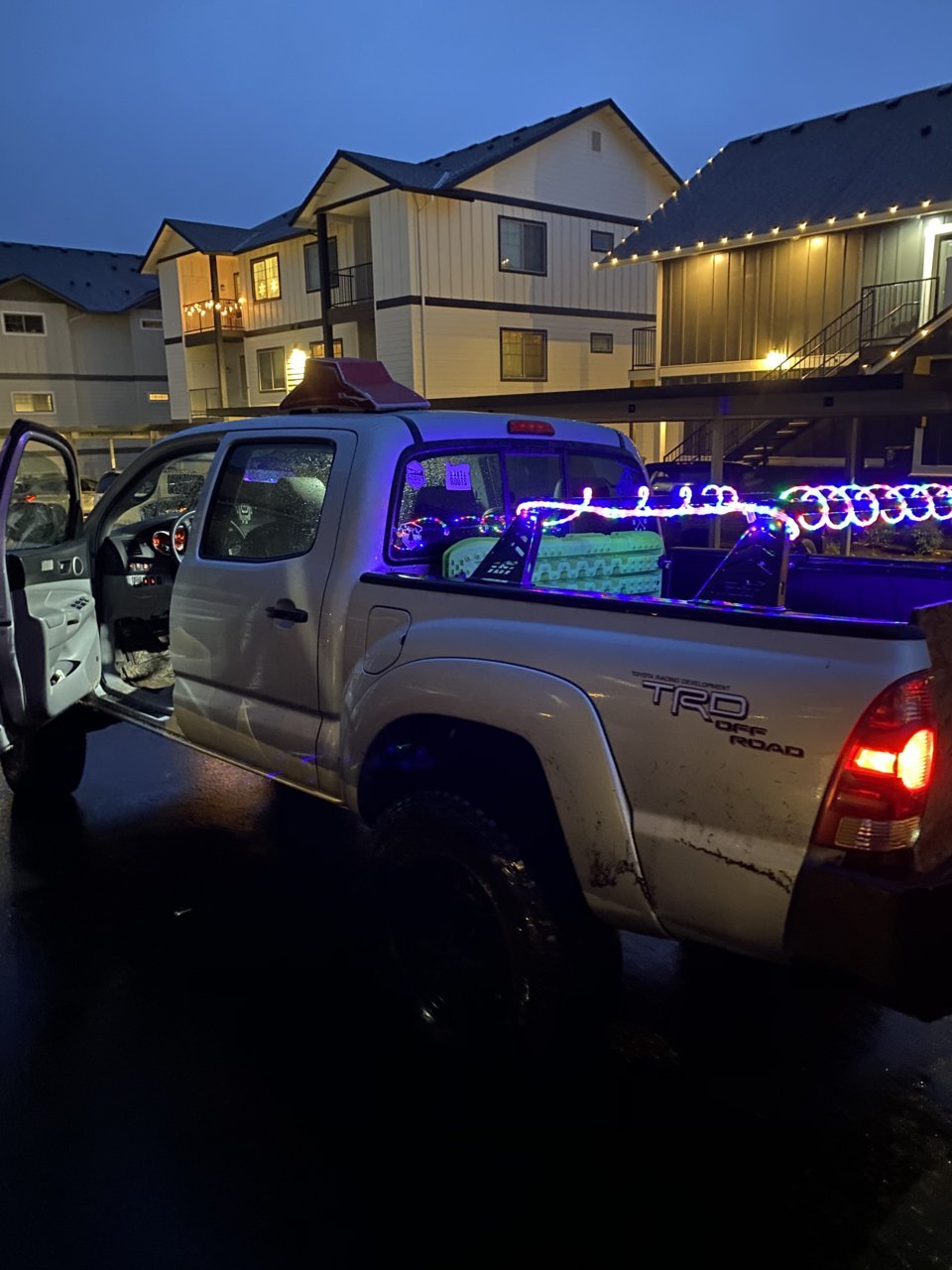

    Got the harness and the bulbs in the mail yesterday had no time to install today so will be installing sometime this week I hope if I got time I also have my fog lights that are supposed to come in Tuesday also. Lots of lighting project including adding a little color to my bed racks during the holiday season

    Note to be legally compliant your Christmas lights must be white or yellow. ;) :cheers:

    I’ll let the police departments around here give me a warning before I take them off LOL

    There’s a dude running around my city with a full fledge lit up Christmas tree in the back of his truck I think I’m OK LOL

    Lol! Just some lighting humor. But every year it seems one person on TW gets stopped for colored Christmas lights, I’d say your chances are pretty low, but never zero. :)
