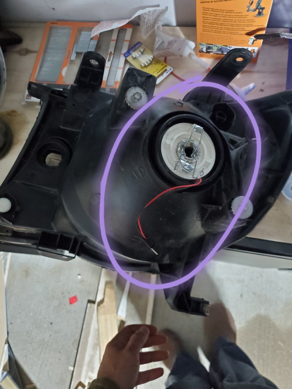

    Can someone tell me what's that wire coming out of the projector headlights??

    If it’s a bi-xenon projector, it’s the high beam signal wire that triggers the internal hinge to enable high beams
