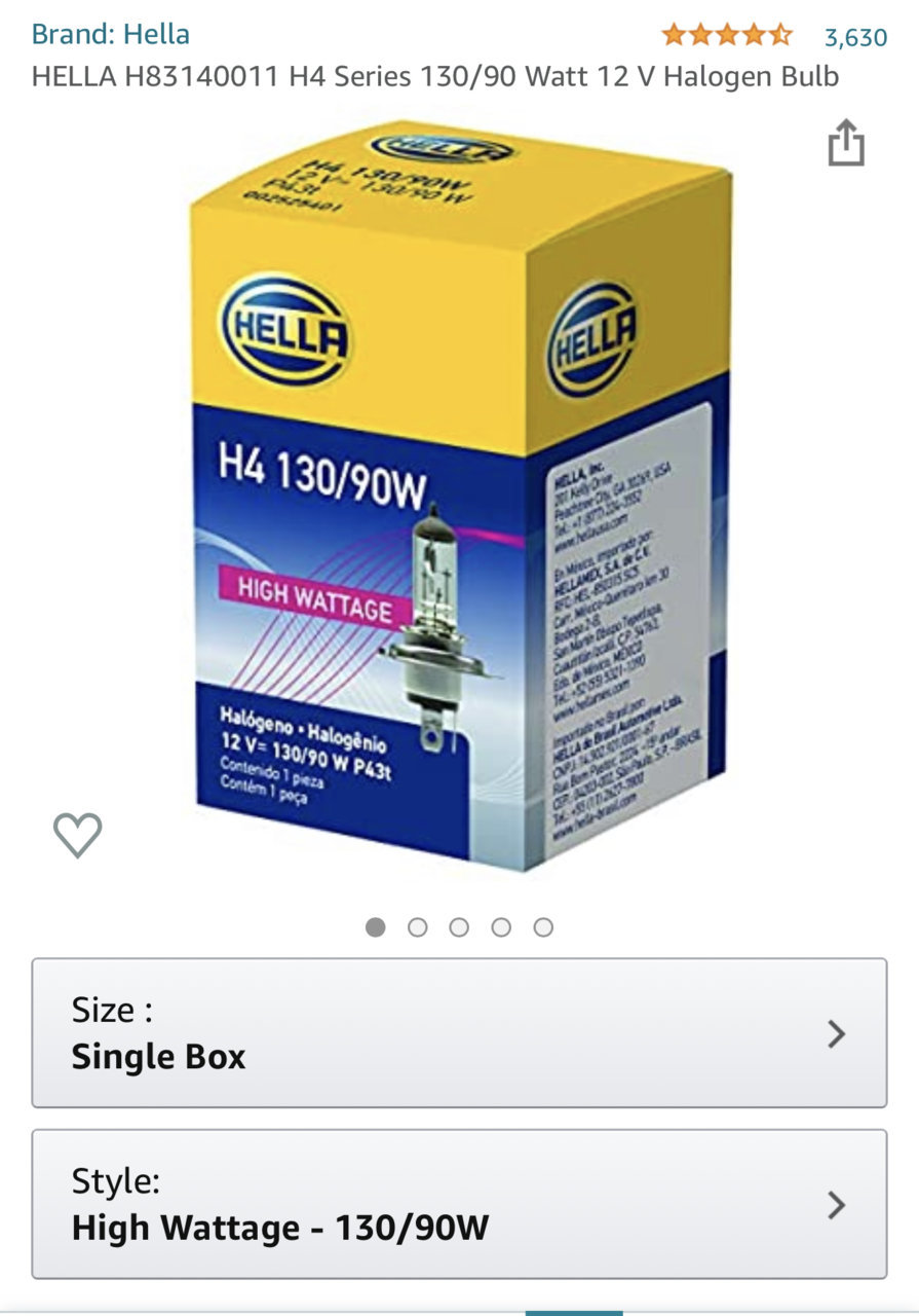

    Has anyone had luck with these?

    First post has them tested. They did poorly.
    TegoTaco[QUOTED] likes this.

    No problem. The Osram 100/90w isa good bulb. The highbeam is phenomenal. While I was running them I never felt the need to use my Cibie Super Oscars for extra light on high beam. The lowbeam is definitely brighter than a standard 60w lowbeam throughout the beam, but I honestly prefer the lowbeam from a philips xtremevision +130/+150 to the osrams 100w low beam.
