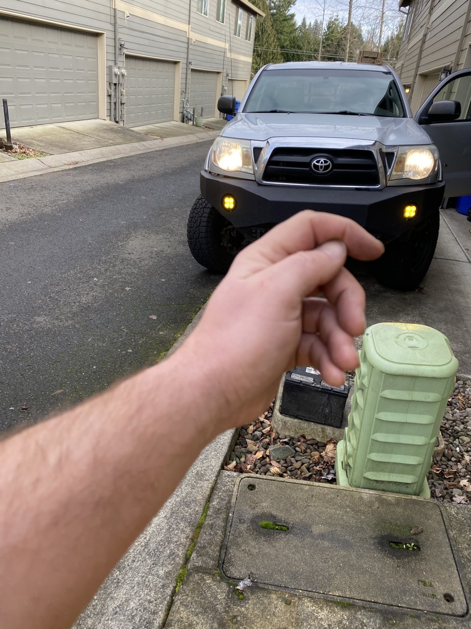

    1C526105-57C3-475A-A433-E4A06774F52E.jpg @crashnburn80 any idea what would cause this? Lost both low beams at once. Not the relay, I replaced the bulbs and the lows work.

    @crashnburn80 will correct me as necessary and he can certainly speak to it in more technical detail, but I don't see anything that unusual here. It's common for these bulbs (when installed simultaneously) to fail simultaneously (or close to it). I've also seen several bulb failures that look similar to yours.
