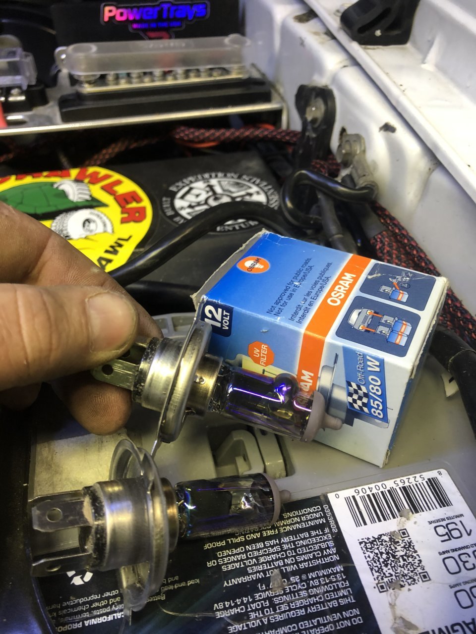

    I had two Philips Extreme Vision Plus bulbs fail at the same time . When I switched it on only high beam worked

    Blistering above the low beam filament is common on the 85/80w hyper bulbs. The original hyper bulbs use glass and not quartz like newer bulbs, including the prototype 2nd generation hyper bulbs. Simultaneous bulb failure is also common in high quality bulbs, as that indicates both bulbs were nearly identical in production and therefore lasted an identical amount of time.

    Ok, it’s the second time I’ve had Osrams fail with minutes of each other. I just wanted to make sure with the blistering and failure were not possibly something else going on. I had to drive home 30 miles last night right after sun down and felt like the worlds biggest asshole having to use my highs not something I want to do again if I can help it. The first time I had the double failure I was pretty close to home and it was later at night.

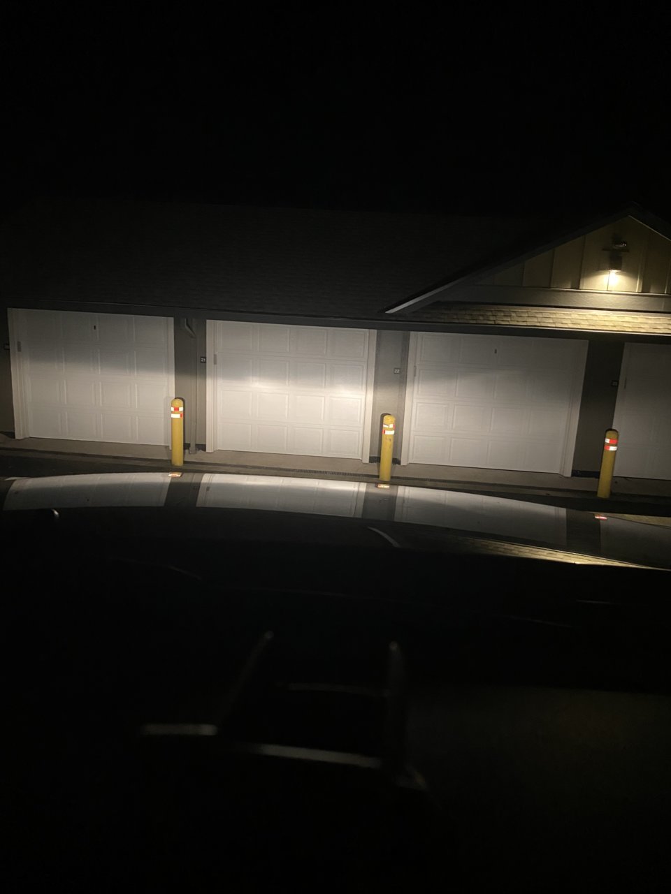

    I have had 4 people flash their lights at me as if my lights were to night so far....

    Best practice there is to carry a spare set of bulbs in the glovebox.
    Unsure exactly what you are saying, but sounds like you need to check that your bulbs are seated properly and the headlights are properly aimed.

    Sorry that’s suppose to say bright. Not night. The bulbs are seated properly. I’ll probably have to adjust

    Check out the table here, you should have a 2.1-3" drop at 25'. Best way to do this is find somewhere flat with 25' from a wall, pull the truck right up to the wall, mark the cut off line with tape. Then back up 25' and adjust the headlights to meet the 2.1-3" drop based on your height from the table. Changes to suspension/heavy bumpers can change your aim height, and what might have been mildly annoying with stock bulbs to oncoming drivers could now be excessively glaring with the upgrade.
