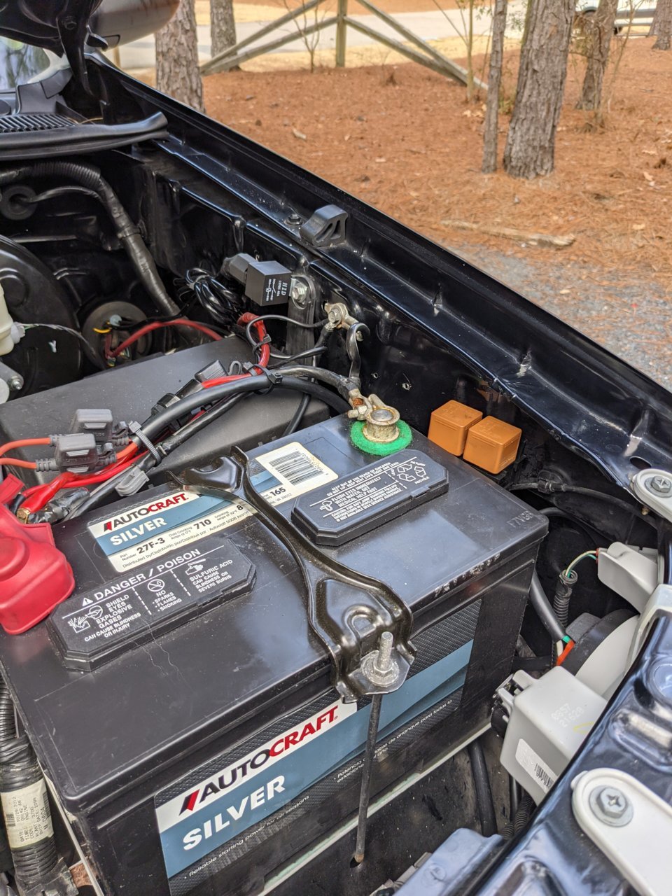

    Installed the upgraded harness from Headlight Services today. I mounted the relays off to the side of the engine bay using two self-tapping screws and ran everything else accordingly. I left in the crappy Sylvania Silverstars for now just to see how much difference the harness alone will make. I have a set of Osram 100/90 bulbs in the garage that I might switch out this weekend. I plan on cleaning up the wiring when I get new battery terminals. I apologize for asking so many questions on the topic over and over again, I sometimes get like that with things. Probably won't be the last time. :hattip:
    I also wanted to point out how good the quality of this harness is. I was immediately impressed by the gauge of wire, the solid connections, and the fittings and plugs. I'm not sure how it compares to other harnesses out there, but the one made by Headlight Services is very nice!
