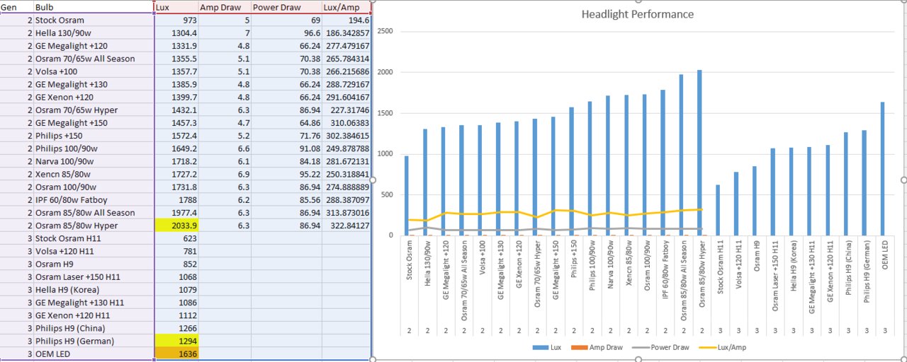

    Checkout this post combining my 3rd Gen projector and 2nd Gen reflector headlight data in a combined chart. 2nd Gen for the win.

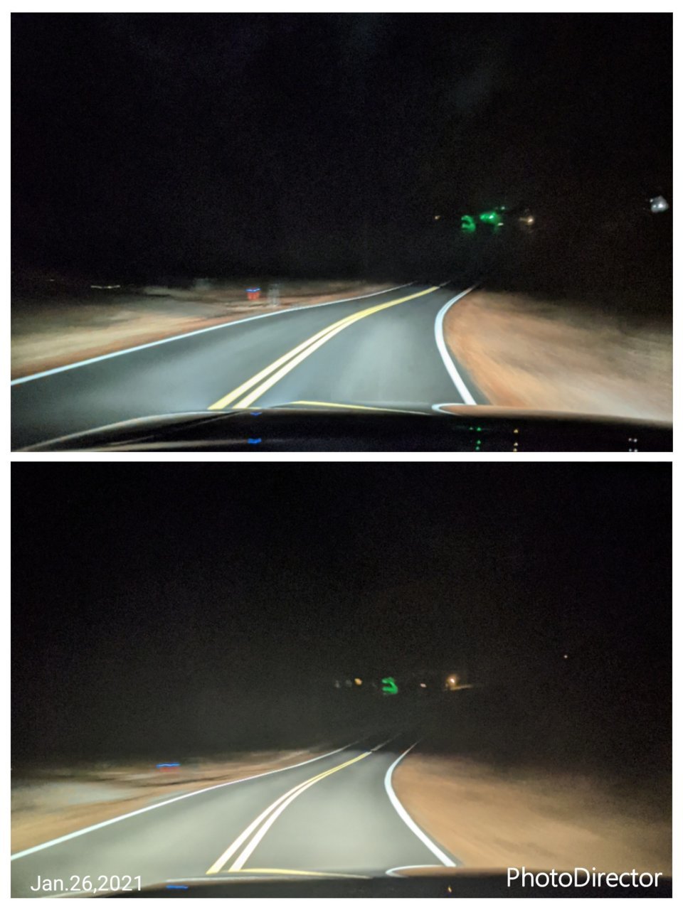

    I installed the Philips +150 Racing Vision bulbs today. (The design of the clips holding in the bulbs sucks BTW). The Philips are noticeably brighter than the Sylvania Silverstars, and they have a much more distinct cutoff with a wider peripheral throw than the Silverstars (Especially to the right side of the road). The top photo are the Philips +150 bulbs in new OEM housings with a HD wiring harness with only low beams on. The bottom is the same except with Sylvania Silverstar bulbs. I really wish I picked a different location without the grade and curve in the road because I feel like it gives it a premature light cutoff compared to what I see on a straightaway. Anyways, I'm very pleased with this setup and have no additional plans to mess with it.
