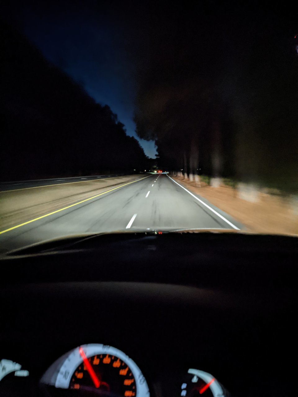

    Another view of my setup on a clear night. You can see how distinct the cutoff is by the trees on the right side of the road. I think the camera is exaggerating the light a bit, but you get the idea.

    crashnburn80

  6. Jan 28, 2021 at 6:41 PM

    LOL, I had the same thought. Especially with high color temp LEDs.
