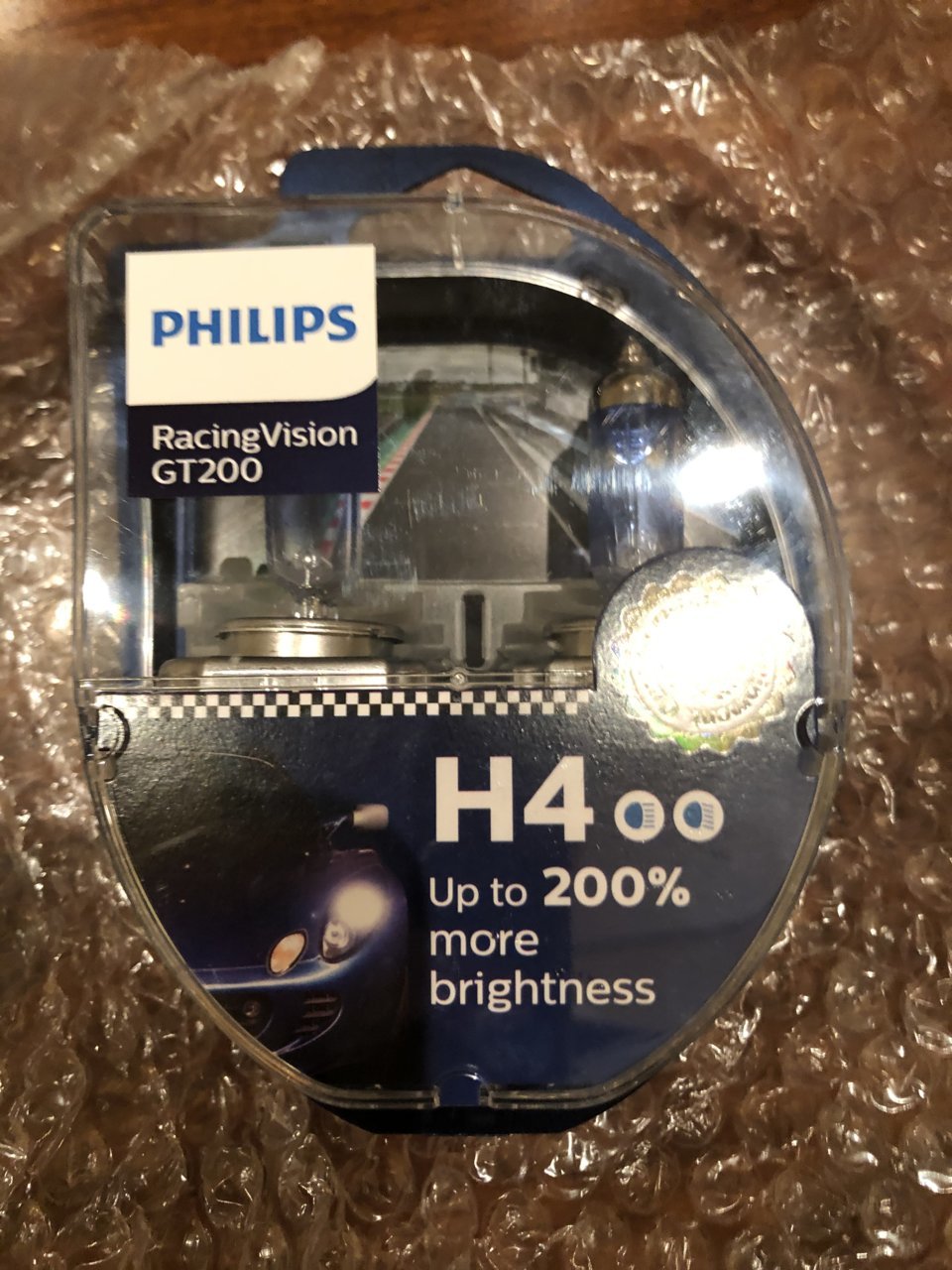

  20. Feb 6, 2021 at 7:48 PM
    #3560
    Georgeth1022
    Georgeth1022 Well-Known Member
    Nov 1, 2014
    #141491
    1,181
    Shaun
    West Hills CA
    2013 BAJA w/ too many mods
    Too many to list
    So I’ve been lurking on this thread for a long, long time now. Already ordered the TRD pro headlights long ago, they look great on my truck. Just ordered/received/installed the Orsam 100/90 bulbs. Also ordered the new Headlight Services harness, has not arrived yet but soon. Will install ASAP when it arrives. Honestly, I do not really see a huge improvement with these new bulbs yet over the factory ones. Even without the harness installed, should I see a big difference? And will I see that big of a difference with the new harness installed??
