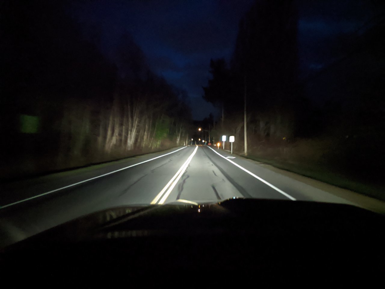

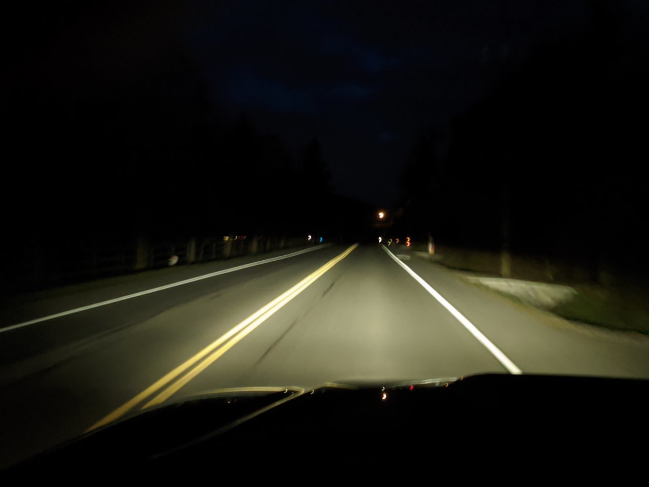

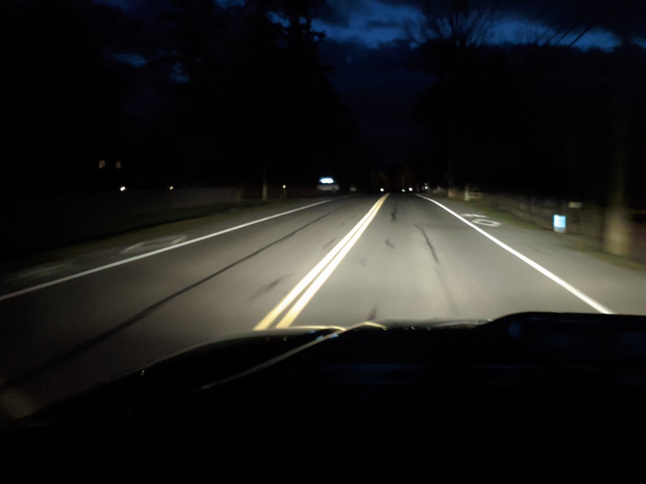

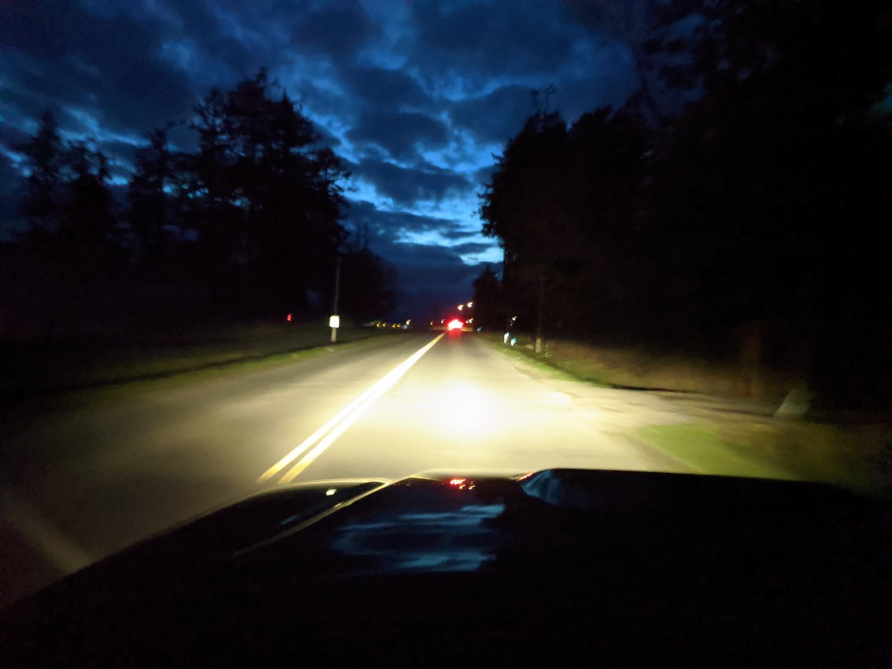

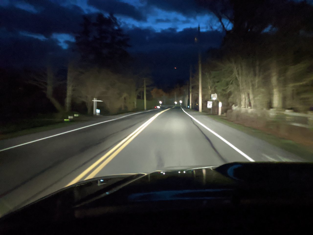

    I took some photos tonight
    Low beam
    High beam, you can see the roadsigns on the left in the distance
    Low beam
    High beam
    Low beam
    High beam, the red "light" on the right is the reflection from a roadsign, the others as well, no lights here, only signs being lit up by the Superbrights probably a kilometer away
    @crashnburn80

    What are your driving thoughts/impressions? I don’t think you have the Hypers though as they have been discontinued for a long time, I believe you have the Superbrights.

    Driving impressions is better visibility especially on both sides of the road on low beam.
    It is very helpful as Blacktail deer tend to be active just before sunrise and just after sunset.
    Now the area next to the road where they tend to be in just before running in front of you is brightly lit.
    You also see cyclists sooner
    It makes driving at night much safer
