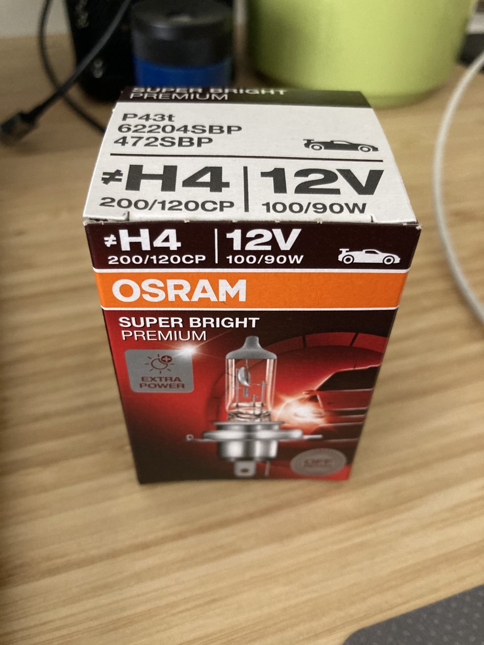

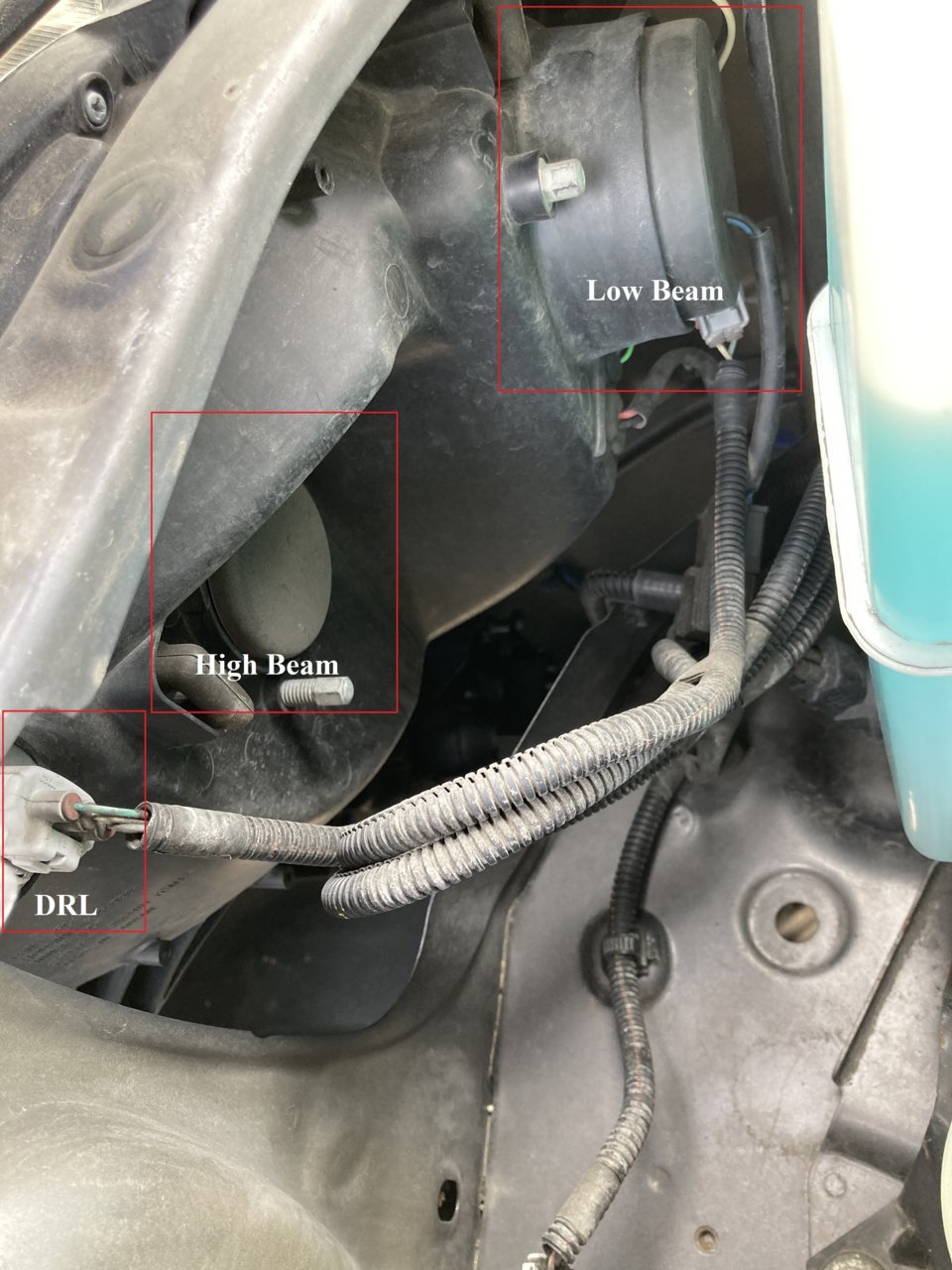

    Damnit, so I went to do this mod now that i have my HeadlightService harness and my OSRAM bulbs. I think my aftermarket headlights won't work with this setup. My low beam and high beam are two different bulbs so hopefully you guys can help me out. Here are some pictures of my headlights from the front and back marked with where everything is:
    and here are the bulbs I bought:
    So I think because these headlights have separate low beam and high beam bulbs this won't work because the new harness has just a single connection per side. When i bought the aftermarket headlights I didn't have to change any of the wiring and I honestly don't think i had to buy multiple sets of bulbs either (low beam specific and high beam specific... but maybe i did. This was years ago). I still have my OEM headlights so i guess i could always revert back to them. I actually really like these headlights and they have great cutoff and all that so if possible i'd like to keep them on. Any thoughts on how to proceed?

    Yes, you're SOL with those headlights. The Ultimate Headlight Upgrade is designed to work with a dual filament H4 bulb - which you have. Those dual filaments are for low and high beams. The aftermarket headlights that you have utilize separate low and high beams - which use different single filament bulbs. So the H4's are not going to fit either the high or low beam slots. And modifying the HD harness would be pointless because the headlight connectors are different and the number of connectors is wrong.
    The good news is that your OEM headlights - which you say you still have - will work perfectly with the new H4 bulbs and HD harness. I think you'll find that the OEM housings with the Ultimate Headlight Upgrade will totally blow away anything you can do with those aftermarket housings.

    Just put the original housings back in. That is what this mod is for and will give you the best possible light output.
