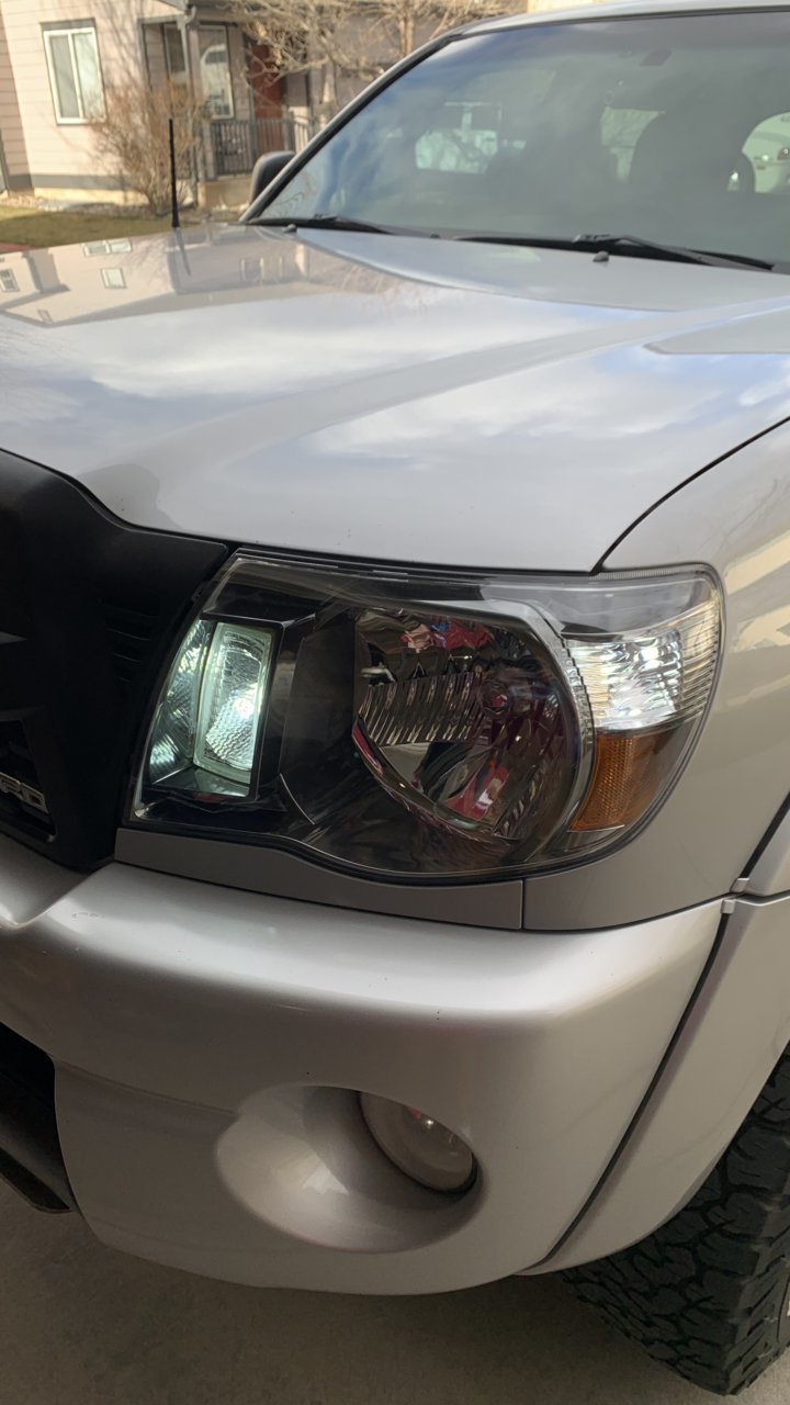

    Speaking of headlights, does anyone have any good recommendations on LED daytime running bulbs for the Tacoma that doesn't cause rapid flashing? The factory daytime running bulb's heat is damaging the headlight housing.

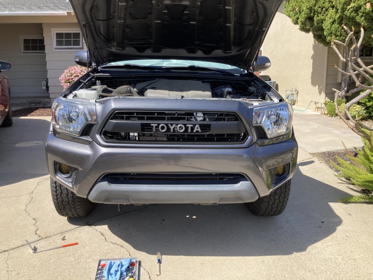

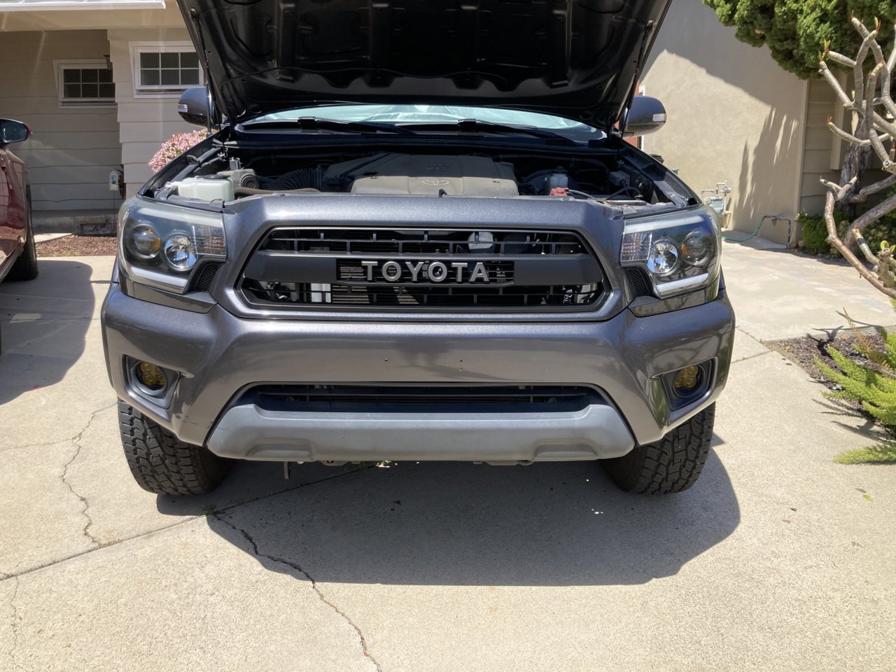

    Nope, stock SR 2014 Headlights... maybe they look like Pro's just cause of the lighting?
    Anyways, completed this mod this afternoon. Very time consuming with also having to swap out the headlights. Headlights are a bitch to get in and out, like a jigsaw puzzle piece! The wiring was fairly straight forward. I ran into a hiccup of when removing the positive battery terminal - my main aftermarket stereo power line just popped right out of its crimp terminal. Thankfully I had spare terminals and just crimped a new one on. So that added to the time. Otherwise... broke some clips holding my radiator cover on and a clip holding my inner fender lining on when getting that damn third bolt for the headlights. Went from:
    to:
    I hooked everything up and the lights work (low beam/high beam) so that's always a positive when i work on my truck, lol. Obviously won't be able to tell the difference until night but i'll take some pics tonight. My dumbass didn't take any before photos...

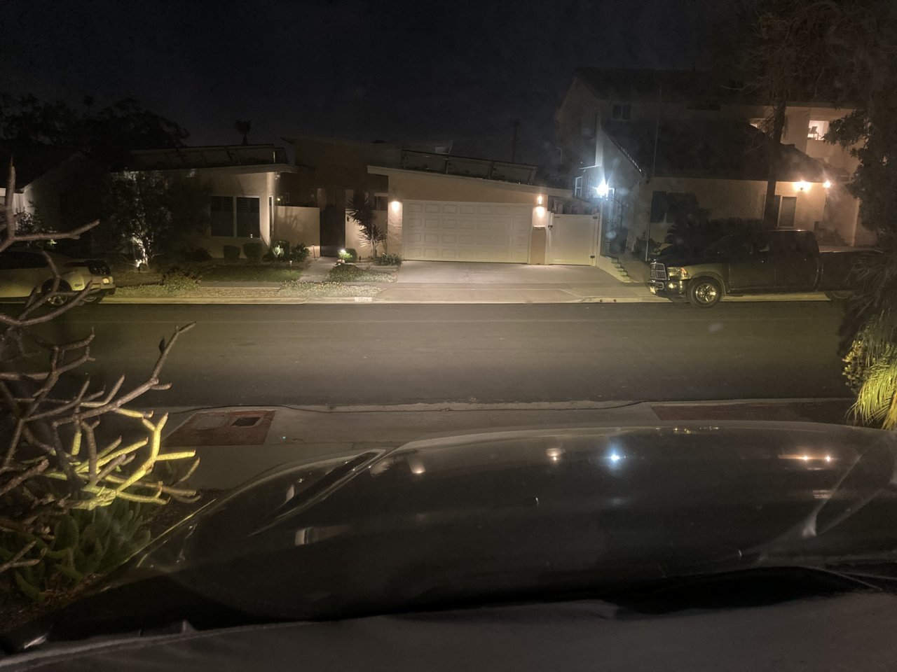

    Ok good to hear. That's what I figured. Here's the 'after' photo. Terrible photo with no context to the 'before' for all of you, but i can say for certainty they are WAY brighter than before. I'll have to take another one without a bunch of background light (house lights/street lights/etc). Very happy so far with the outcome!
    Just focus on the middle by the neighbors garage. You'll see more yellow light off to each side, those are my Diode Dynamics Sport fog lights light as well. But the light on their driveway is the new Headlight Upgrade light, which is muuuuuuch brighter than it was before.

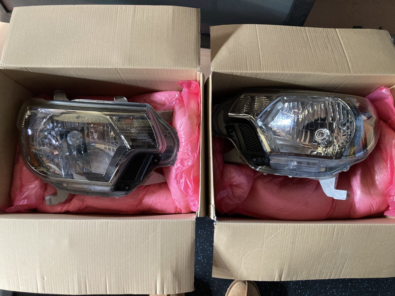

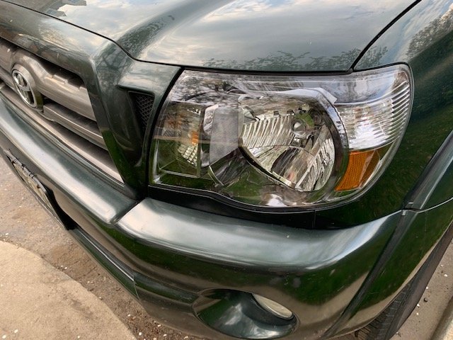

    I just did the upgrade in conjunction with installing new headlights (Eagle Eyes brand made in Taiwan... look to be good quality) to replace my cloudy ones. Got tired of using the restore kits. The upgrade using the Headlight Services harness was truly plug and play. You could make this harness up yourself but honestly for the cost it isn't worth it... and you still might not have as professional results. It's a nice heavy duty piece. I already had a terminal on my battery for a subwoofer amp so I had a ready made place to bolt on the + lead. I am using the 100/90W normal color temp Osrams and the pattern and brightness look good in daylight. These aren't going to be as bright as aftermarket LED aux lights or anything crazy like that, but you don't want that for street driving. Just make sure they are aimed properly. I'll get them out at night one of these days soon. I will probably keep my old headlights and do a full restore and clearcoat to have as spares.
    But LOL... every plastic push pin I had to remove to do the headlights disintegrated. I need to go online and get some new ones. It is all holding together but barely.
