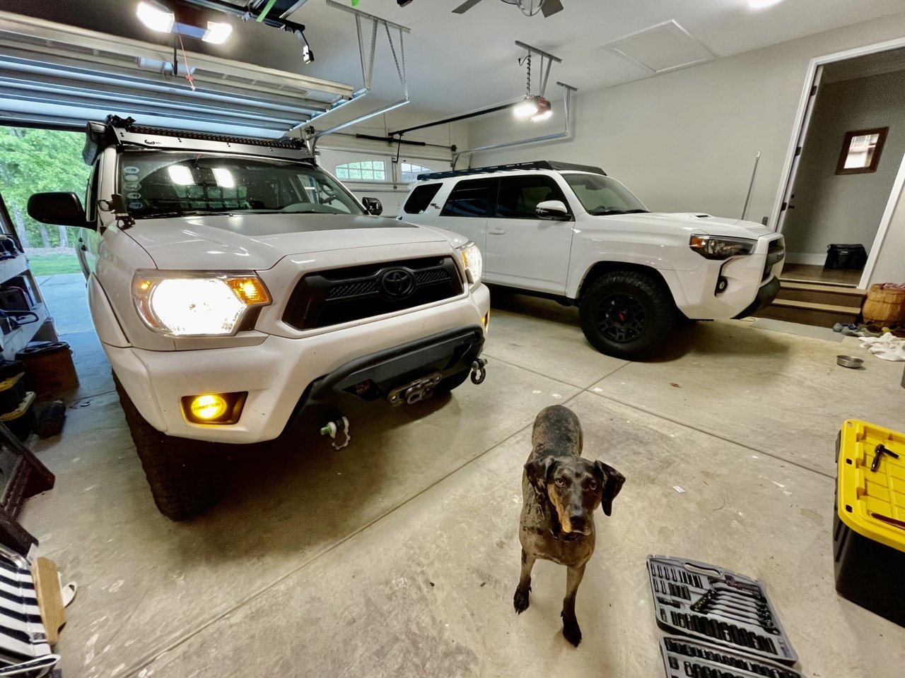

    Does anyone have a PDF of the Headlight Services install instructions? I just bought a second-hand set from a member and while it seems fairly plug-n-play I'd love to see actual instructions before I pop the hood.

  13. Apr 20, 2021 at 1:27 PM
    #3773
    Bannerman
    Bannerman Tasteful Thickness
    Oct 16, 2015
    #166789
    7,474
    Johnson
    Charlotte, NC
    22 Tremor 402A, 22 T4R ORP
    That's what I needed thanks. And the pupper isn't going to help at all. He just sits in the garage and silently judges my work.
