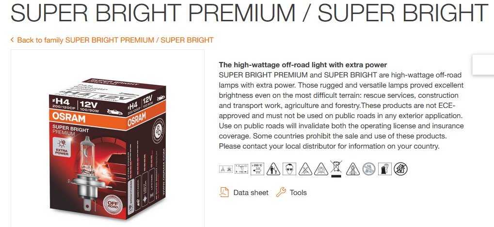

    Order these, they are the best

    Did you see the best stock wattage performance bulbs section in the thread? Or the output charts? Nightbreakers are good, but Philips Racing Vision is better, and the Tungsram/GE Xenons offer best low beam without reducing the high beam like Racing Vision and Night Breaker Laser.
    If you want brightest plug and play bulbs, those are the IPF Fatboy Superlows 60/80w bulbs, but they are stupid expensive. The best overall performers are the Osram SuperBrights 100/90w bulbs listed and shown at the very beginning of the thread, with huge increases in both low beam and high beam, but they require the use of a heavy duty harness.
    Copy/Paste from thread:
    Stock wattage performance bulbs
    Stock wattage high performance bulbs do not actually put out more light, instead they use smaller high precision filaments to make the light more focused and intense for the headlight to use more efficiently and project a brighter hotspot further. You can see an short article by Philips explaining how these bulbs work here.
    These are currently the highest performing stock wattage bulbs on the market:
    Which bulb is best? Depends on your needs. The +150/+200 bulbs are going to provide excellent low beam performance, but coat the high beam reducing performance. The Philips are rated at 200hrs. The GE +120s have a blue coating on the tip but leave both the low and high beam uncoated giving superior high beam performance with a slightly lower low beam performance over the other bulbs. You can compare lux performance over stock in the above charts.
