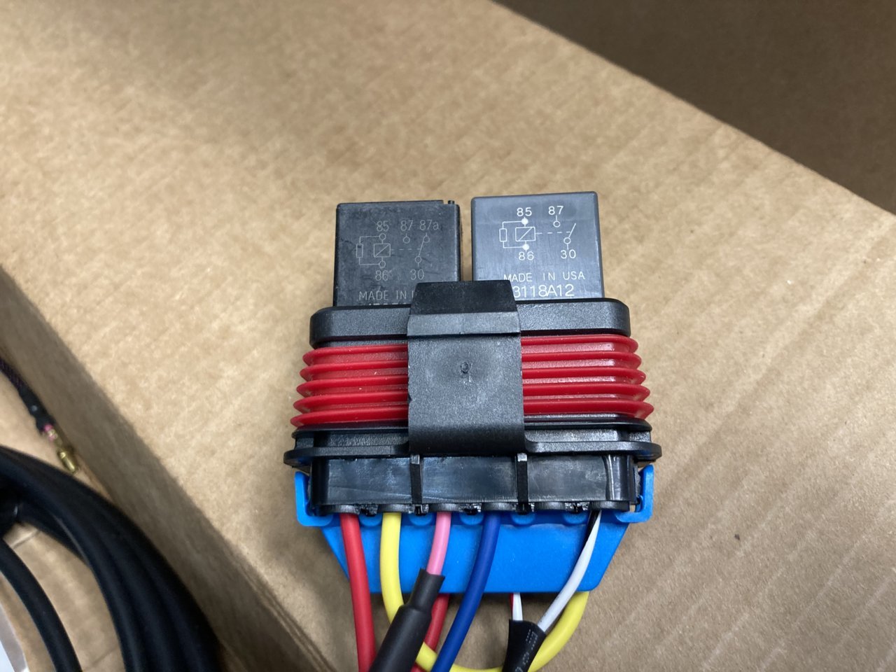

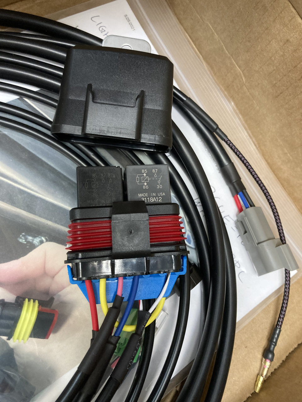

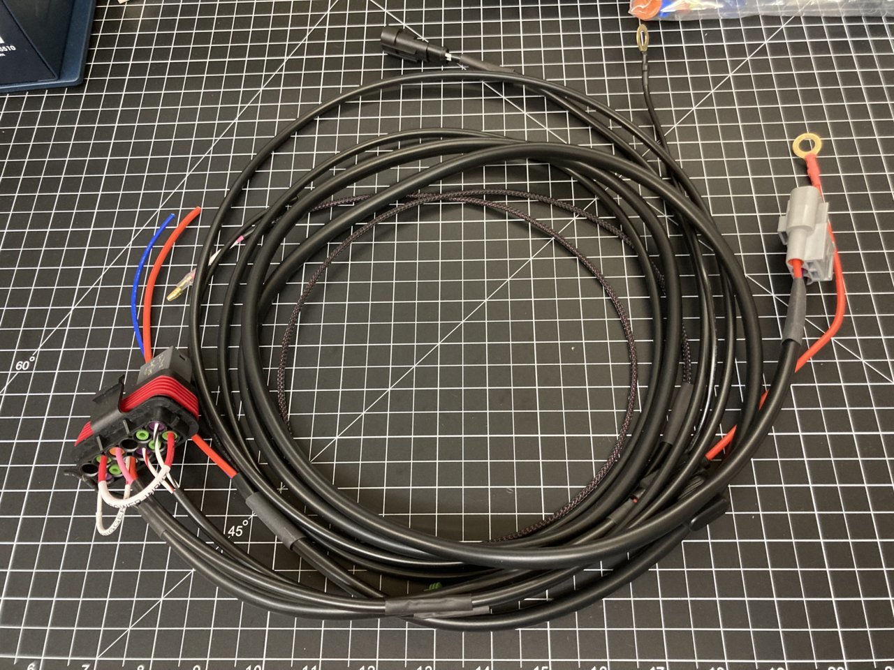

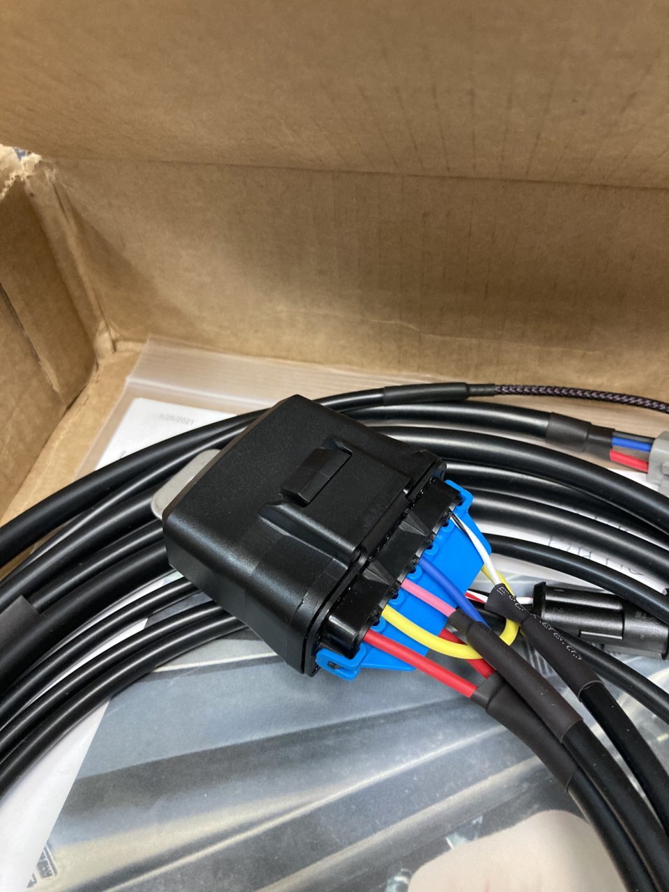

    My plan for the Tundra was to use a GEP and mini relays. I’d be game to try to build a harness for others if someone wants to spend. Parts wise it gets a bit expensive and I don’t have any intention of building a bunch of them or anything. The H4 connectors are a little annoying to source and then there is the whole fact that they aren’t sealed either. On top of that, GEP stuff is backordered and I just used up my last one for a light bar harness for someone.
    Photos of how a 12 position GEP looks with two Omron relays.
    DRL Light bar harness (same basic concept)
    Close up:
    6E5BE05B-9DBD-4FA4-A495-02EA976D9989.jpg5ECC16BD-BA1B-44DD-8759-A3B0E7B096A9.jpg 55C8FD11-F608-4260-B781-88B68939A550.jpg
