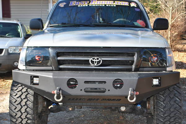

    Unfortunately I think the late 90s Tacomas had the worst headlights for output and upgrade options. The mid-90s sealed beams could swap in E-code H4 conversions which are an incredible improvement, and the early 2000s had improved the headlight design with a more modern composite lamp.

    I agree. I'd like to find a decent aftermarket lamp assembly.

    I've looked for a friend. There are some clear headlights available, but I am always weary of aftermarket headlight assemblies not having as good of optics as stock. It can be a crap shoot, unless they are CAPA which would be near identical to your OEM units and not really an upgrade. The best option would probably be a retrofit from TRS, but that is costly and I think the retrofits on the earlier 90s tacos look a little fugly.
