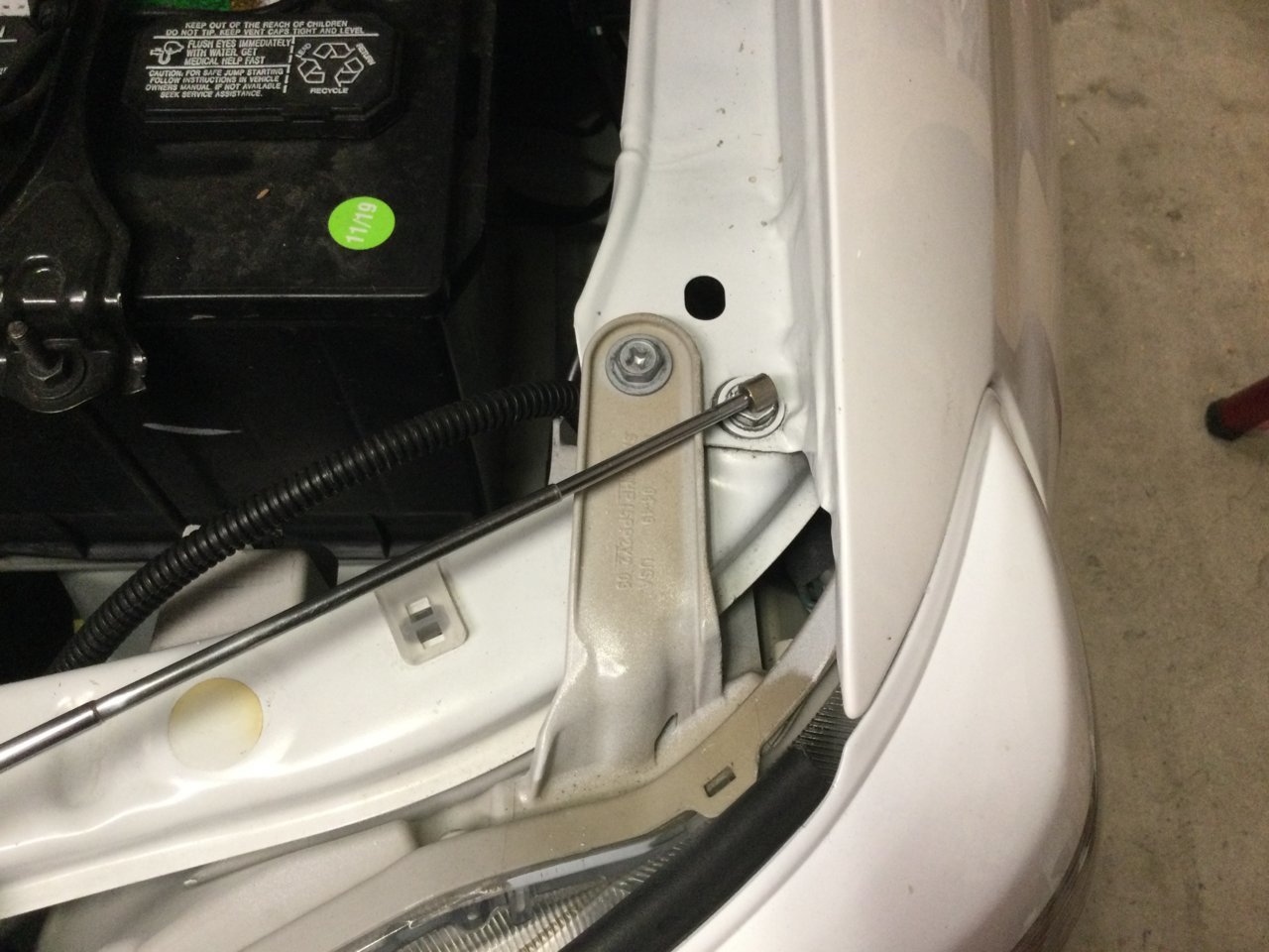

    There’s not many good grounds around the head lights, so ideally I’d just run a larger ground wire to the battery negative.

    Not true. I had Mike make me a harness with about 10” long grounds at each light. Then there’s a bolt with a 10mm head that attaches the front of the fender to the radiator support. Remove the bolt there’s no paint or primer between the two. Use a bit of dielectric grease and your set… Yes I painted the top of the headlights.
    Oh, I used the same grease on the relays because & I use it on every electrical connection.

    That's why I like using Volvo battery cables. The negative cable has a piggy back for the fender with 10 built it spade terminals.

    I just use the battery ground to the stock location with the special bolts Toyota uses. No issues ever from that method the ground bolts marked E have threads that do a damn good job cutting into the paint and making a good ground

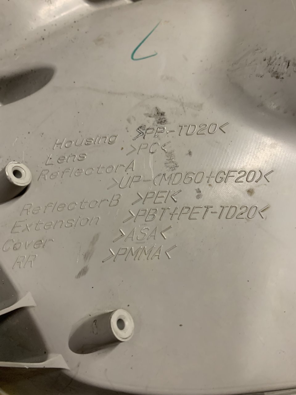

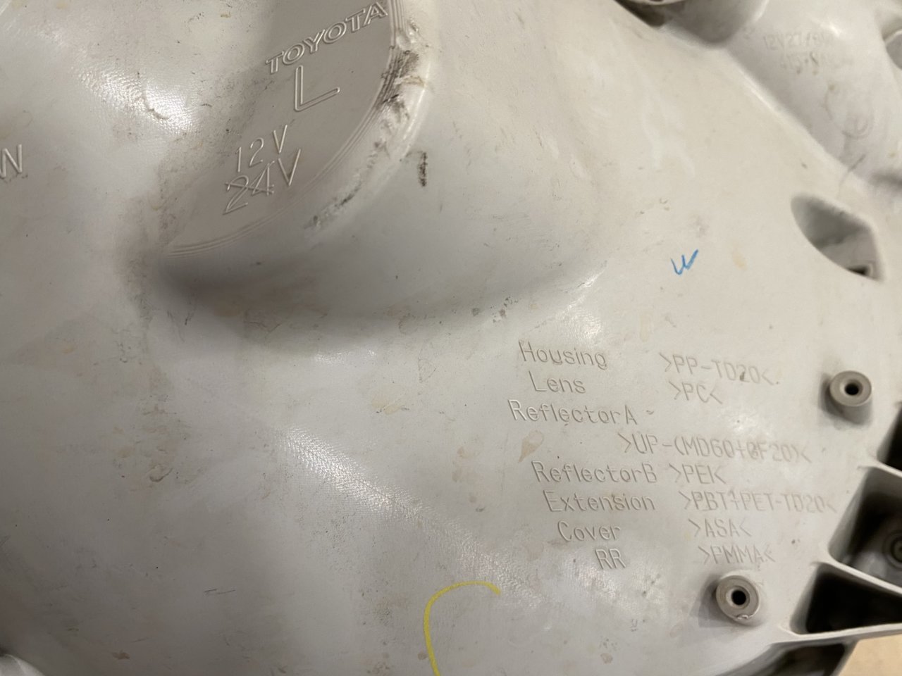

    Where is the factory Toyota part numbers located on the back of the headlights? I just bought a set of headlights for a good price because they’re in better shape than mine, but I’m curious if they’re factory or aftermarket.

    Lens should say Toyota or Depo or TYC etc.

    Note how just above those markings, near the bulb, an OEM assembly is stamped “Toyota”.
