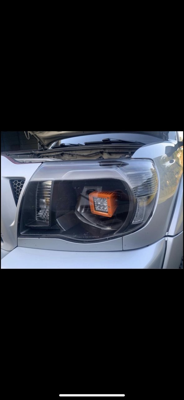

    Someone local selling these for $100, if only they were for ‘12-‘15 models :rofl:
